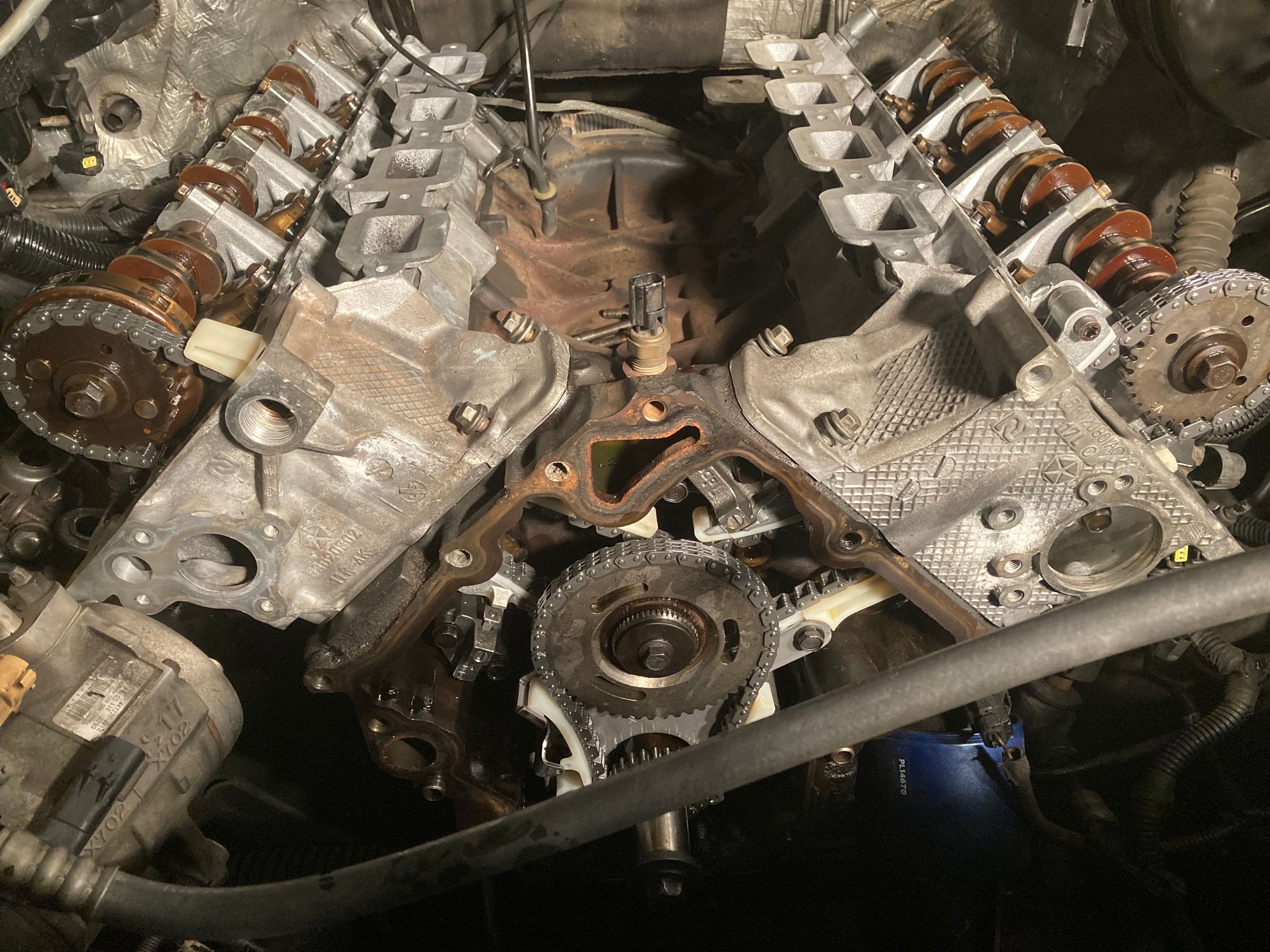

So what I ended up doing was loosen the cam bolt cap bearings and was then able to move the cam into position. Once I got the chain on the sprocket I torques down to 8 ft lbs. did the same on the other side. Here is a pic of rhe timing chain completed and heads torqued 20 ft lbs + 90 degrees + 90 degrees as the Manual states. Have timing cover gasket on order because I forgot to order but should be here Sunday. Should be able to start her Monday or Tuesday.

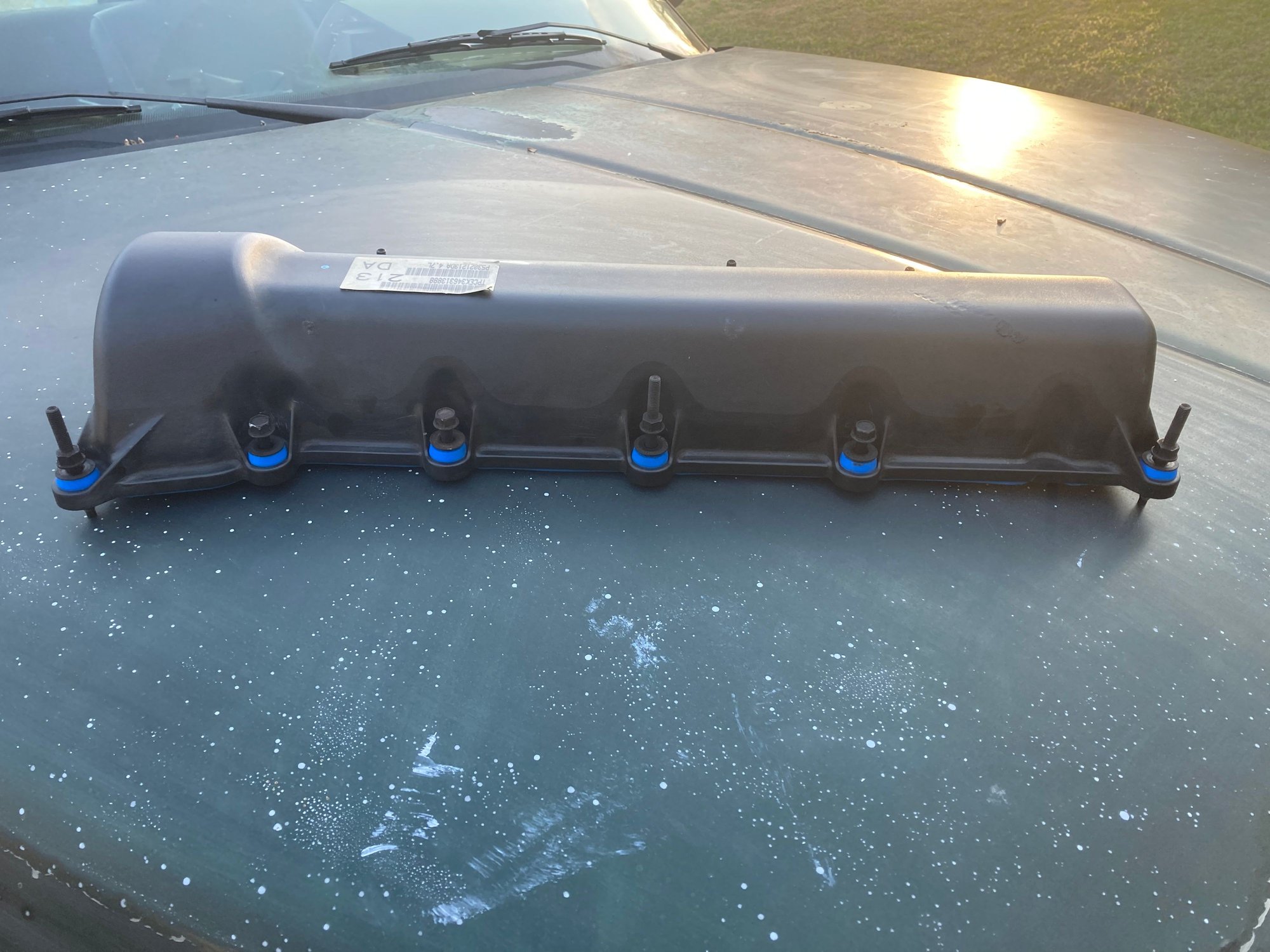

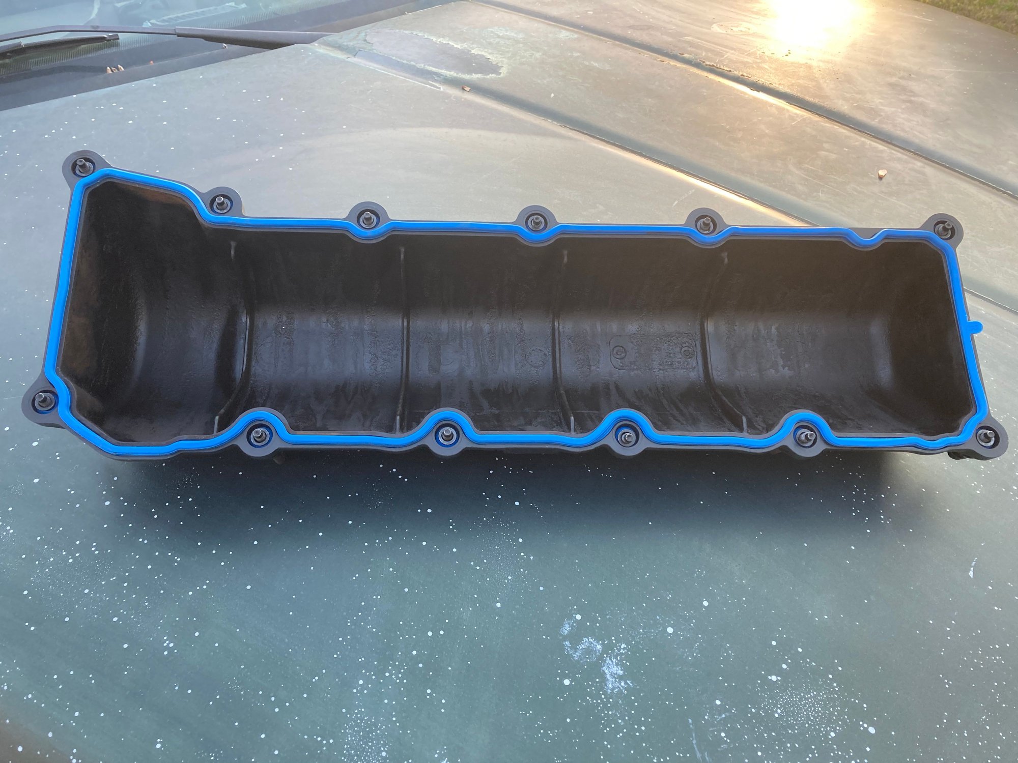

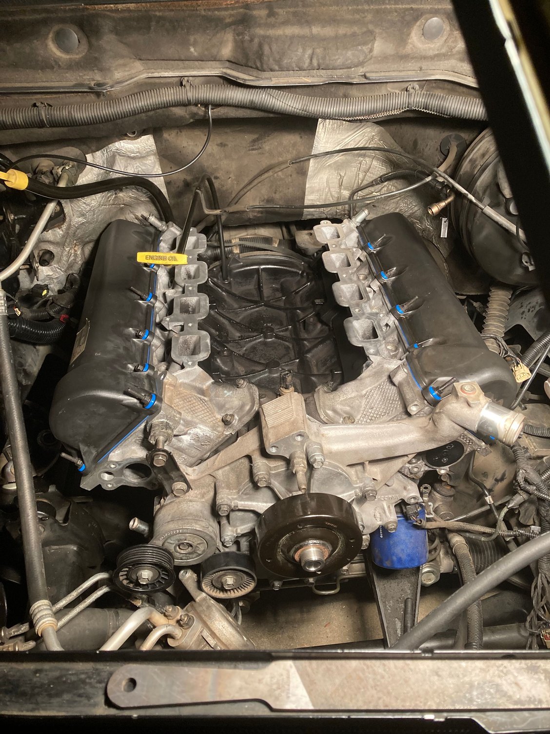

Had another good day yesterday assembling the motor. Got the timing cover on and torqued along with the valve covers and harmonic balancer. I am using Fel-Pro gaskets and they seem to be mopar blue. I know they aren’t but I just like the coloring accent. Here is a pic from last night.

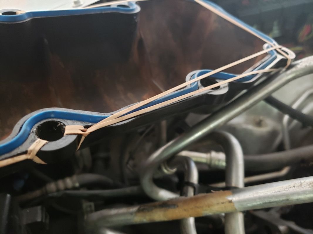

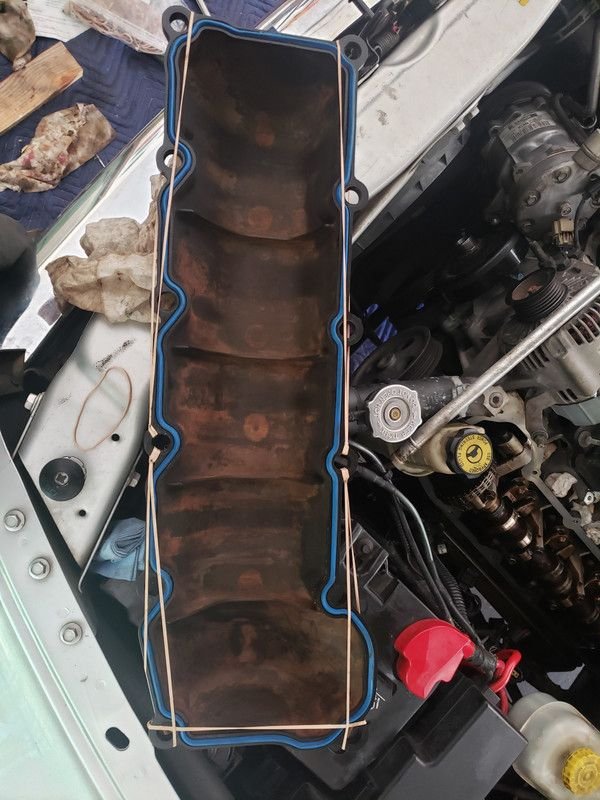

Nice. I used those too when I did my lifters and valve stem seals. I decided I didn't want to use any RTV or rubber cement to hold the gaskets into the cover, so they wouldn't fall out once I inverted them for install. So.... I came up with this rubber band method. Worked rather well. The rubber bands are easily removed once the cover is situated. I coated the gaskets and channels and surfaces with dielectric grease so everything would slide and smush nicely.

OK, Long day. Completed assembly and fired her up. She turned over 2-3 times and ignited...was the happiest sound I ever heard. I still need to put fan and fan shroud on. Currently just water in rad because I thought I had a gallon of anti-freeze but couldn't fine any. So tomorrow will be a trip to the store for a few small items. My only concern is that it sounds a little rough but no lights on the dash, almost like a small misfire. Not sure where to go with that. Possibly need to just run her for a while and I am pretty sure all vacuum lines are connected.....I'll get a video up soon..
