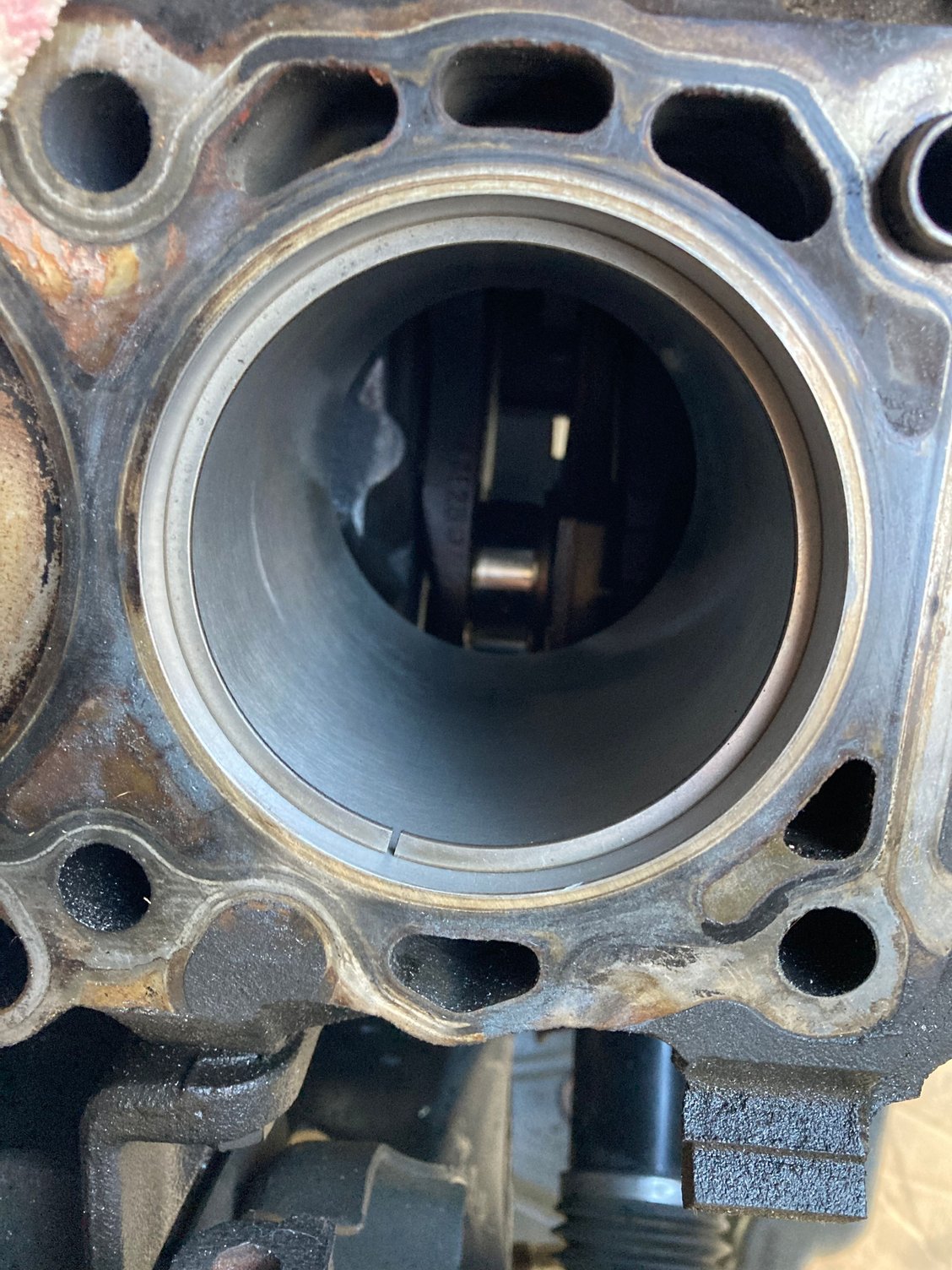

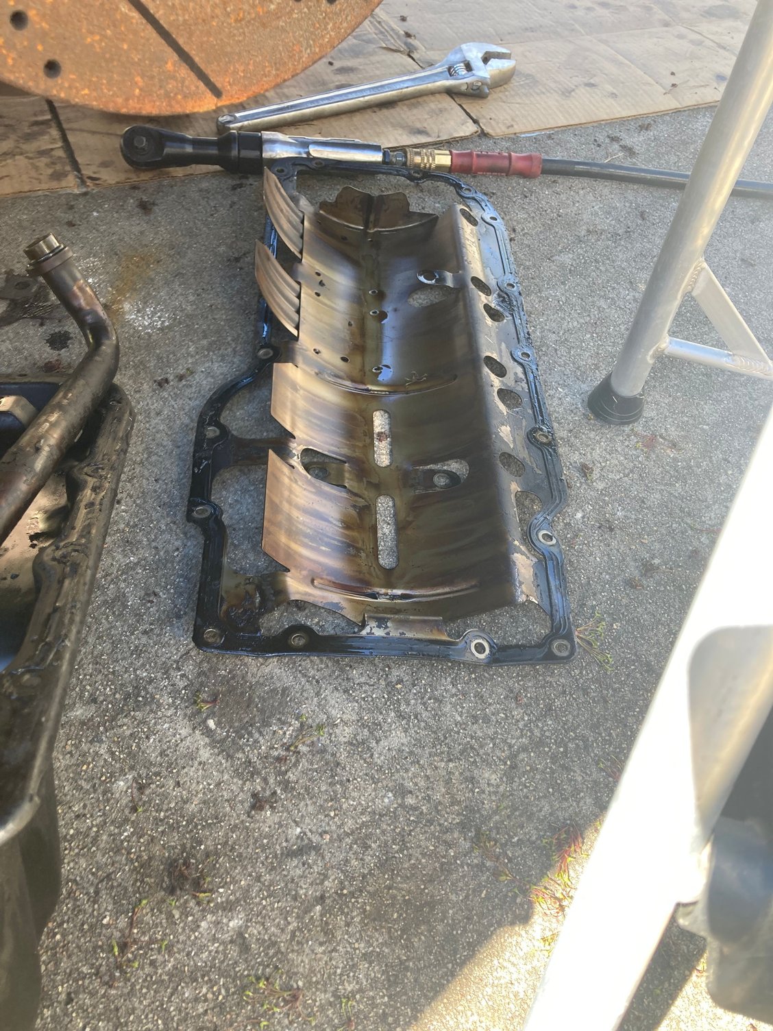

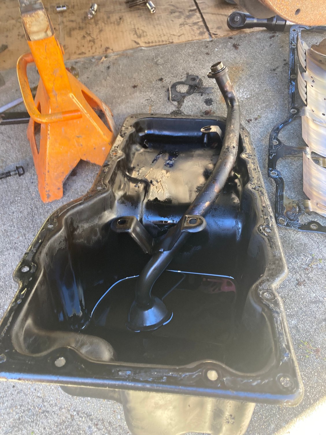

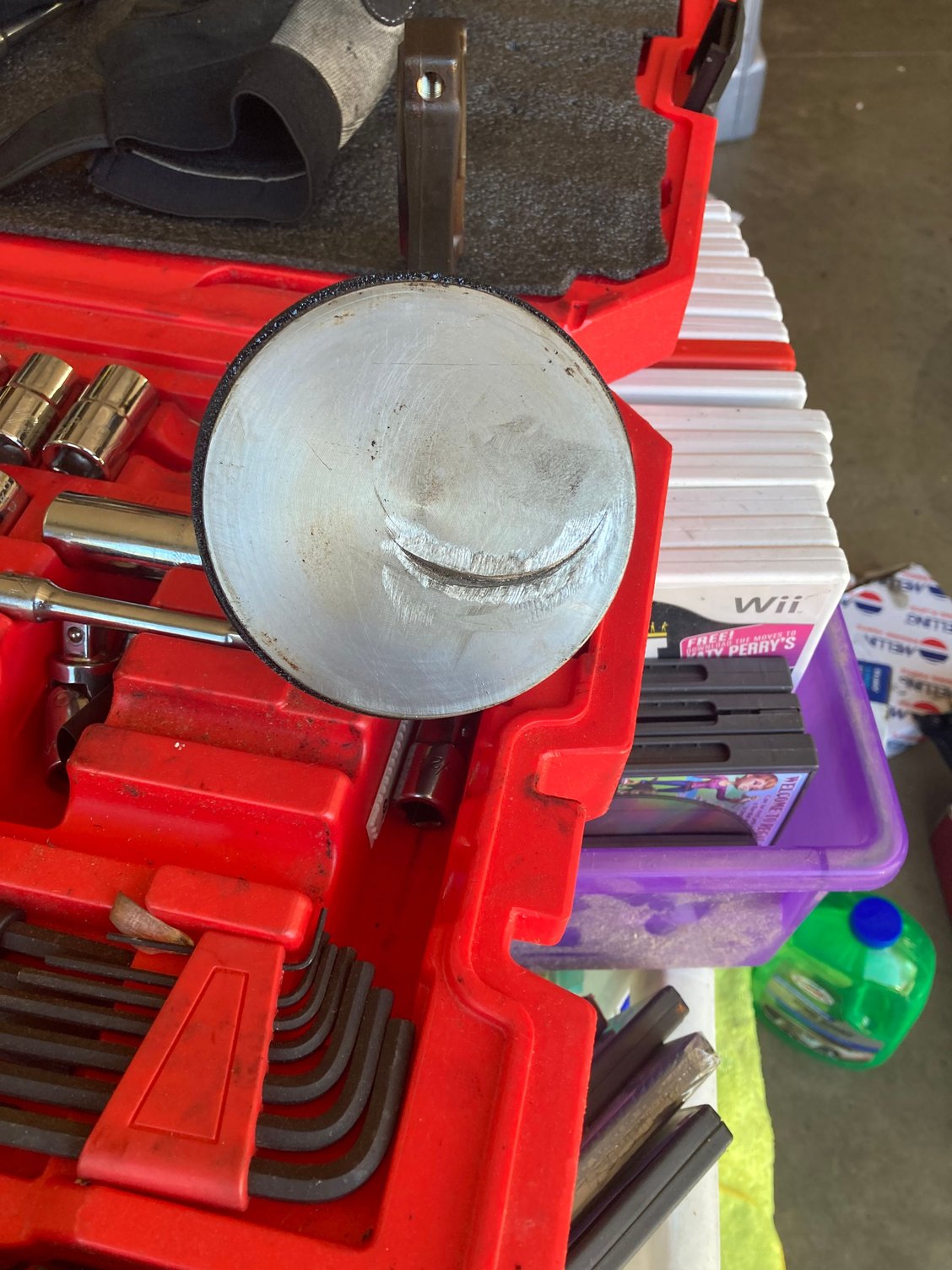

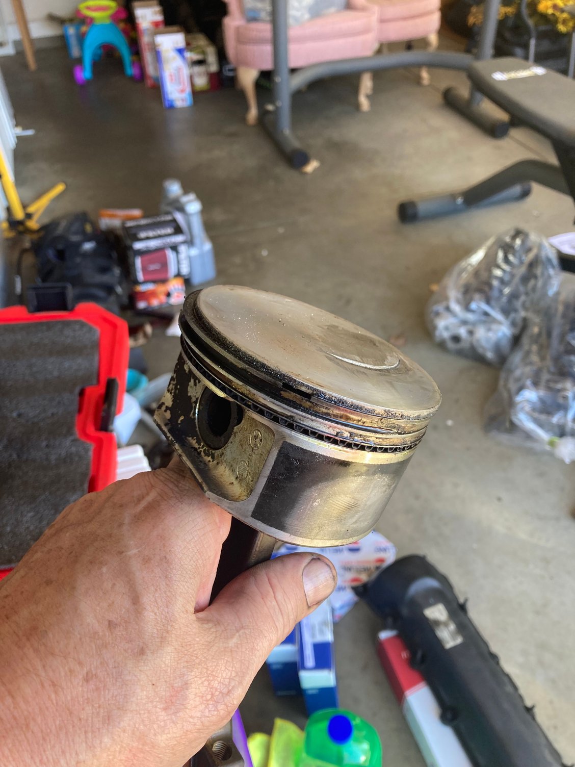

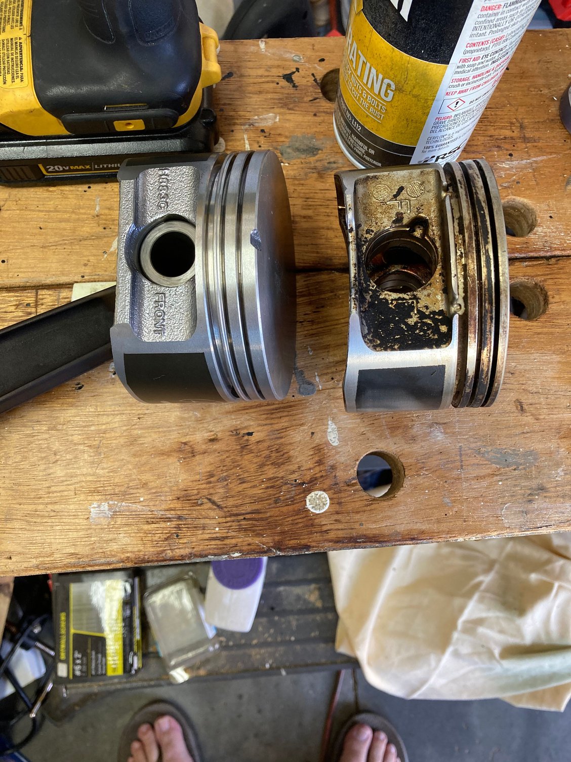

Hey everyone sorry for not posting in the last week had nothing to report. Got heads back. Complete valve job with #2 exhaust valve replaced. Cost came out to $1,100. So yesterday I pulled oil pan. “Never again” will I do this took almost an hour to get it off damn near 20 years of never coming off. Anyway pulled #2 position went to remove rings and the second ring snapped. So ordered a ring set then proceeded to home cylinder wall. Presses out old ring pin and seated new ring pin and piston to rod. Replaced oil pump. Here’s a few pics.
Better than new
Cleaned and honed
The devil
Newbie

If you still have the heads off, take the old ring (that is still in one piece) put it in the hole and measure the end gap - will give you an idea of how worn it is.
That old piston looks pretty nasty from the valve contact, good thing you're replacing it.
What did rod bearing/crank look like?
Did you pull the block out, or is it still in the bay? Also, is that a notch I see cut into the edge of the new piston?
Old Mar 6, 2023 | 05:27 PM
  #55
Posts: 87,480
The notch in the piston gets installed facing the front of the motor. The wrist pin bore is not precisely centered in the piston.
Yes sir, read that and also marked on piston!
Still in the bay, That is my only regret. I should have pulled and and did all 8. But if I get another 100,000 out of this fix I'll be happy
. Crank and rod bearing are very clean for 225,000 on her...
