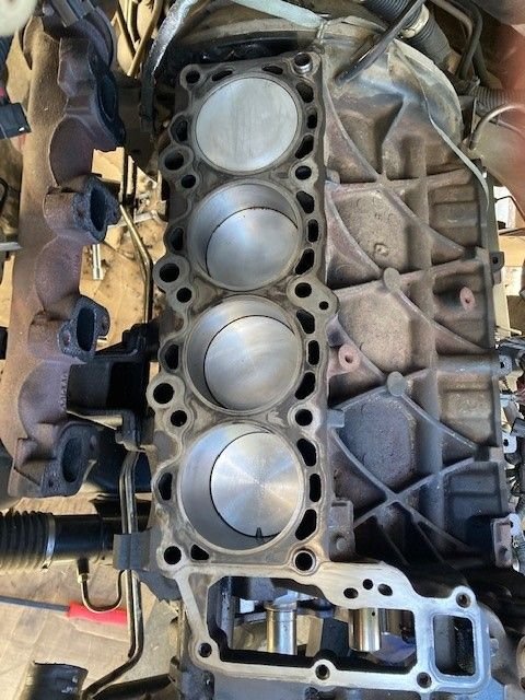

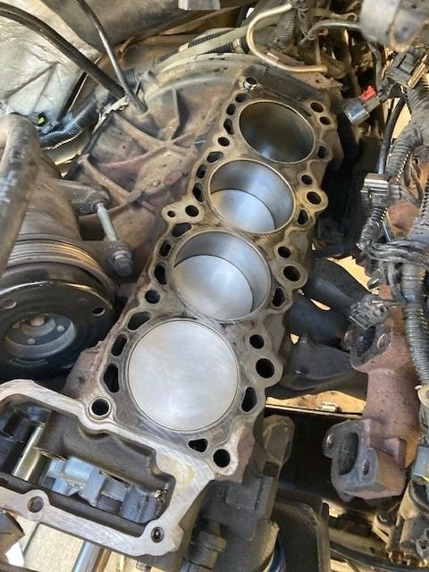

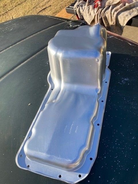

Ok, had a beautiful day yesterday to work on the truck. So, I proceeded to clean all mating surfaces with an acetone/transmission fluid mix and a scotchbright pad. Works wonders on piston tops as well. Broke down all carbon build up and they turned out great as you can see in the pics. I then went over the mating surfaces with a block and some 320 grit sandpaper to clean up any leftover debris. That got them a little cleaner and made sure they were smooth. Didn't get all coloring out but I am not too worried about that. They are flat / smooth and no anomalies. Proceeded to get underneath and clean up the block surface for the oil pan, torqued the rod bolts down to specs. attached the windage tray and oil pick-up after cleaning everything. Installed the oil pan torqued bolts to spec installed the dust cover and then the cross bar that had to be removed in order to drop the pan. Here are a couple pics of the progress.
cleaned and painted
new windage tray and oil pickup
cleaned and pistons
new piston in #2 and then cleaned remaining

Looks like progress !

Cleaned up rather nicely.
