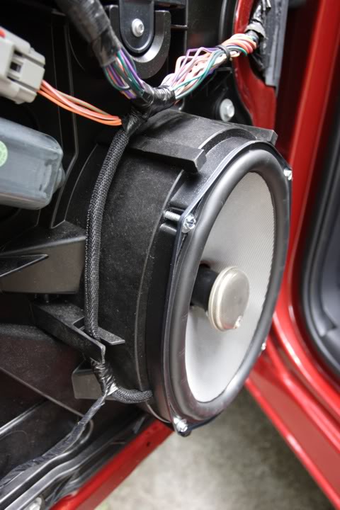

Hey plumcrazy, I’m pretty sure they will fit in the fronts. I almost bought these myself, but went with Infinity 6 x 9's. They fit with a protruding tweeter, and they are also spaced further out because I had to use a spacer ring and longer screws to clear the magnet, but everything fits with room to spare.
I think the polk db's would be an excellent choice. I strongly considered these myself, but I'm very happy with the Infinities. They hit harder and lower than the factory alpine drivers, and they have much more detail. I can hear Bass guitars “strum” instead of just sounding like muddled low end reverb.
The biggest improvement came with the 3.5’s in the dash. Way more detail and clarity. The problem with the Infinity 3.5’s is that they only fit into the lefts and rights, because they have a crossover dongle, and there is no room in the center speaker location for the dongle. If I had to do it all over again I would probably have went with the db’s because they have the crossover built into the speaker.
