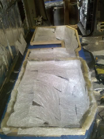

I got home and worked on more 'glassing. I did 3 thick layers on each side before I ran out of resin again. Hopefully its enough, cause i aint gonna spend another $75 on resin lol. Its gotta be close to 1/4" so we'll see.
When doing each layer, i cut all the fiberglass peices and laid them in place with as few gaps as possible, also trying to be careful not to overlap too much because the resin has trouble soaking through two layers of cloth at a time. Each layer got staggered, so there werent any horribly weak spots. This was the 3rd layer by the way.

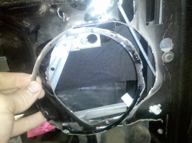

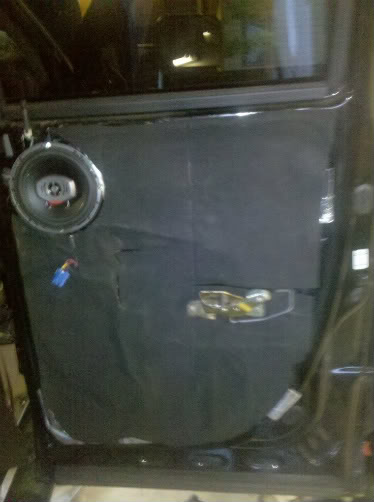

While that was all drying (in between layers) I got to work on the back door speaker install. I finished running the wires through the rubber boot in the door but in my haste, forgot to snap pics of it and now its all hidden. I'll make sure to take pics of the front ones while they're still apart. For the speaker itself, i had to cut the opening bigger. Just used a dremel with a metal cutting disk (took 3 disks per door). Good thing I got a pack of 20 of em for about $5.
Here is the speaker installed. Notice no wires showing, so it looks completely stock.

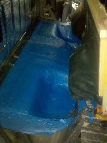

Finally, after all the resin had dried, I pulled out the box. It came out WAY cleaner than i expected. i had just a little bit of resin left over and I noticed it hadnt soaked through the fleece all the way in a few small areas (total of about 20% of it wasnt all the way soaked) so I mixed up the last of the resin and coated the backside for additional strength.

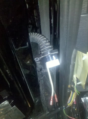

well folks, im in the home stretch. Today I finished wiring the front speakers. I couldnt get the pins inside the clip for the old wires out, so i just ran the wire through the rubber boot and between the two connectors. I also added quick connects there so the door can still come off if ever needed.
