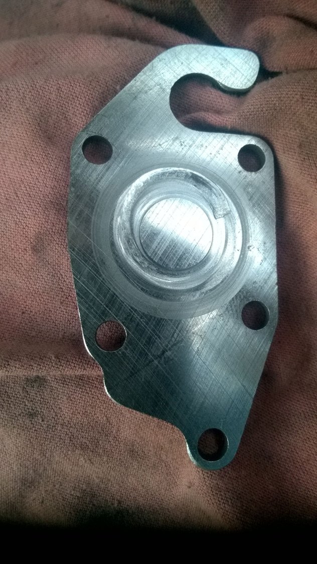

i had a chance to do a little more, found that the 3-4 accumulator valve was broken and was inside its self. and the end plate where the spring is aginst has a big groove wore in the plate, with that spring broke what would that have done, and do i need to replace that end plate? also do i have to remove the valve body to install the new lock up spring and boost valve spring retainer?

Can you post pics?

in my kit i have a lock up retainer and a upgraded boost valve spring, do theses really need to be changed? i really dont want to remove the valve body to do it....thanks for any help

I'd be real tempted to replace that plate......
If those parts aren't bad, don't change 'em.

I seem to remember reading somewhere that there was a spring on one of the accumulator pistons that liked to break, but, it wasn't absolutely necessary, and at one point, dodge simply didn't install it....... Or something to that effect. maybe in Monte C's thread???
