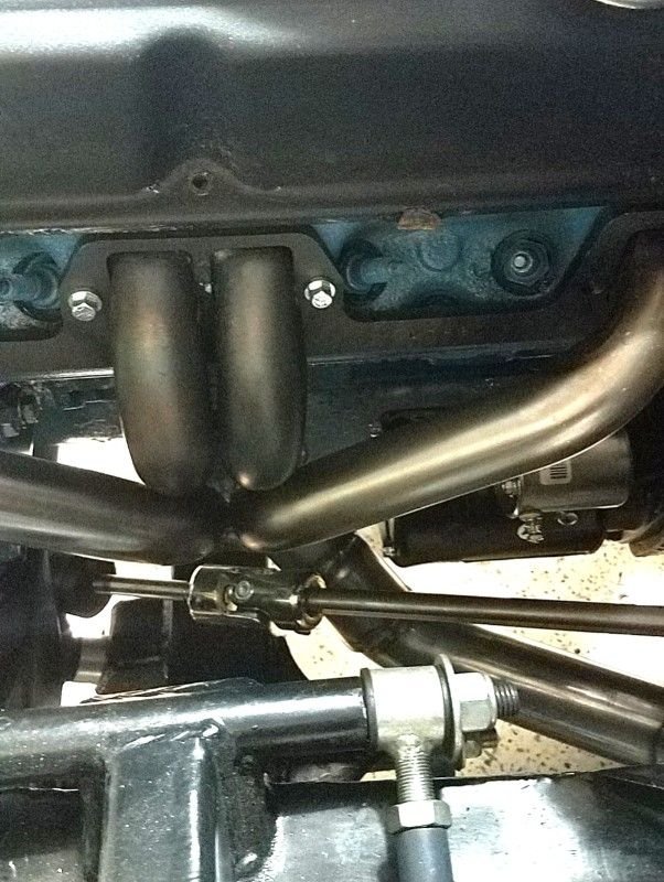

Ive been doing a few things here and there. Hours are still down at work, so money is tight for now. Im still trying to make my goal of moving the truck under its own power this year. I did manage to get the exhaust started. Im still struggling with some of the other details. I need fittings for the clutch, brake and fuel systems. I also found out I need a clutch fork return spring. The parts truck had the wrong one, and as you can imagine, finding a clutch fork return spring for a 67 dodge is a challenge.
Anyway, I started the exhaust, I like the tuck I was able to achieve with the 2-1/2" exhaust pipe. I think it looks good. Dont make fun of my welds too bad. Im still learning. I will wrap the pipes that go from the headers to the underside of the cab to keep the heat away from the oil lines and the starter. Im also adding an H-pipe, and 40 series flowmasters soon.
Passenger side header shot. Ignore the brake line, Im not done yet.
Driver side shot. Its tight with the starter and the steering in place. I know it looks like a bad transition on the exhaust, but its not. Thats a slip fit junction that Im welding up.

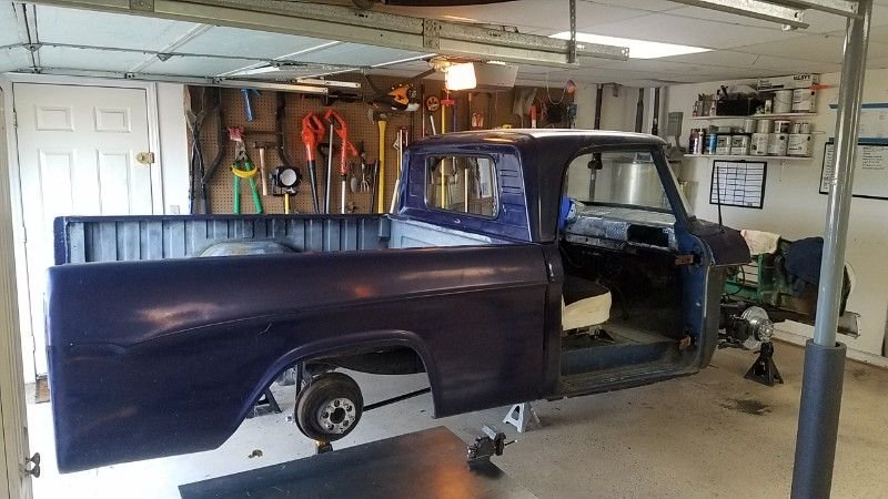

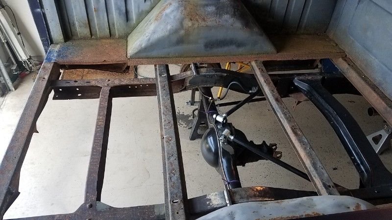

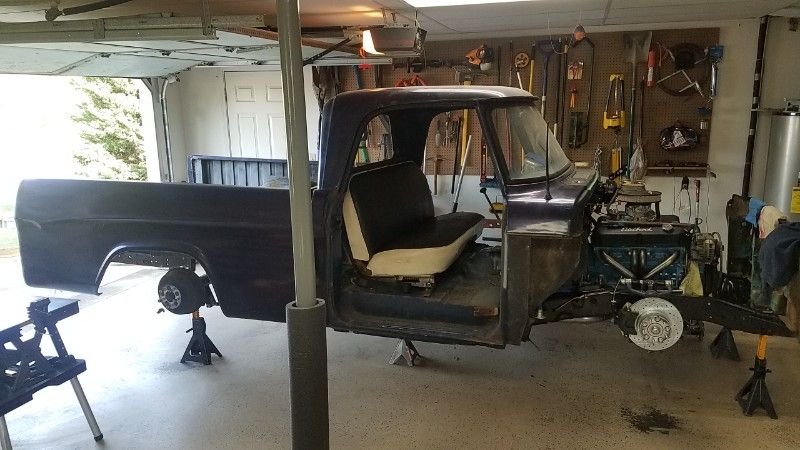

So I have tried to stay busy on the truck. I got the seat in, the back window in, and the dash and steering column are in temporarily. Im checking a few things out. I had to clean the garage, because it was getting crazy, but then we set the bed on for the time being. I havent been able to check the rear 4-link for clearance yet. And it is into the bed area, at least the shock mounts are. I have considered raising the bed floor anyway, because the original is just gone. If I raise it 2" I could get into the clean metal, and make clearance for the suspension also. I still need to look into it more. The bed has me worried. It has some serious issues. Here are a few pictures showing how it looks today.

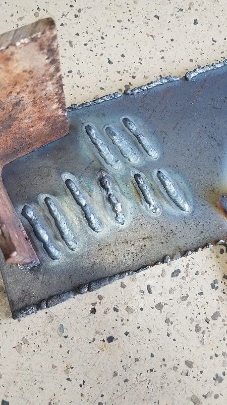

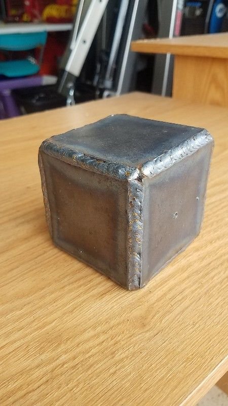

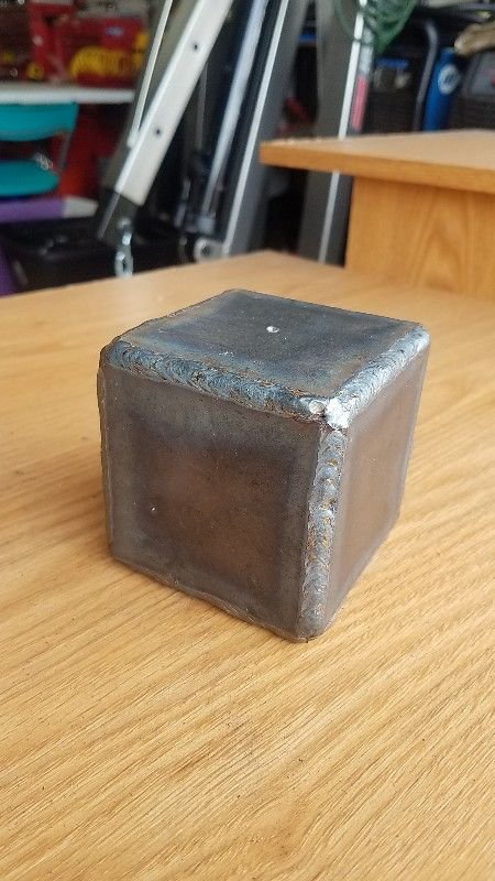

Im waiting on parts, so I decided to practice my welding today. Ill be finishing the welding on the 4-link and the rear end of the frame with the MIG welder. Unfortunately Stephen, who did an outstanding job on the front of the frame, wont be able to help with the rest.
I ran across some welding videos, and they show people doing cubes, and I thought it was a good idea, so I made one myself. I think I did good, but still need work, so Ill keep practicing. I also tried the TIG, but its a little less user friendly for me. I was able to get a bead or two that might be okay, but for the most part, they were all bad. Ill keep practicing with both.
Tell me how Im doing. Just remember, Im not a welder, so dont bash me. Im learning.
A few bad spots. Not bad overall. I was not trying to close the ends until later. This is MIG
I got better as I went. This is also MIG.
TIG. Just ugly. Dont even ask about the backside of the angle.

You've done better than I can do.The closest thing I have to a phobia is electricity. I got hit with 220 once when it shorted through me and ever since, if something sparks, don't be standing between me and the door. I can braze just fine. I learned as a kid and do it from time to time just to keep in practice. I've developed a tremor in the last few years so even if I wasn't skittish around sparks, it wouldn't be pretty.
