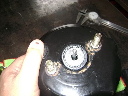

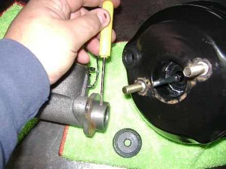

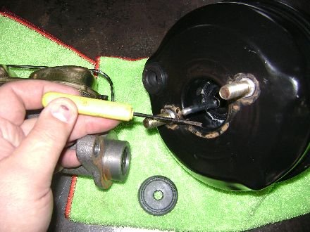

So I dug into the brakes today, and figured out the issue. I have been a victim of getting what I paid for. Time and time again I learn the hard lesson of buying cheap parts from vendors who dont care about you, your project or your safety.
So, the master cylinder has a casting number of 227161, making it a 1" bore MC for a 64-73 mustang, and it says it is good for disc/drum setups. The booster is a mystery. I bought these as a set from Pirate Jack, specifically for a 67 dodge d100, allegedly. Remember the rod that goes between them was too short, and never would have worked. I had removed the MC and the booster from the truck, and had them on the table. I noticed there was no gasket between them, and the mounting flange had surface rust on it, meaning it was not sealed. As I was reading up on it, a person asked if there was a gasket between the MC and the booster, and I found a that post said "No, the MC is sealed and the booster is sealed, if either of them leaks replace them." Then it dawned on me, the booster is under vacuum, and the MC is under pressure, they have to be separated from each other. That seems simple, but if the seal on the booster wasnt holding its vacuum, then the vacuum would come right out. Also there is a chance, if its sealed there, that the vacuum could draw fluid through the back of the MC, and ruin the booster, which I have had happen on a car before.
So, I flipped the booster over, and pushed on the brake pedal rod, and the seal just pushed out. Its made to be held in place by the MC. but I noticed there is a depth difference between them that wont alow that to happen. The flange on the MC is 9/16" deep, but the booster has a hole depth of 31/32" without the gasket. If my basic math hasnt left me, thats a difference of 13/32". So, I stacked a few large o-rings and a grommet in between them and put it all back together for a test, and it worked. I know this is not a permanent fix, but its working pretty good. Ill have to make a spacer to hold the gasket in place, or buy another booster.
I cant count how many times buying a cheap part has cost me more than I paid for it. Im going to just start ignoring the first 3 pages of a google search, and maybe the Pirate Jacks and the Uncle Jimmys wont be on the 4th page, and I can start to get some good parts. You expect it from Rock Auto, but now everyone is selling cheap garbage.
No seal between them. And there isnt supposed to be one.
Booster hole is 31/32" deep without the gasket.
Master cylinder flange is 9/32" tall. Thats a difference of 13/32". It would have never worked.
The gasket pushes right out if it isnt held in place with the MC.
