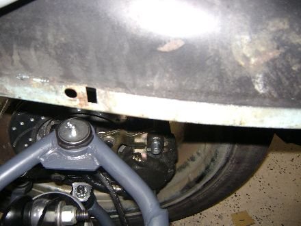

Success, Finally!

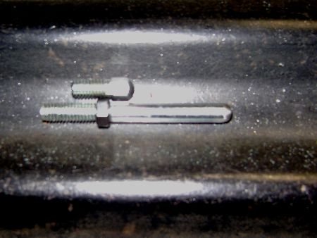

After looking and searching and scratching our heads, I got a call from Preston, the friend who helped me look at the brakes. The truck seemed to not have front brakes at all, and using the line lock proved that, but we didnt know why. He asked me a very simple question; are the bleeders on the front calipers on top, or on bottom? This seems pretty easy, and I admit I cant believe I missed it. Im chalking it up to being in a rush, and Ive never done anything this in-depth on a car. Simple rookie mistake, but Ill take it. I remade the rod that goes between the booster and the master cylinder, and tightened all the lines again. After swapping the calipers, my daughter helped me bleed the brakes and now they work.
Still have a ton of work to do, but she runs good enough I can start venturing out into traffic and getting used to it. Ill get a plate next week and might even drive it to work one day. Woohoo.
The rod it came with and the one I made. The size difference is crazy. That would have never worked.
Bleeders are now on top. It sure makes bleeding the brakes easier.
I got a reputation as a genius mechanic by remembering that. It's really easy to swap the calipers from side to side. I've also seen sloppy parts people give two calipers for the same side instead of one each. That's why I compare new and old calipers when I replace them.
You now know the secret.
