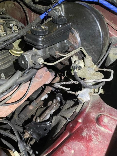

Lotsa good points, Ralph. I will look at all those individually. Thanks! I think generally speaking, HY is probably right. I have a 2wd and I'm thinking by and large that body and core support are pretty much free of nearly all constraints (considering I'm lifting only a few inches). I didn't think of the steering column ---> pinion. Glad you raised that consideration, Ralph. I've been wanting to change the R&P bushings anyway. Might be the right time to do both jobs at the same time. I know I have slack in the heater hoses. They should be OK.
The brake booster still concerns me. It threads through the firewall. The master is connected to the booster. The proportioning valve and RWAL is attached too with brake lines that spider out all over the place. That means I will be lifting brake lines. Not certain if there is enough play in those brake lines. Some have coils or large radius bends in them but I'm not sure about all of them. I will have to look again. I know I replaced one brake line from the front-left brake hose to the front distribution block (I don't know what they're called, sorry) that has no play in it and I think that line cuts across the fender (or close to it). I'll have to really look at that one.
Here's a pic...

All you need to worry about are the lines going down; the ones from the master cylinder to the ABS control and the proportioning valve? Are all fixed relative to the firewall; they lift when you lift the cab.
Unless you really crank it up, I don't think you'll have a problem with them; but again, I'd pump a bit up, check, pump a bit up, check. Lather rinse repeat until you're high enough.
Won't be anything on the passenger side as far as I know. The only exception will be the possible tightness on the EVAP lines; I don't know where your EVAP canister is. (Mine is on the core support; the hose I'm talking about is long enough).
There may also be a problem if your air side for the pollution solenoids is in the fender; I've moved mine to there, but there's enough rubber hose to let it move enough.
Can't think of much if anything else.
DO check with Eyeball Mk I ; just because I didn't think of it, doesn't mean there isn't something.
