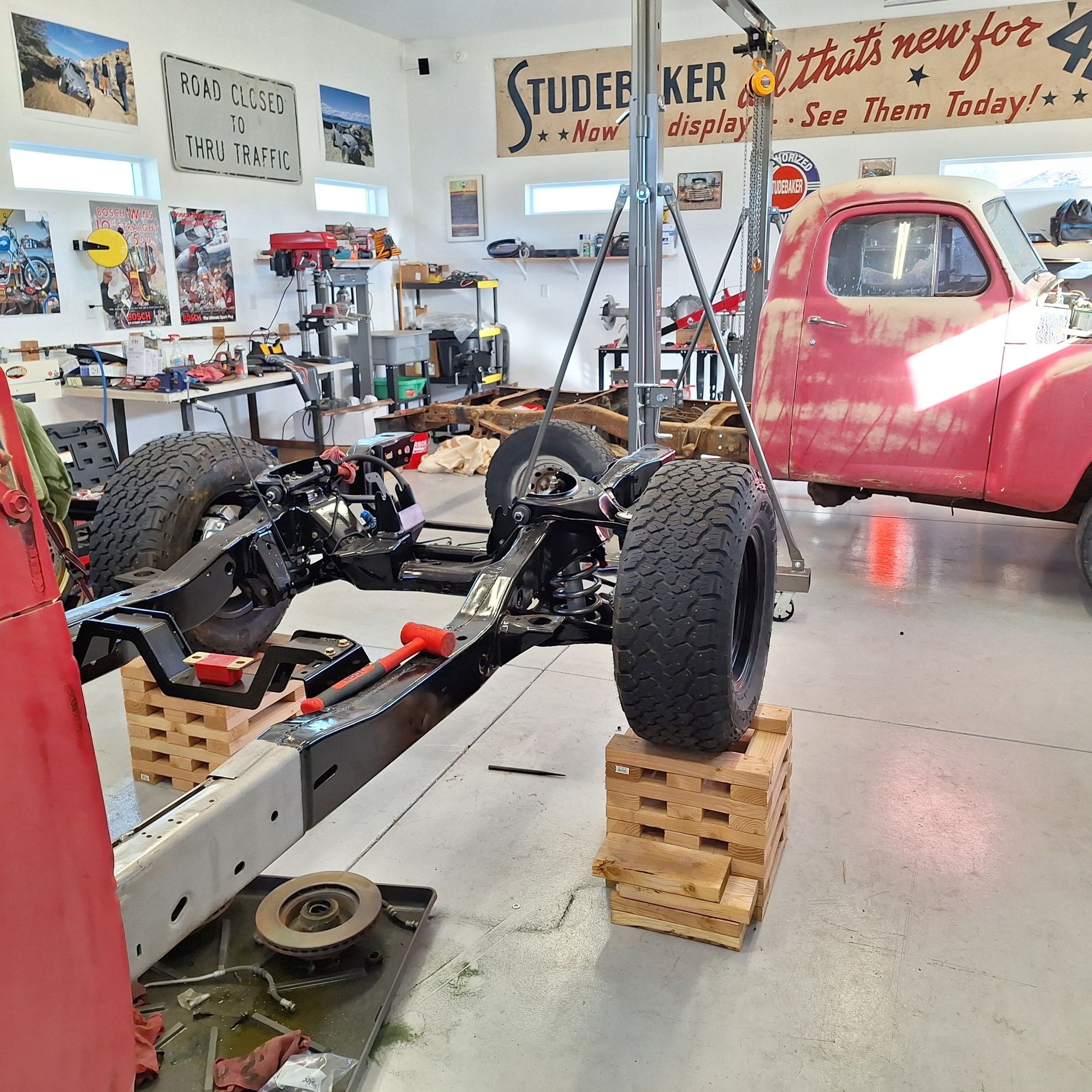

If it's cold outside, bring them in where it's warm! I brought the truck into the shop so I could continue to remove the body without laying in gravel, and without getting cold! As the temps begin their decline into December, it's better to roll around on a creeper. I also removed the engine and trans (again!) in preparation of getting the cab placed on the Dakota chassis for the first time. Since the trans tunnel in the Stude cab won't clear the giant 6L80E, it had to come out. Once the fenders and core support are off, the gantry crane will lift the cab off and I will just roll the old chassis back into the yard.

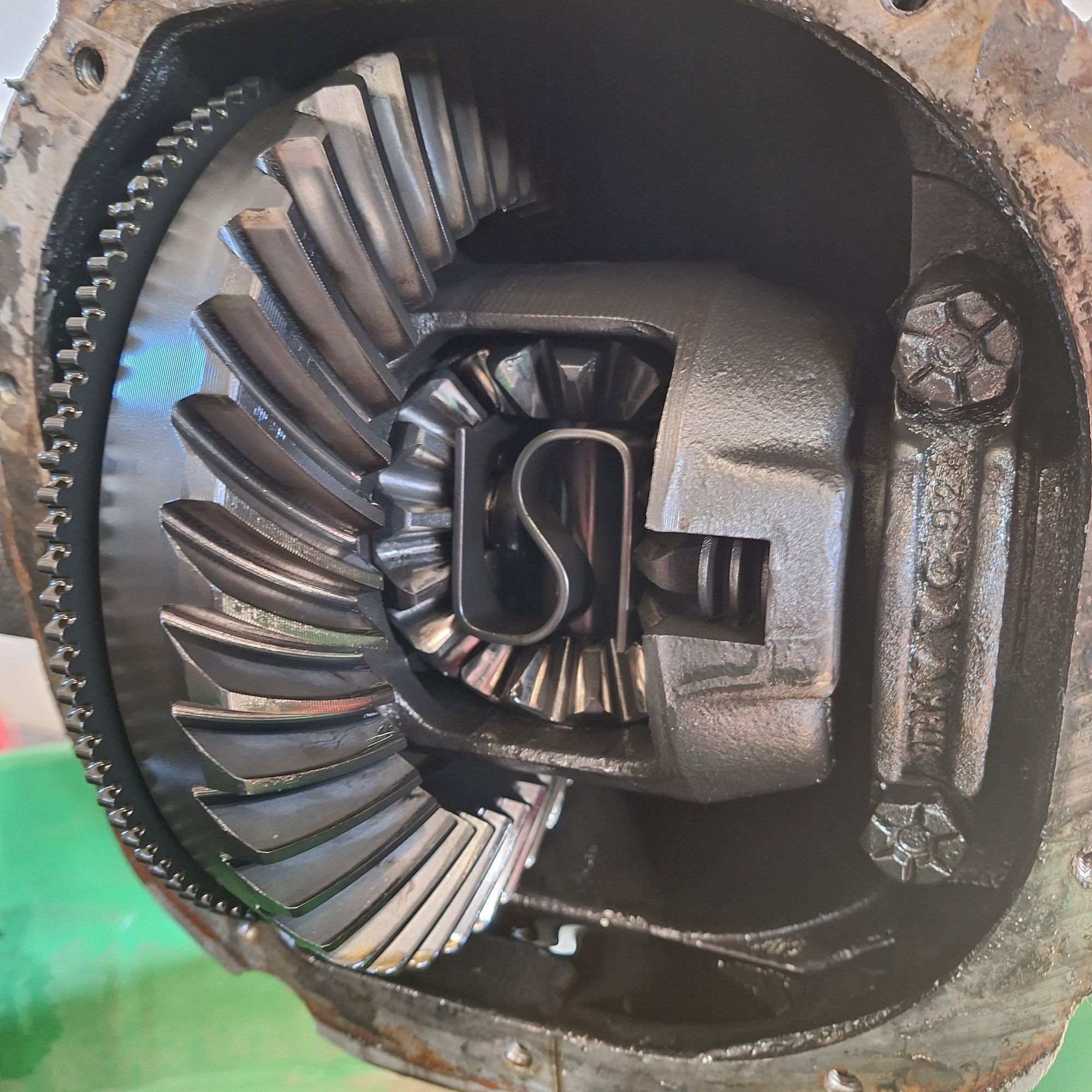

I cracked open the pumpkin to check out the internals. No visible signs of wear on the gear faces. Nothing in the oil. I am happy!
Old Dec 12, 2025 | 08:44 PM
  #584
Posts: 87,483
Is that after cleaning? If that's before.... WOW.... is all I can say.

I took the cover off, and let the oil drain for 24 hours. That's it. Like I said, I am happy. New seals and outer axle bearings, rebuild all the brake components, and run like the wind.

It was a drop of gear oil...
