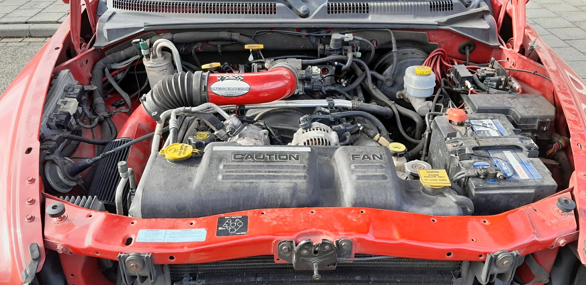

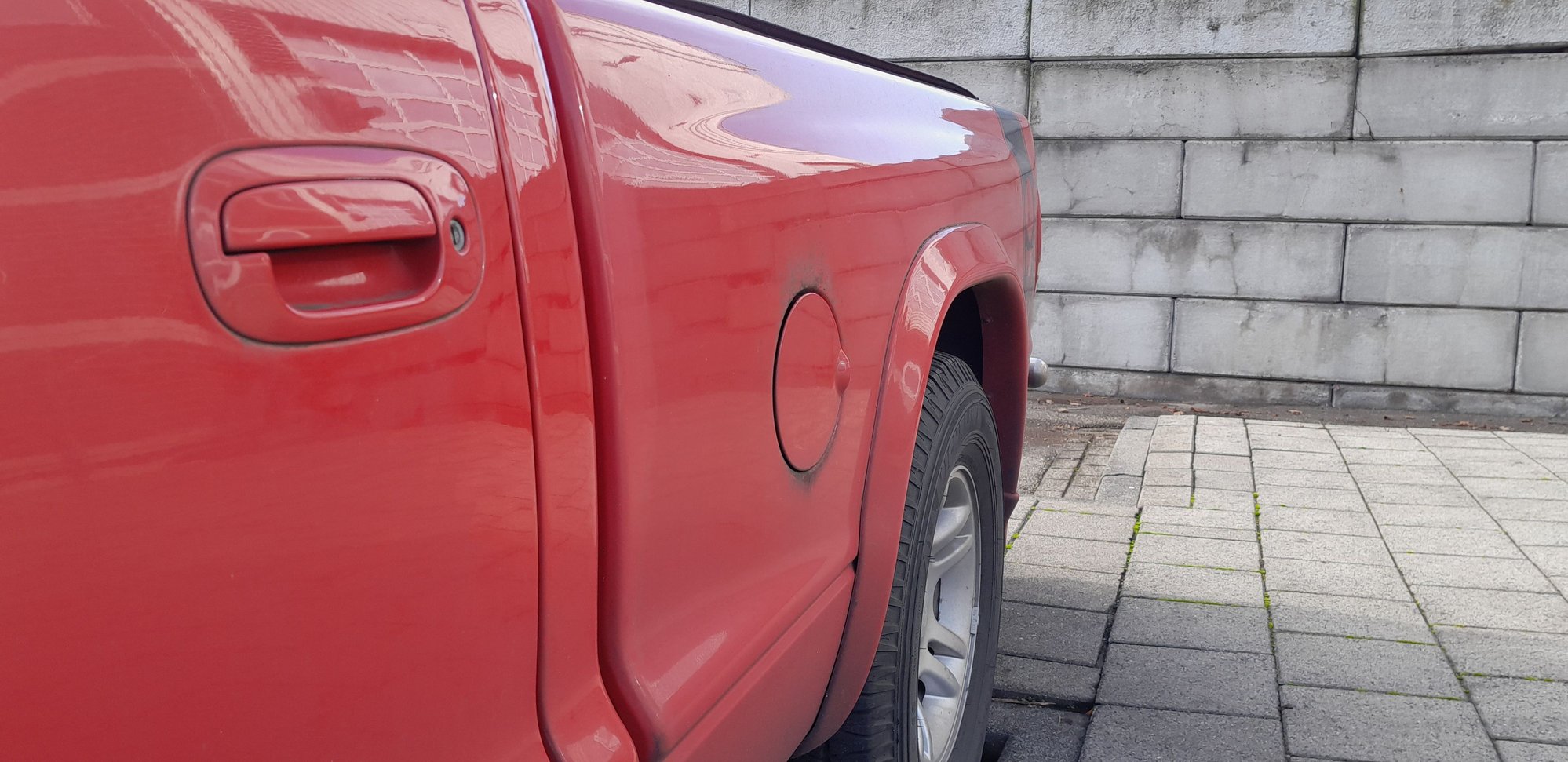

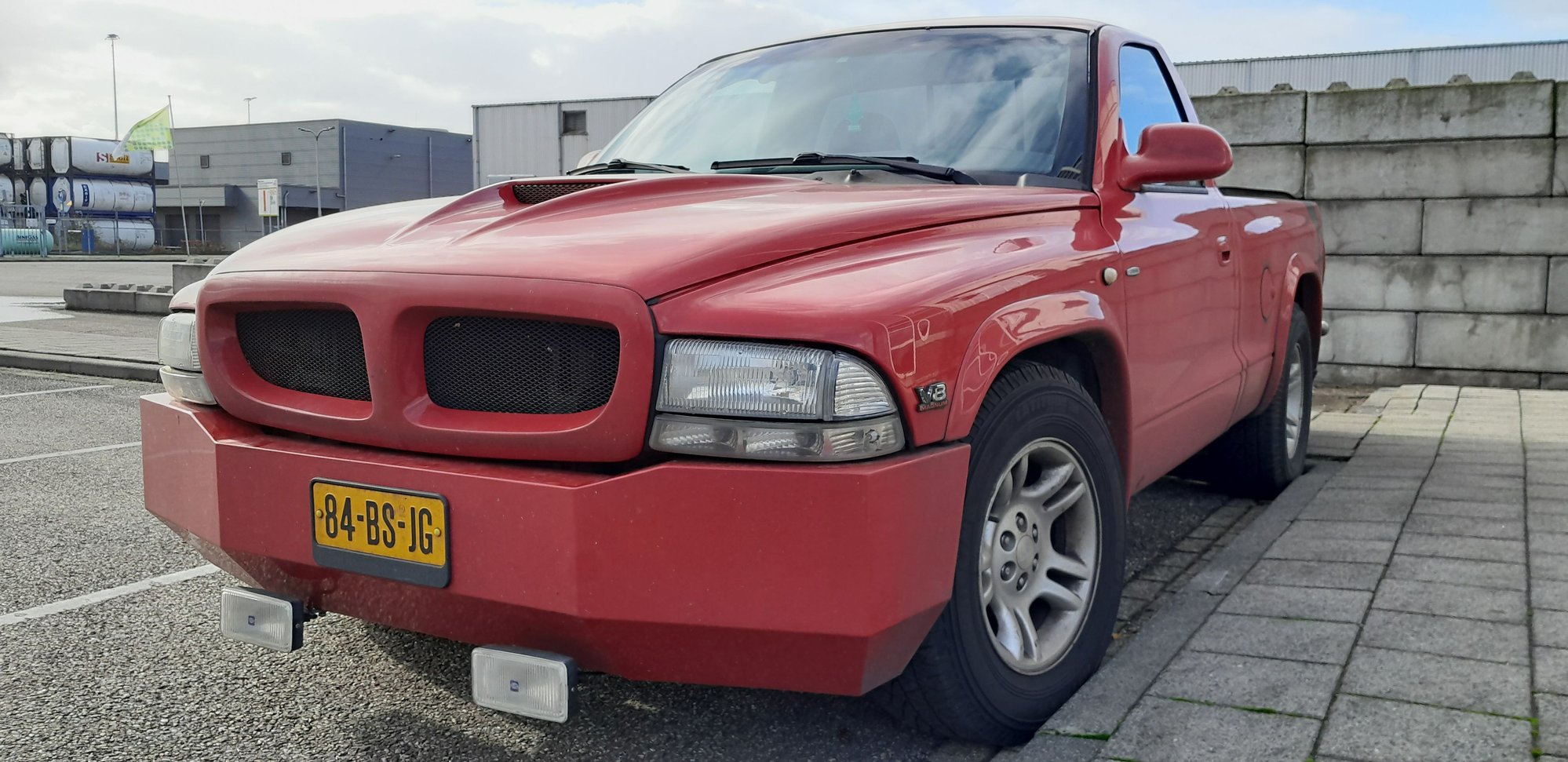

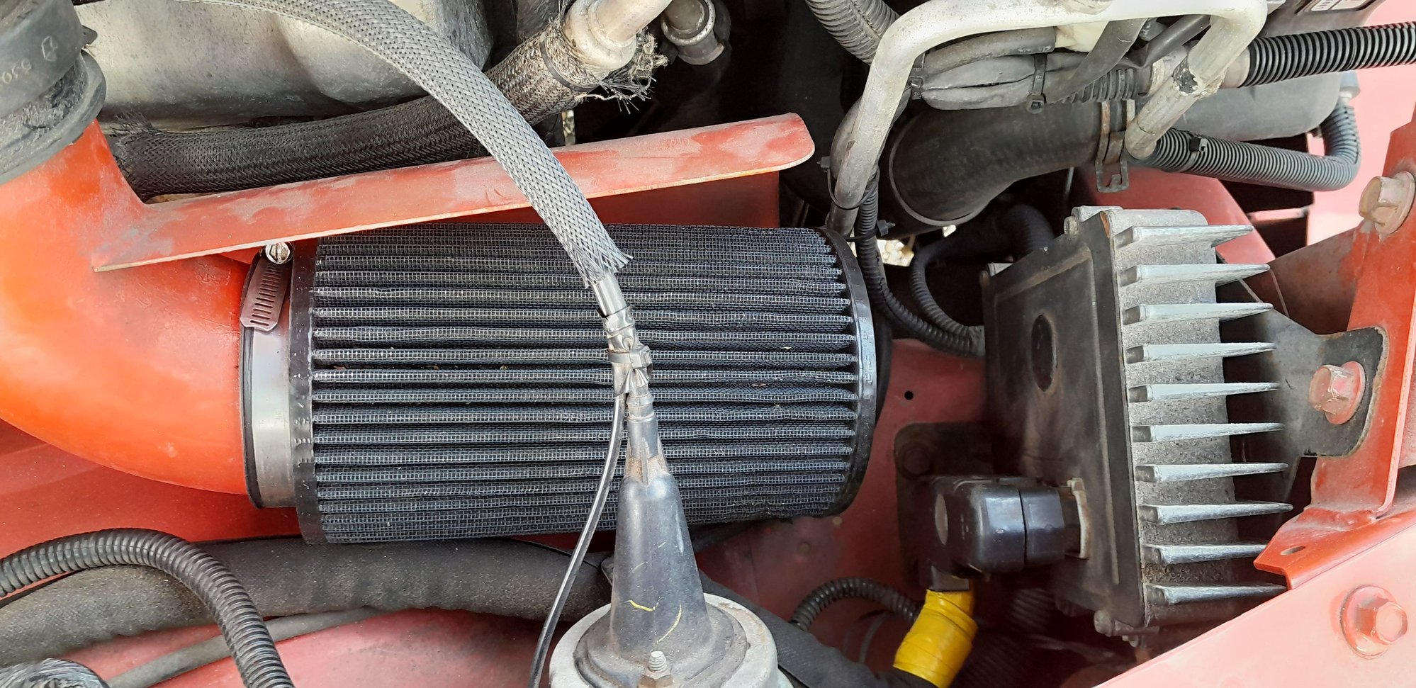

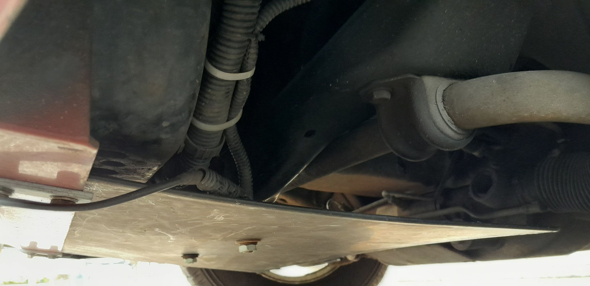

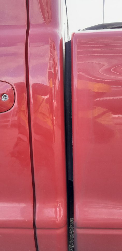

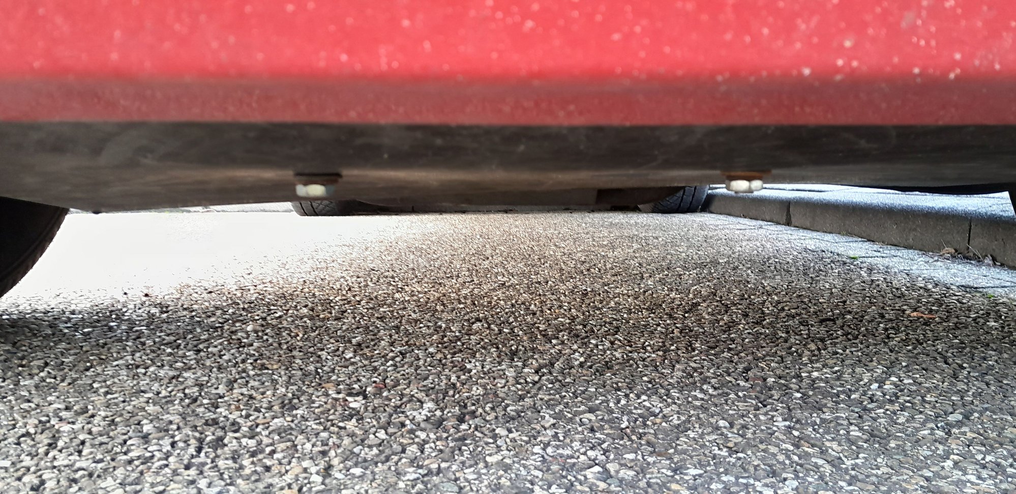

Introducing The Punisher !!!
Include some pictures of my 2000 Dodge Dakota Sport 4.7L 45RFE 2wd.
Showing the overall look, the Air Defector under radiator/engine, rubber bed seals and CAI ( Cold Air Intake ).
2000 Dodge Dakota Front Angle View
2000 Dodge Dakota Left Side View
2000 Dodge Dakota 4.7L View
2000 Dodge Dakota 4.7L CAI View

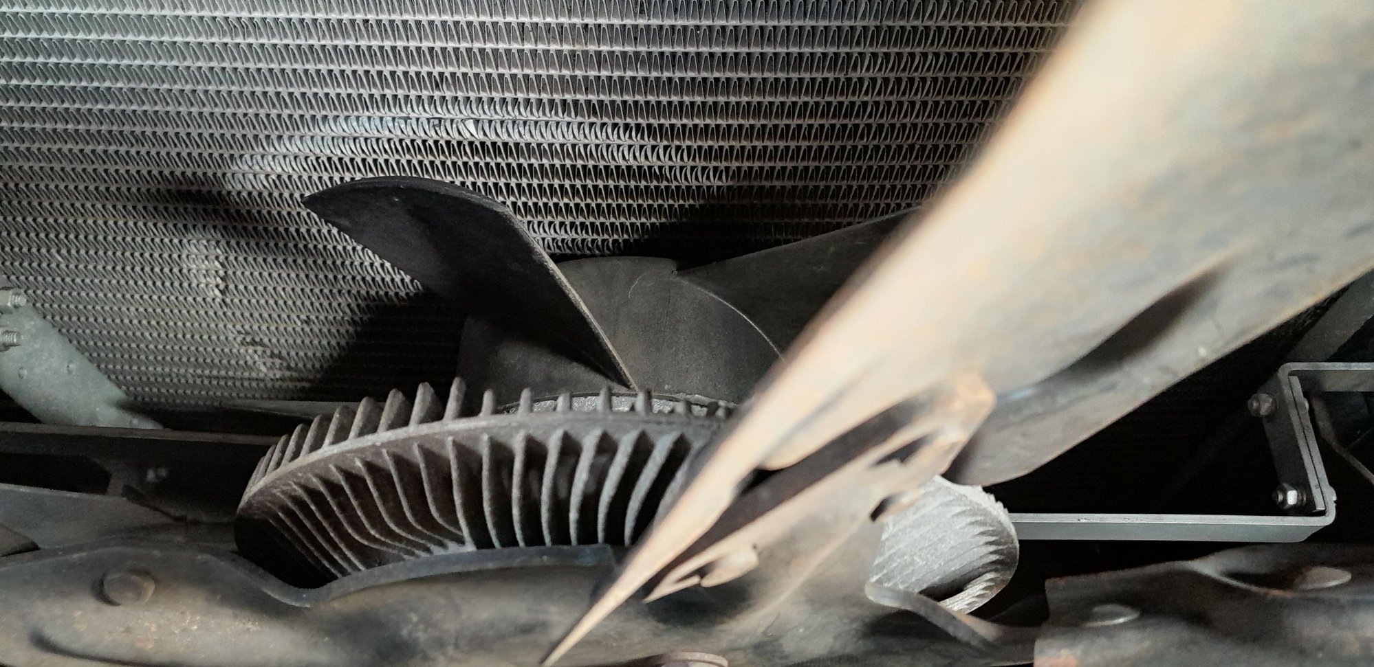

2000 Dodge Dakota Auxiliary Fan ( 1985 Saab 900 Turbo ) View
2000 Dodge Dakota Air Deflector View
2000 Dodge Dakota Rubber Bed Seal View

What is that grille on there?
Old Nov 7, 2021 | 04:33 PM
  #68
V8Cowboy's Avatar
V8Cowboy
Joined: Oct 2018
Posts: 194
Likes: 52
It's a Cervini's Grille
https://www.cervinis.com/97-04dakota-sniper-grille.html

on the bed seal, how hard would it be for you to pull the bottom part of it back (zip tie it out of the way) and have it stop at the top of the wheel well and drive/test it like that? If you look at the pic of the Ram, there is no fender flares on the bed around the wheels. I bet with the seal in there the lower part where the boundary layer is sticking to the bed it is hitting the fender flare and causing more drag, by moving the end point of the seal up towards the top of the bed it should reduce that drag. With there being such a small area that is changed by the seal (at that point) gains end up being reduced. But... I can say with 100% certainty that there is a gain to be had there. How much that translates into mpg's would need to be evaluated. All the little gains will add up.
I like your belly pan! it looks like it covers the bottom well and there is minimal if anything sticking out below the end height of the piece you installed. my 1st shot at an air dam under there is going to just push the air downward towards the pavement like on the Ram. I will use fluid film on the air dam face to see where the airflow is hitting and eval more from there. Not sure I can pull off a belly pan with the front end components sitting the way they do. It was also an issue with the Ram so I leveraged what Ford did with an F150 (2010~2014 time frame IIRC) and their front dam setup. Back in 2018 I was in the middle of the make over and the bet with the co-worker and had all the mods in place. Was able to achieve 19.3 & 19.8 mpg crossing Idaho doing 80~85 for extended periods of time (hours) the way it was setup. That was before I realized the easy fix for the bed seal was to just not run it all the way down the bed like on the newer 4th gen Rams. I ended up taping up the bumper so airflow could not enter it and cause drag.
Looking at the Dak... if those flares came off, the bed seal would be good down to that body line like on the Ram...
Your fan setup is interesting, how does that 2nd fan attach?
