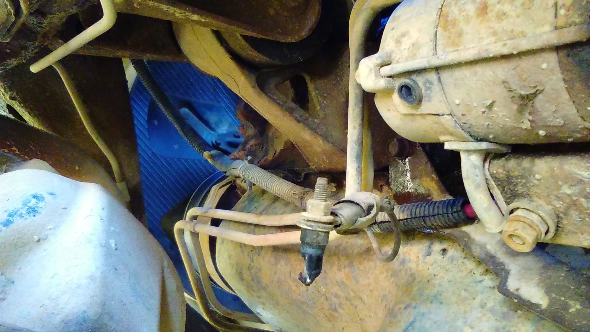

Today the truck got a new throttle valve cable and return spring. It turned out that the stretched spring was the culprit causing some shift weirdness by not returning the valve to the fully closed position. WTF PITA FML.
The new cable, from Crown Manufacturing (52104030AB), has too large a socket for the ball stud at the transmission end. Of course. I couldn't find the package of mylar sheet that's supposed to be in with my miscellaneous bits, so I cannibalized a mylar insulated ribbon cable out of a dead DVD drive that turned out to be almost exactly the same width as the depth of the socket. Two turns of that around the inner diameter of the socket and the thing clicks into place with just about the same force the correct socket requires.
Lately these ten minutes jobs are getting entirely too complicated.
