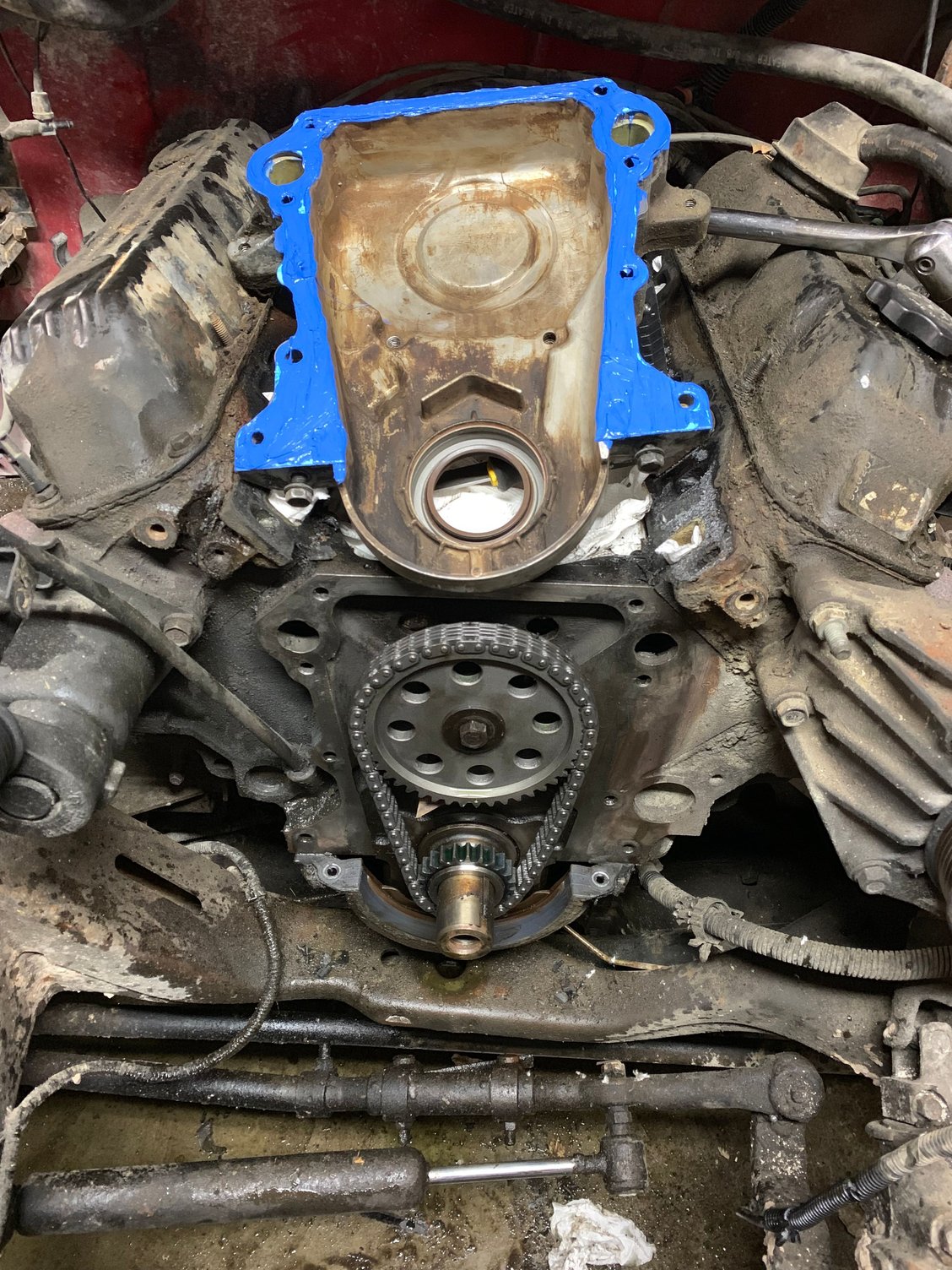

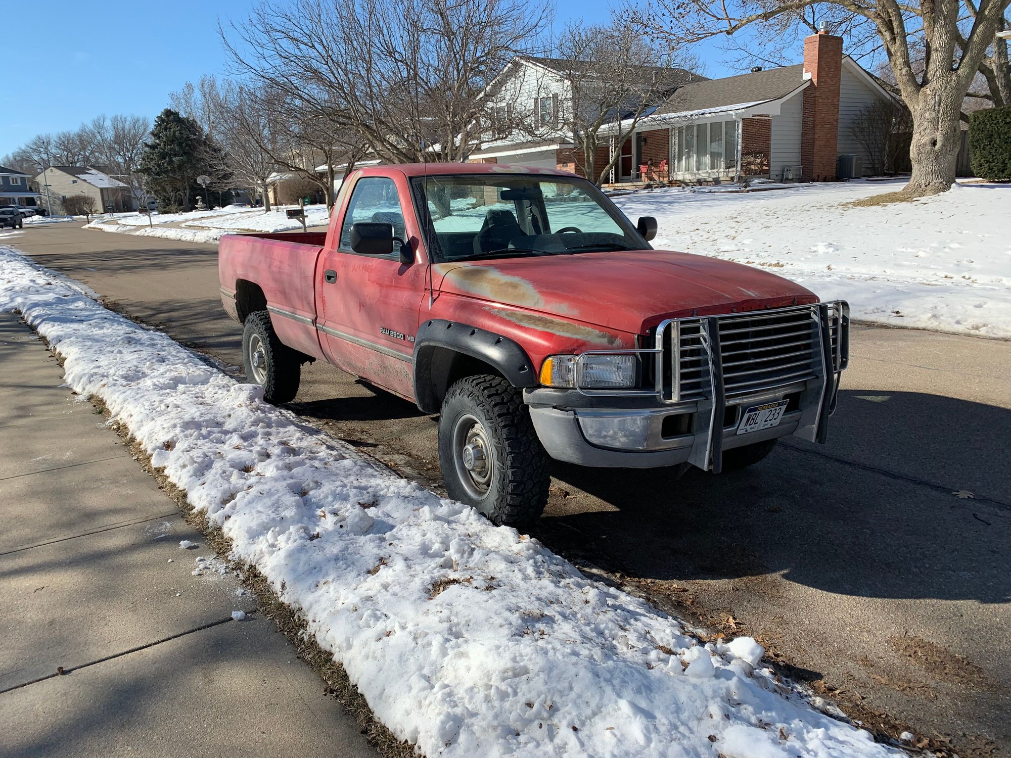

Fixed the plenum in the beater truck and installed a timing kit that I had laying around. Didn't do an aluminum plate, just shortened the bolts and kept the stock steel plate. Time will tell if it holds up or not. Also did some valve stem seals and valve cover gaskets cause they were leaking pretty bad.
Did you do a rear diff swap in the beater truck?
