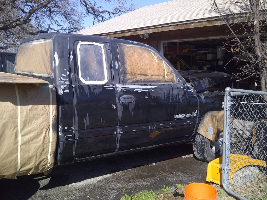

Got back into town from business trip last night….and played hooky from work today….cause I wanted to paint!
Backed out and washed….
Painted the black etching primer –
It dried in about 10 to 15 minutes this time. Seems to work MUCH better when you mix the catalyst in it instead of hardener…..live and learn I suppose!

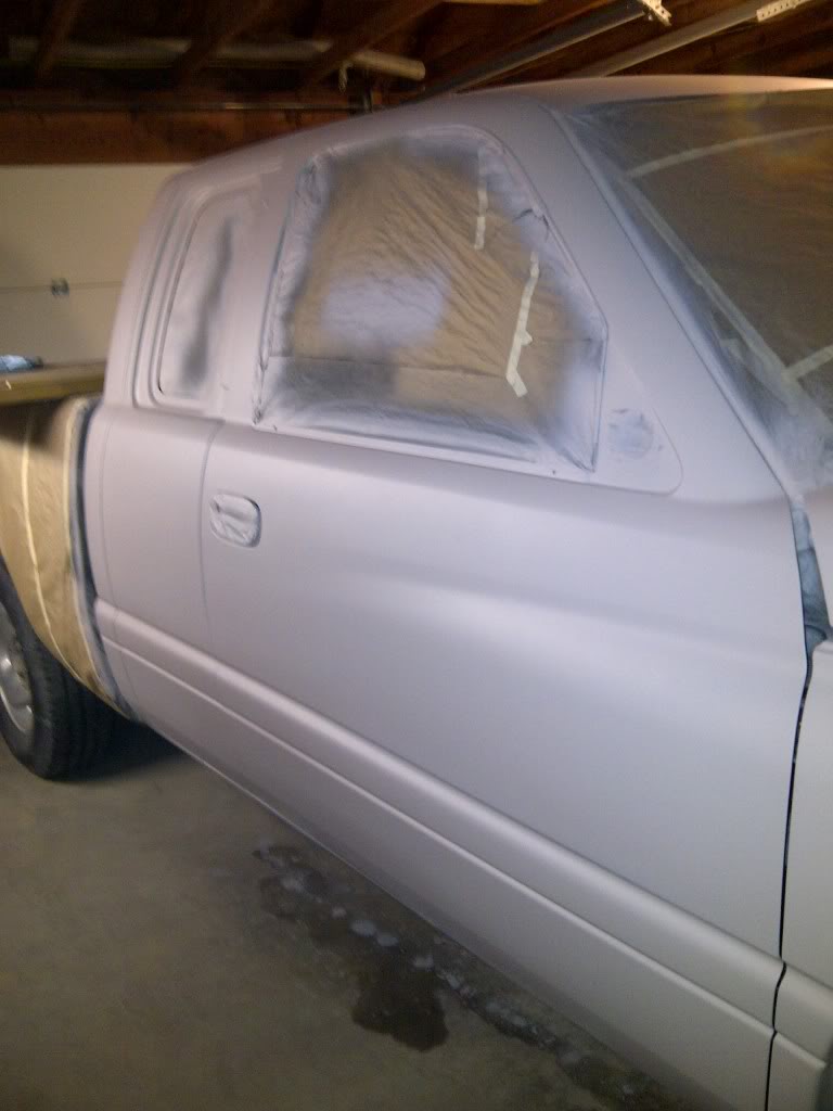

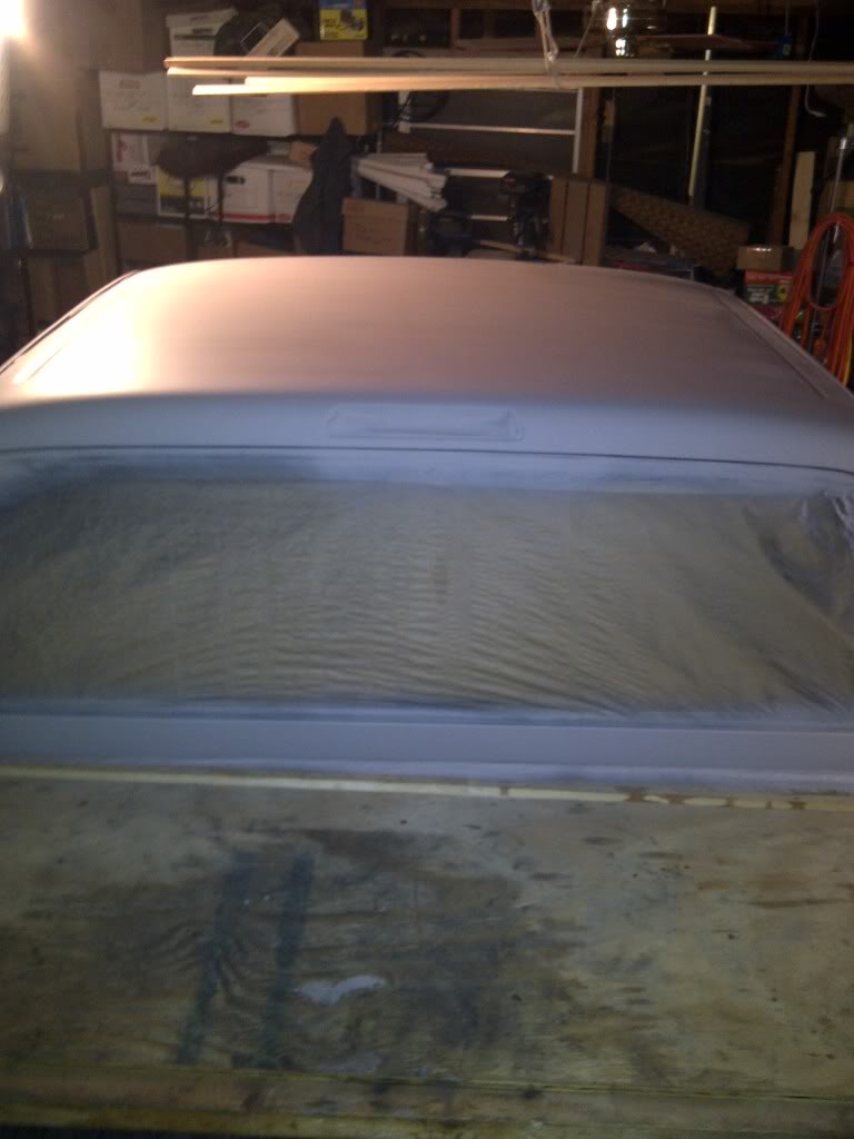

So here it is after etching primer with first coat of 2K high build primer. Will shoot a second coat tomorrow.
