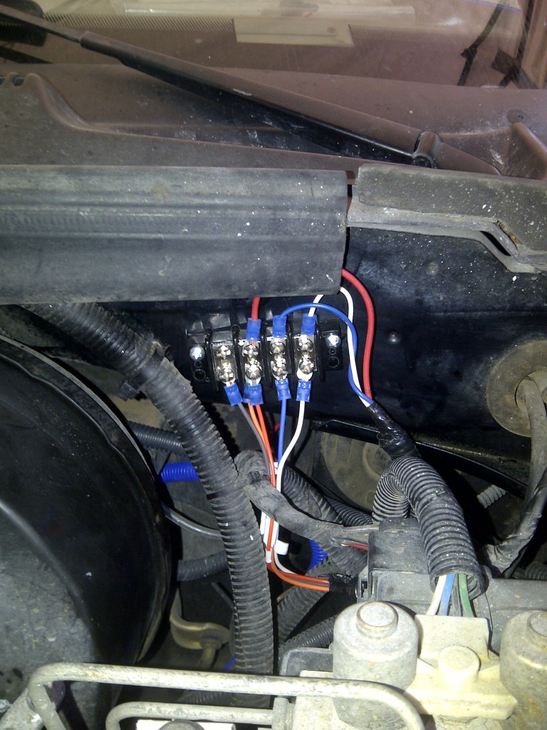

I have the wires for status on terminal strip on firewall. Brown wire, left end of block. My concern is damn cheap plastic. Won't get but one shot, and hope it does not crack up. I still have not decided where.

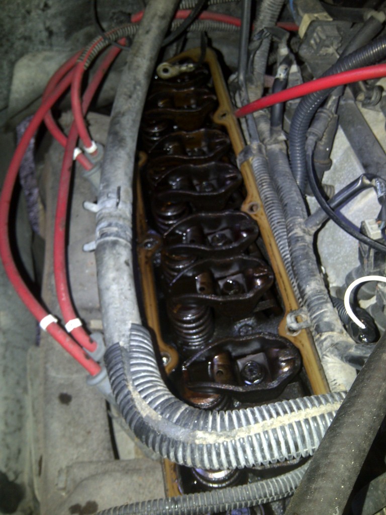

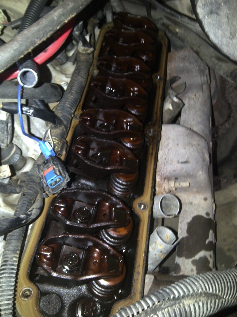

So today is the day to install my HS Rockers.
Before the work begins:

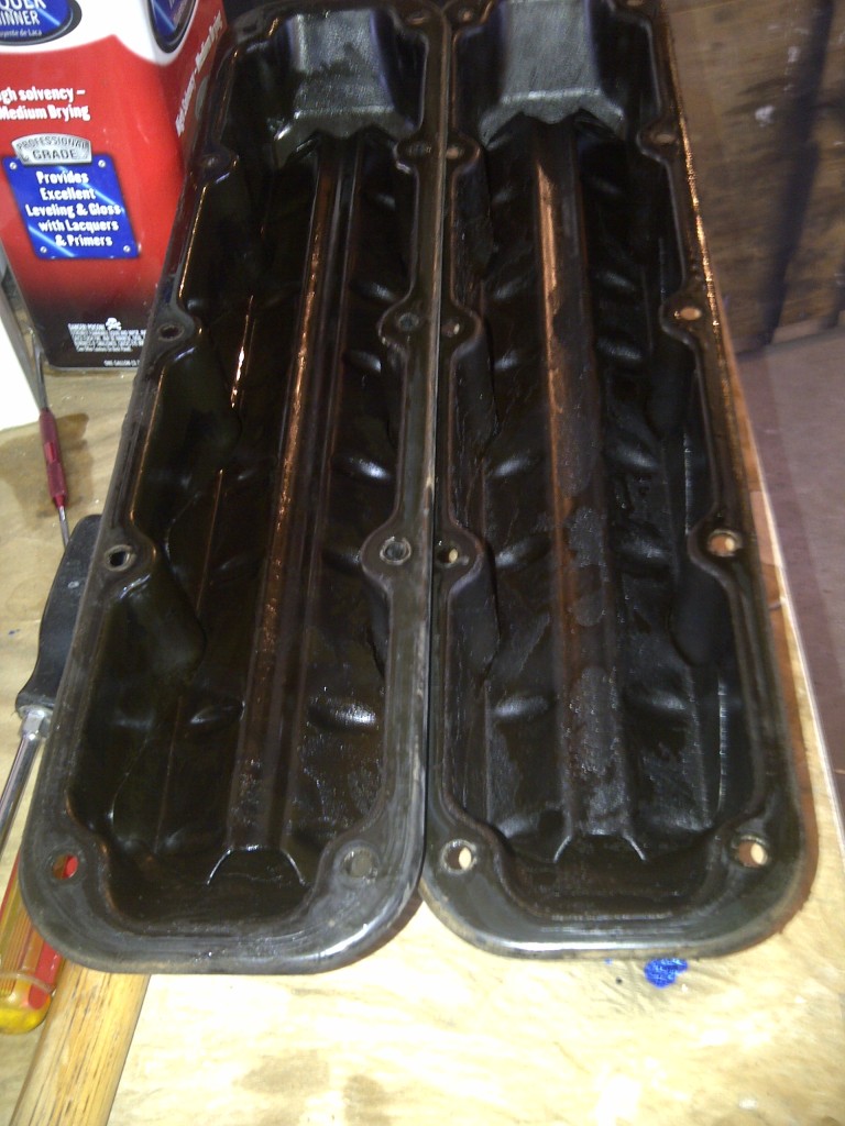

Valve covers – not as bad under there as I was afraid they would be:

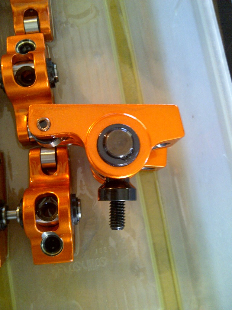

OEM Rocker:
HS Rocker – there were no instructions. Do I have this correct? I really did not see any other way the spool shaped piece could go.

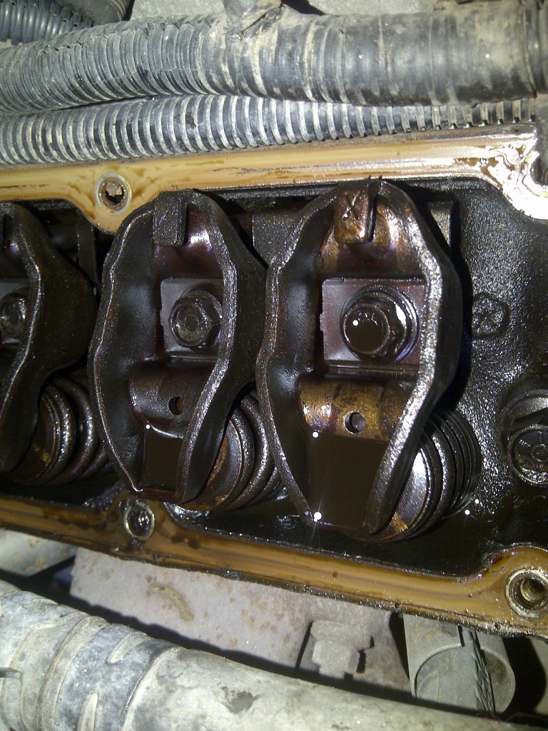

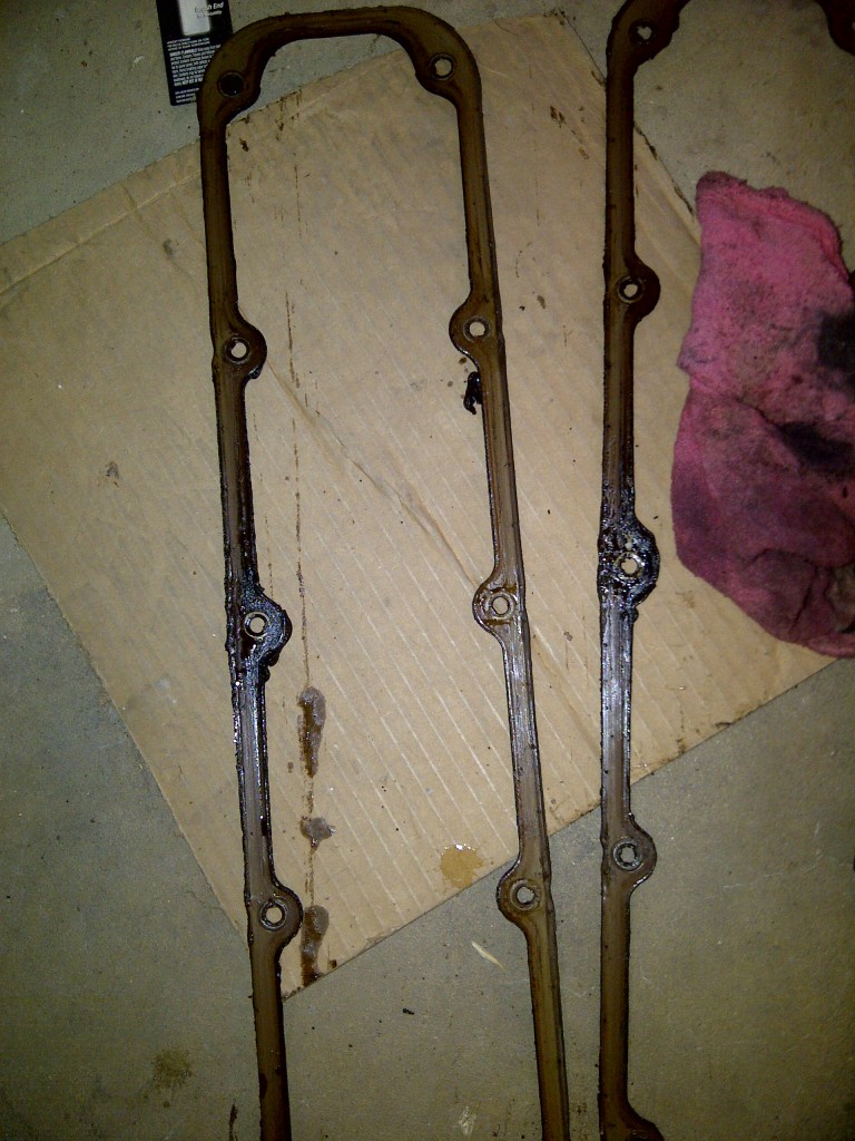

And the mystery of oil on bottom of engine is solved…..both valve covers appear to be leaking.

Yep, you have that correct.
Bad gaskets... how much oil were you going thru?
Yep. I'm jealous.
