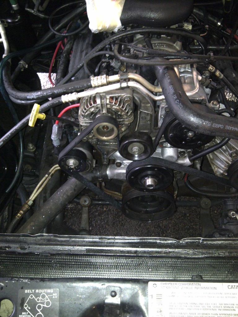

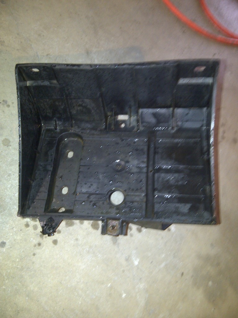

So I got the engine washed down and the battery box cleaned up.

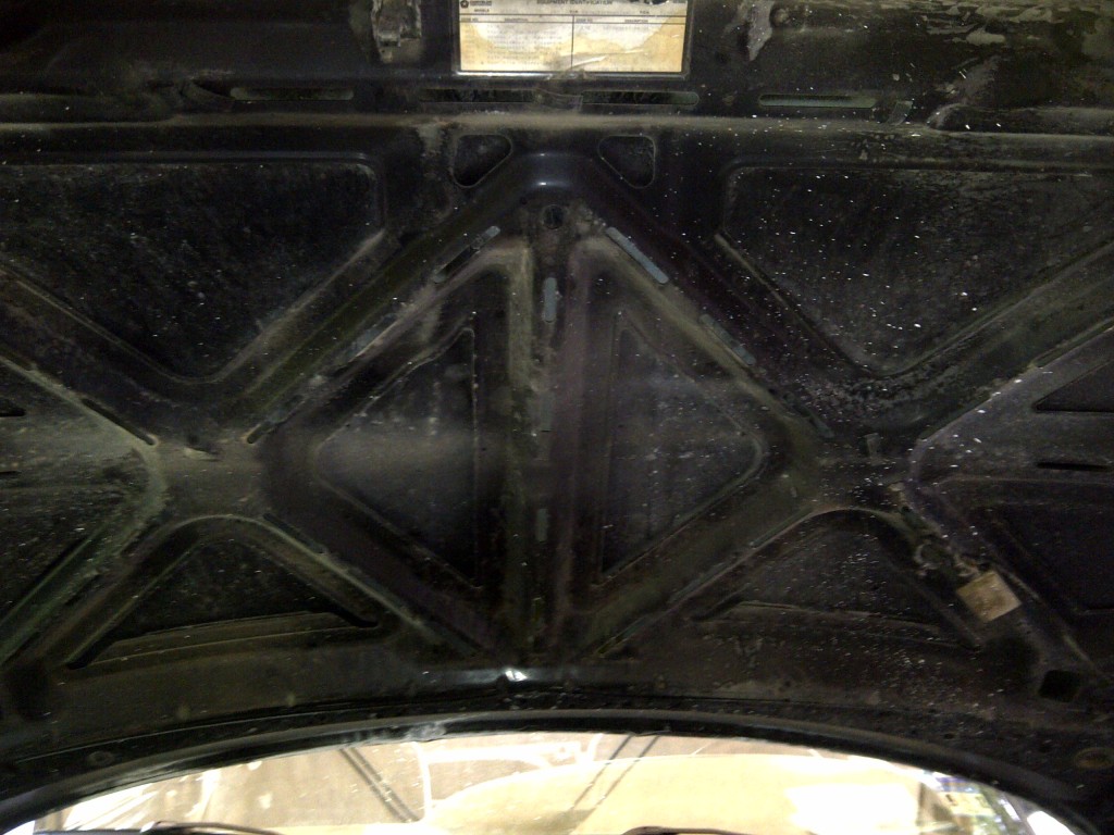

And while I was admiring my work (and waiting for it to dry a little) I looked up and saw this:
Wonder what I will be doing to this.........hmmmmmm.

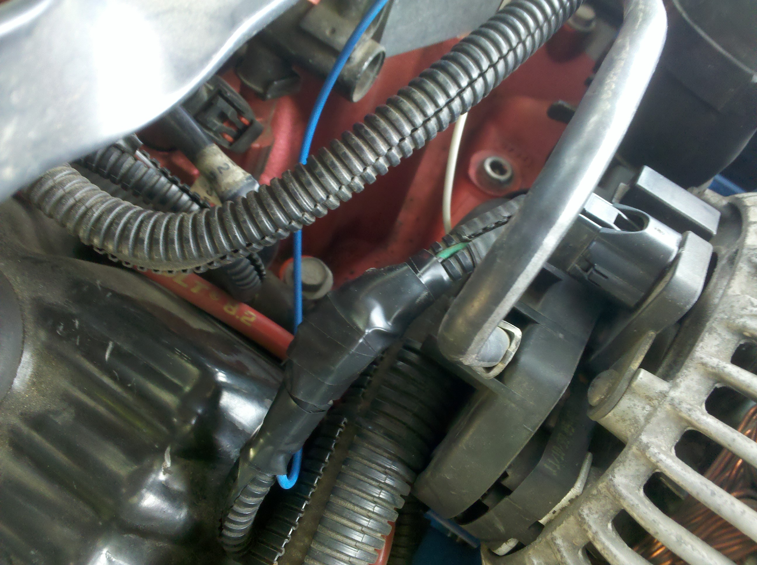

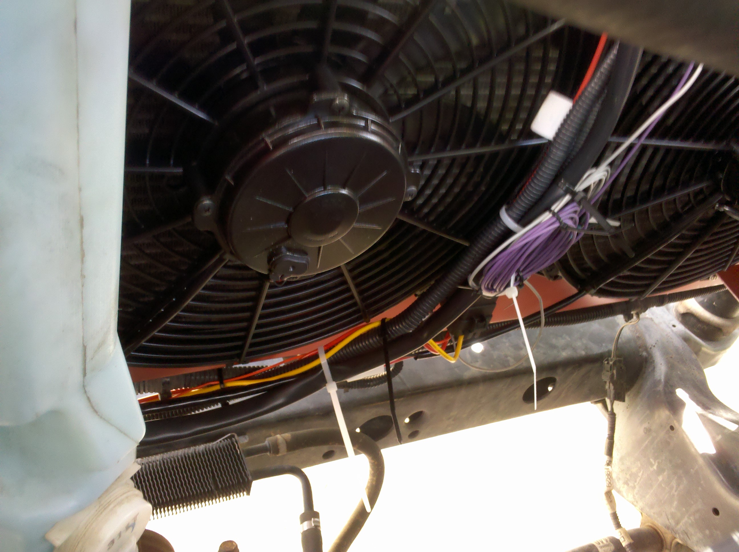

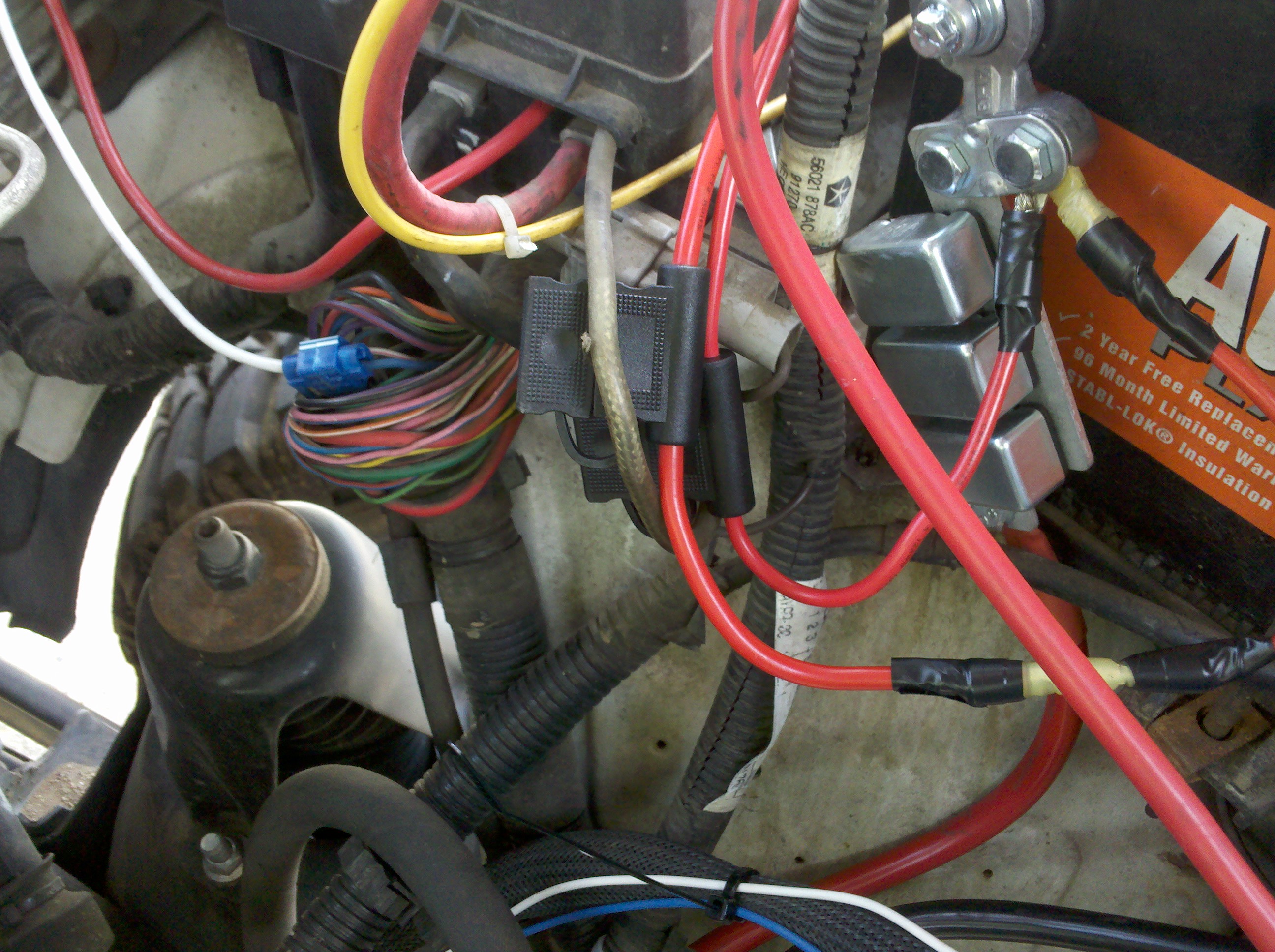

Here are some pics I snuck today. You'll notice I have the splice into the start/ignition wire (BLUE), which is then wire nutted to the orange (relays). Looking to determine location of the LED and manual switch first to get all that tied in.
I ran the HOT leads to the front of my battery where they are tied into the winch lead. Initially, I did have them in the PDC. It was a bit tight in there, but it can work depending on the crimped connector you use.
The ground locations I used are driver fender, right behind the headlight. 2 spots, one is on side of fender and other is bottom of fender. Far fan ground just barely makes it to the bottom ground location. These will be tied together later for use with the manual switch. Just not sure how.
I cut excess wire out, red and grey wires. I rolled the purple up. Everything is zip tied tidy for the most part.
I'm using Preset 2 settings.
Let me know your thoughts. I've had no probs yet. Btw, programming is not that clear in the manual. Turn key to ON (no start) and then do the programming.
