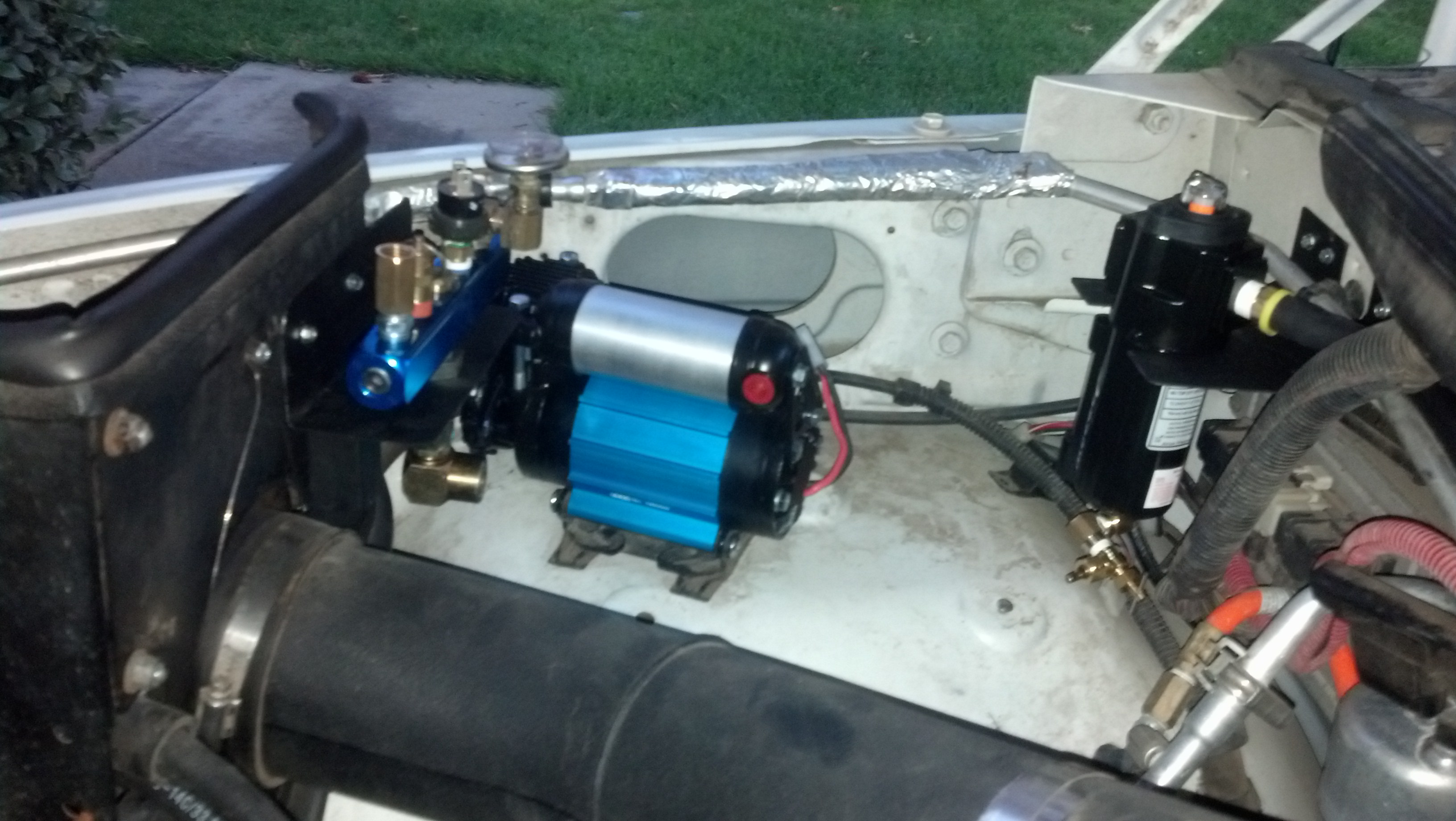

Is that a small compressor sitting on the fender well there?

Yes, that is an ARB CKMA12 compressor from my original OBA install that is documented here on DF. Actually it's a warrantied unit. It's rated for airing up tires and now will be dedicated for locker duty and could still be a air source backup.

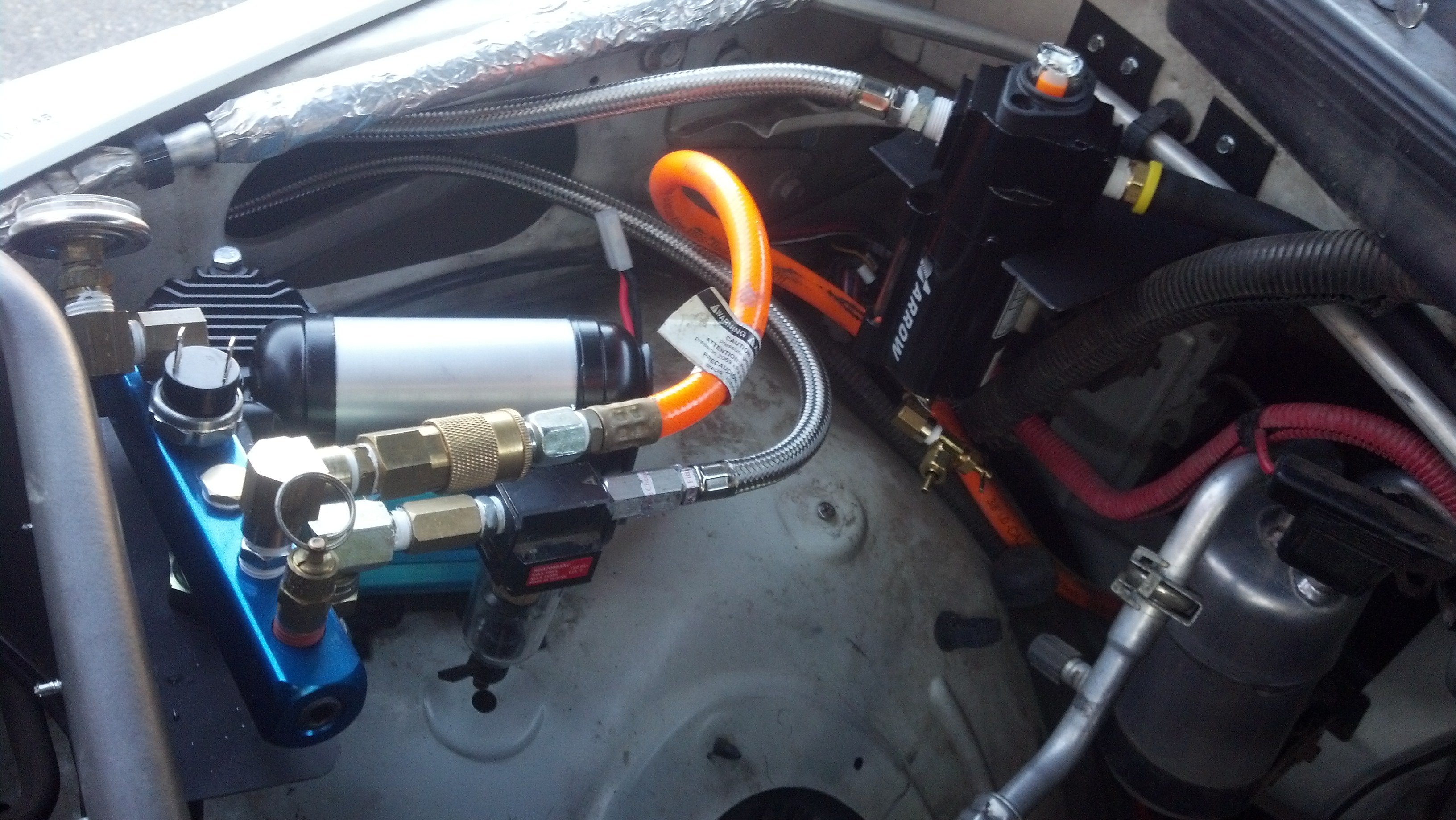

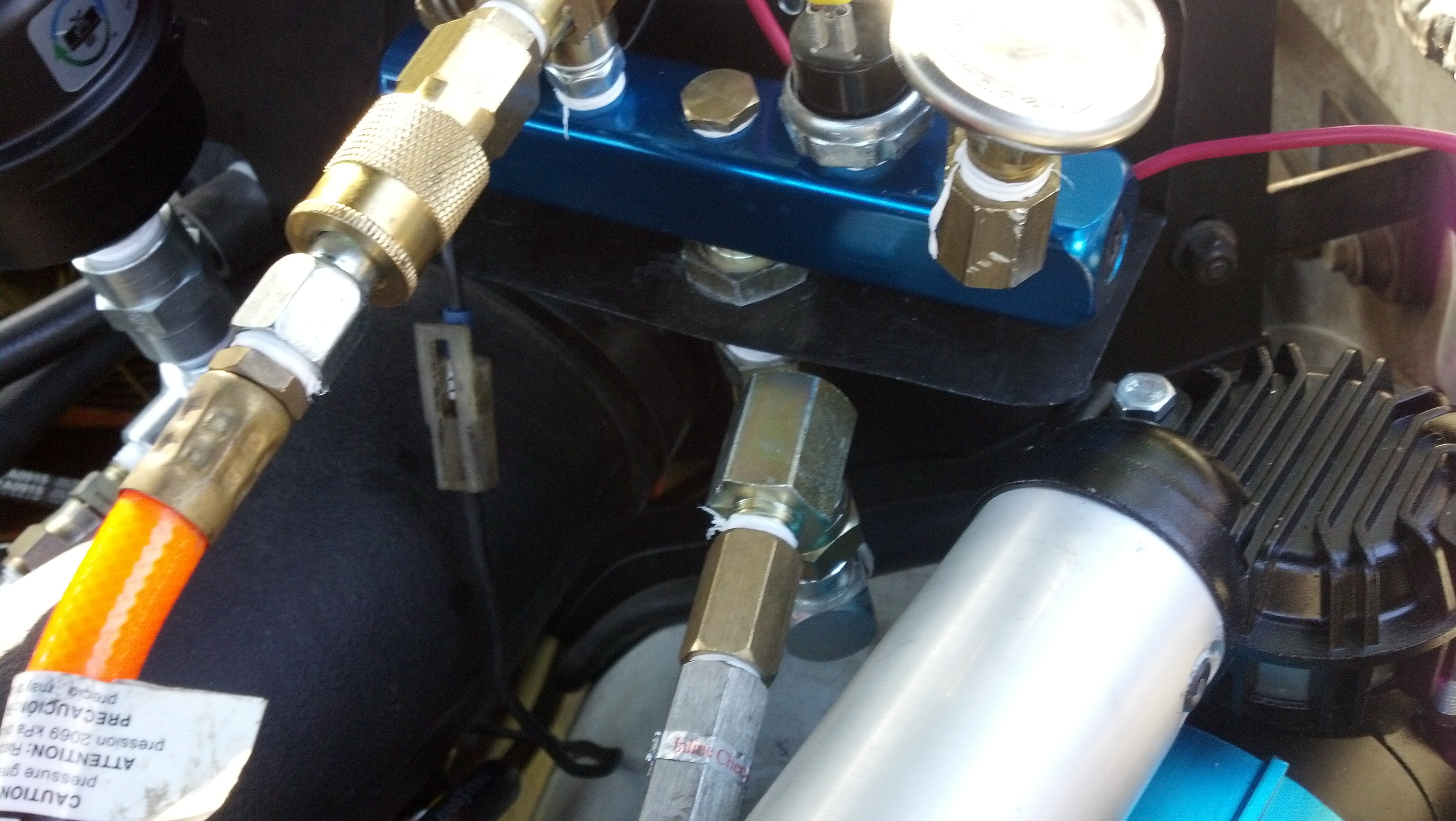

Ok...I'm now calling my York OBA complete! Still a leak to chase down near the tank, but whatever. It charges the whole system with the 5 gallon tank to 100 psi in roughly 15-20seconds. I'm happy with that. I do have a higher pressure switch, but don't think I need it.
Only hiccup the last day here for final install was chasing leaks, the water separator could not handle the cfm so yanked it, and put the combo pulley on a coworker's lathe to take 0.1" off the back to stop the slow-dying-in-vein-rabbit (belt squeal).
