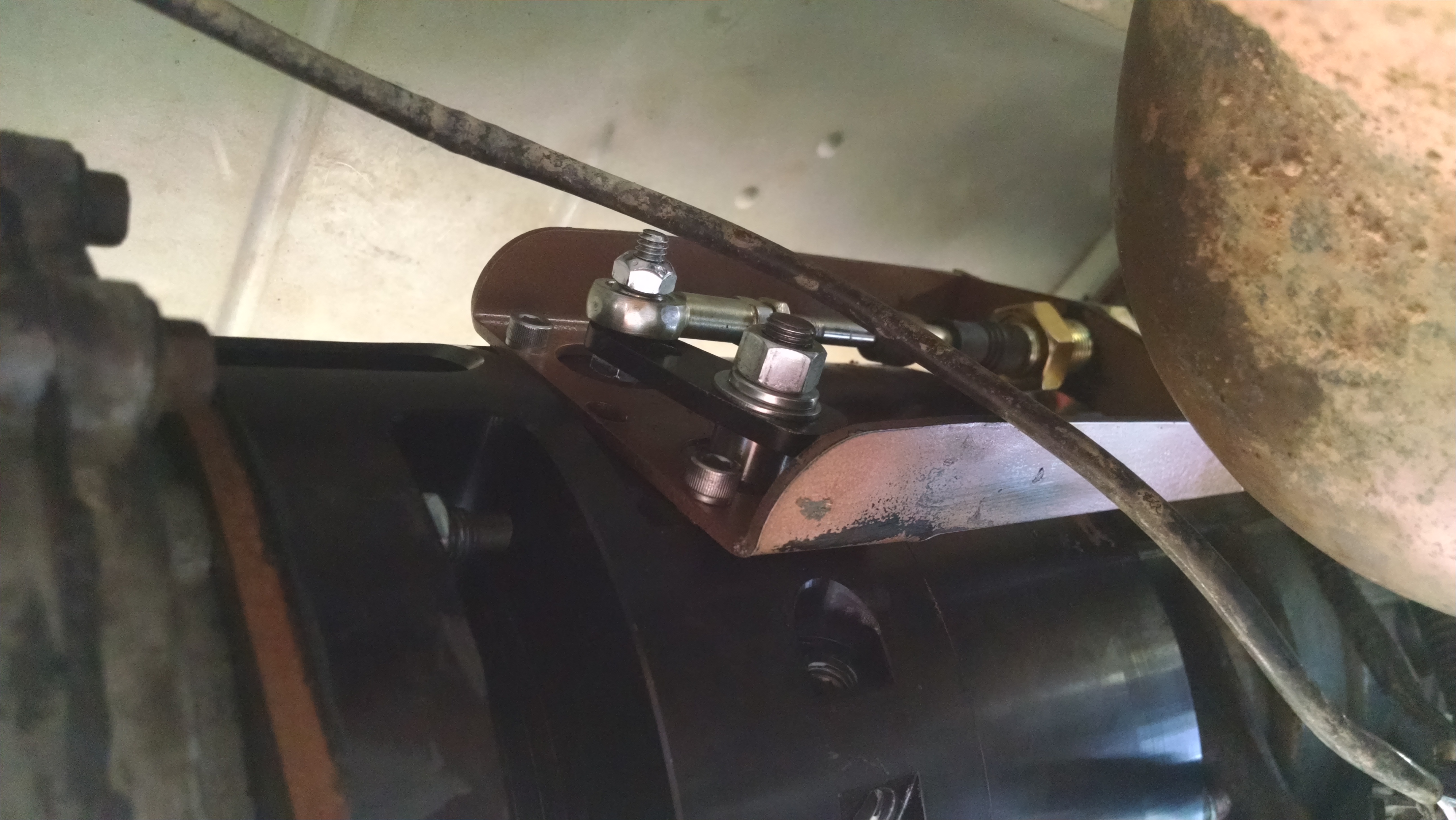

Transfer Case
Done -> Mount BB to 241, RTV
Done -> Assemble shifters for 241 and BB (still needs lever installed though)

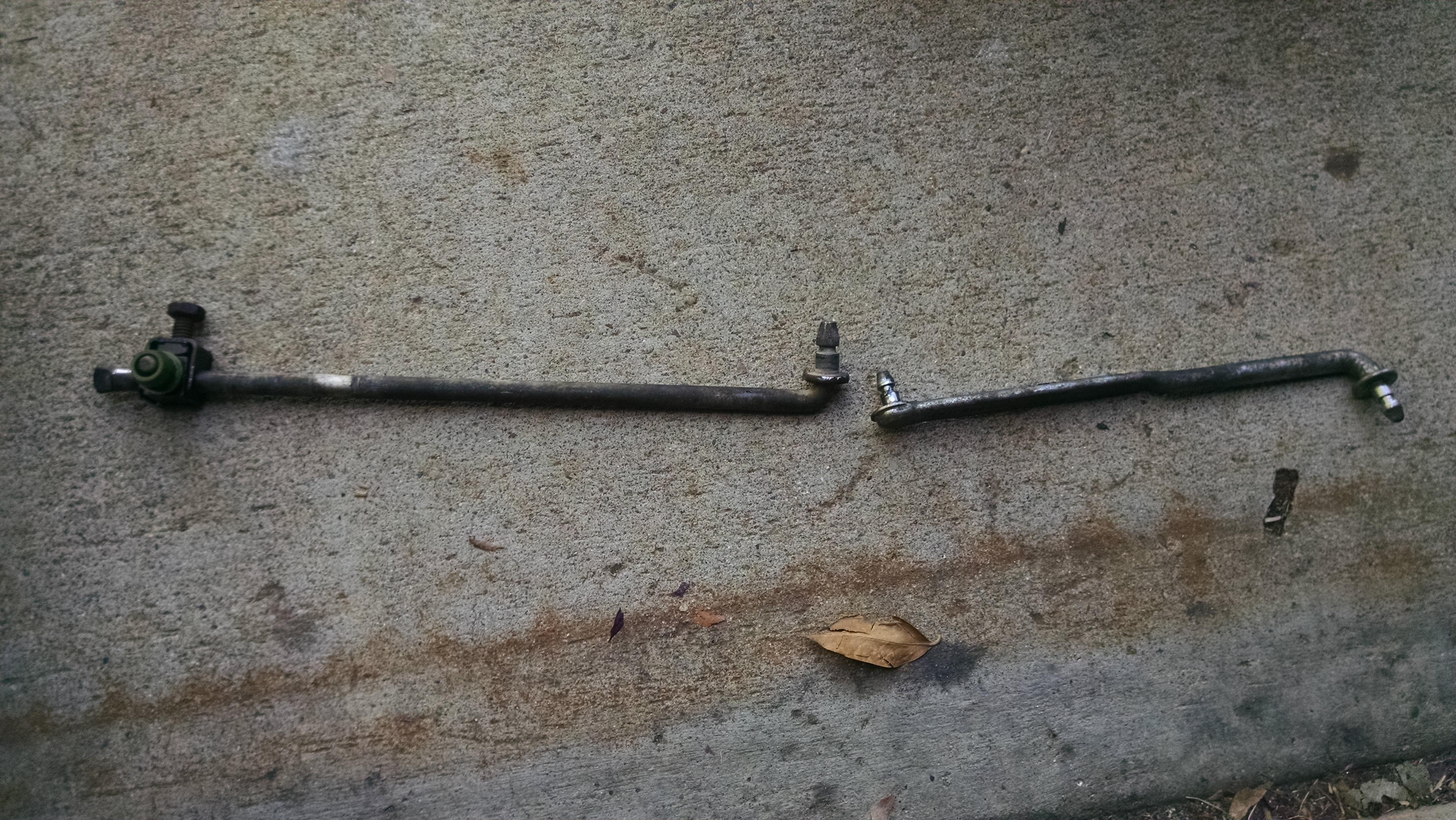

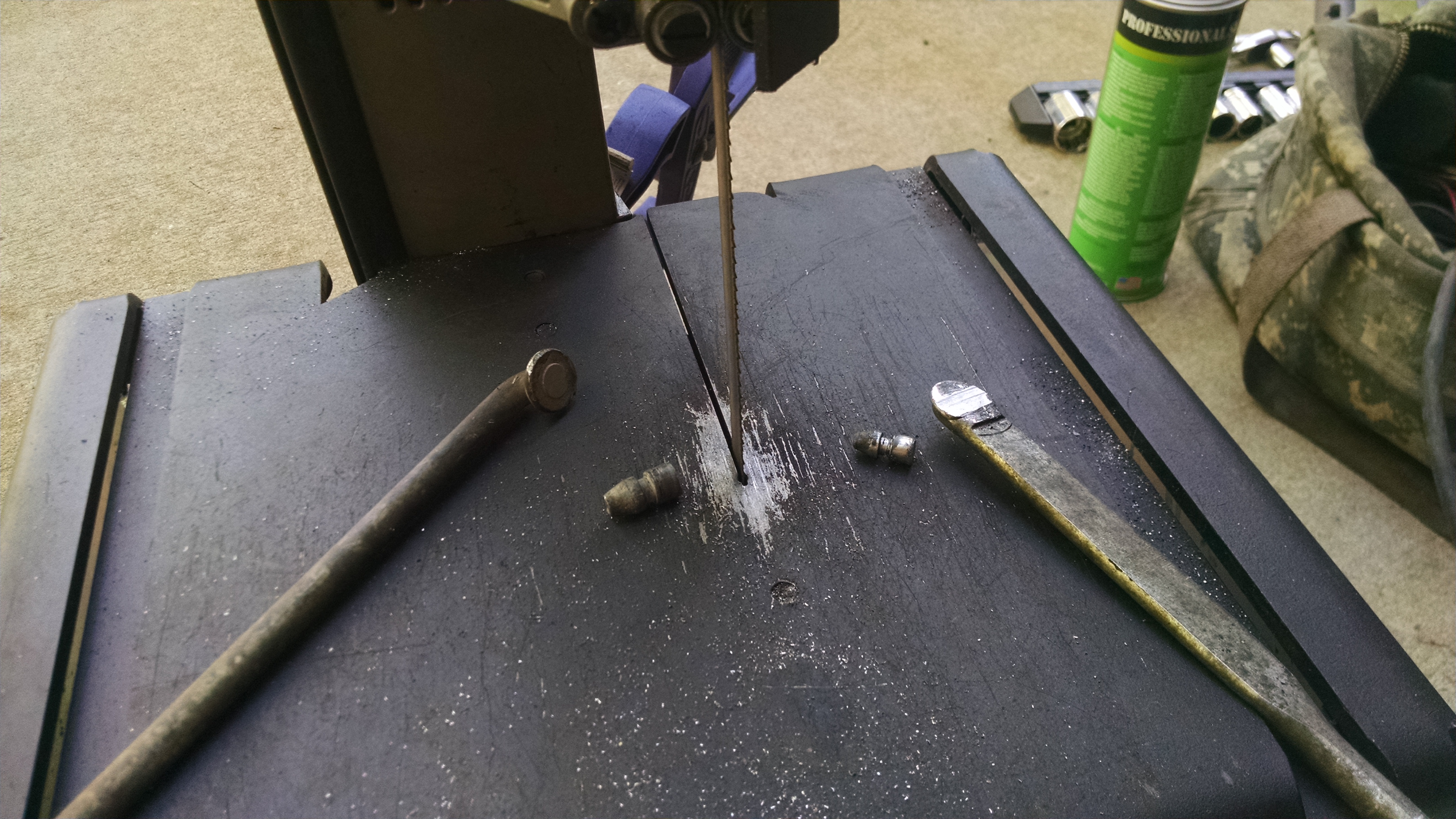

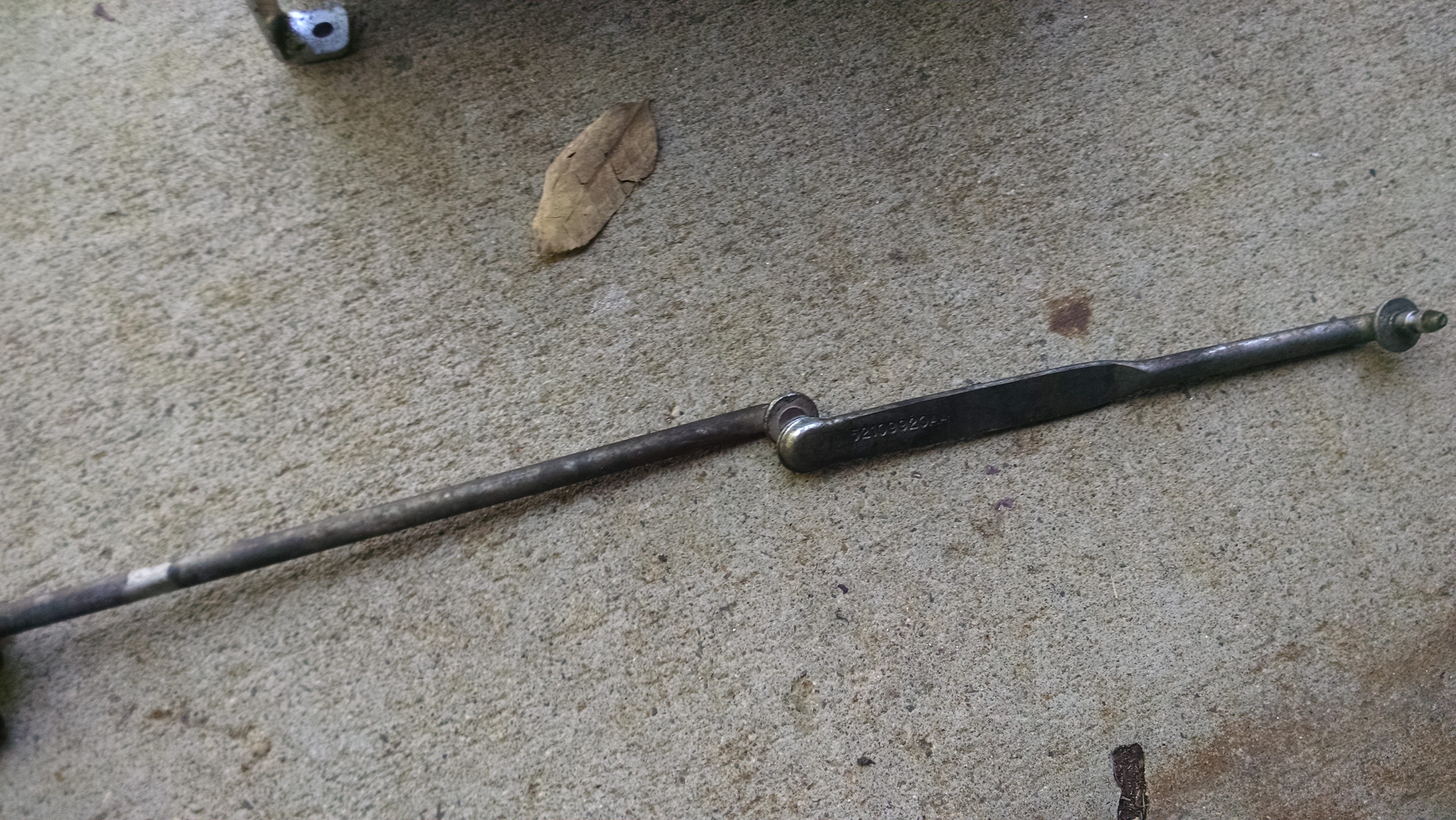

Linkage from my truck and from the 241 left to right, respectively.

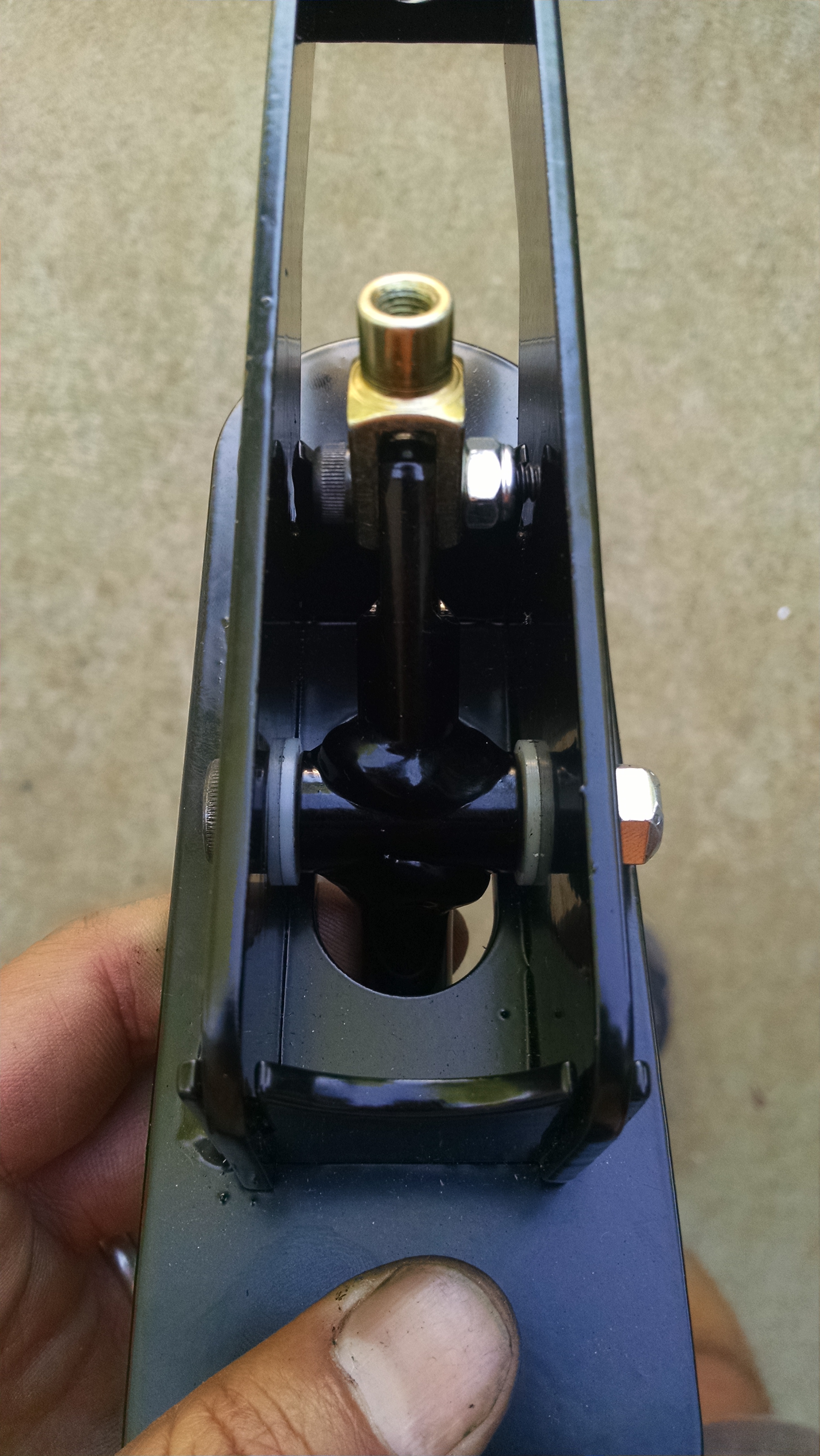

Default Floor shifter and Sway Bar Link Tabs

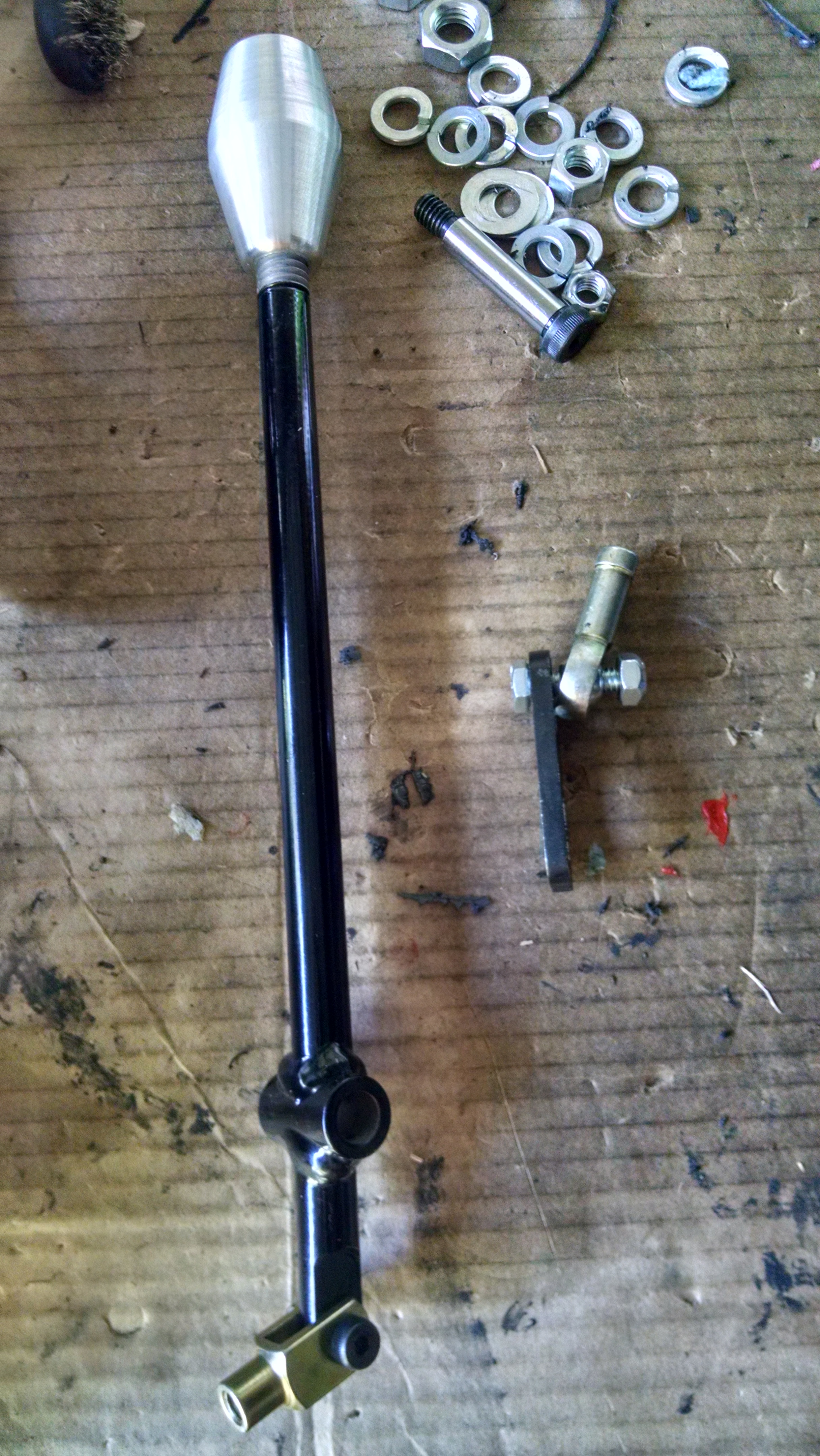

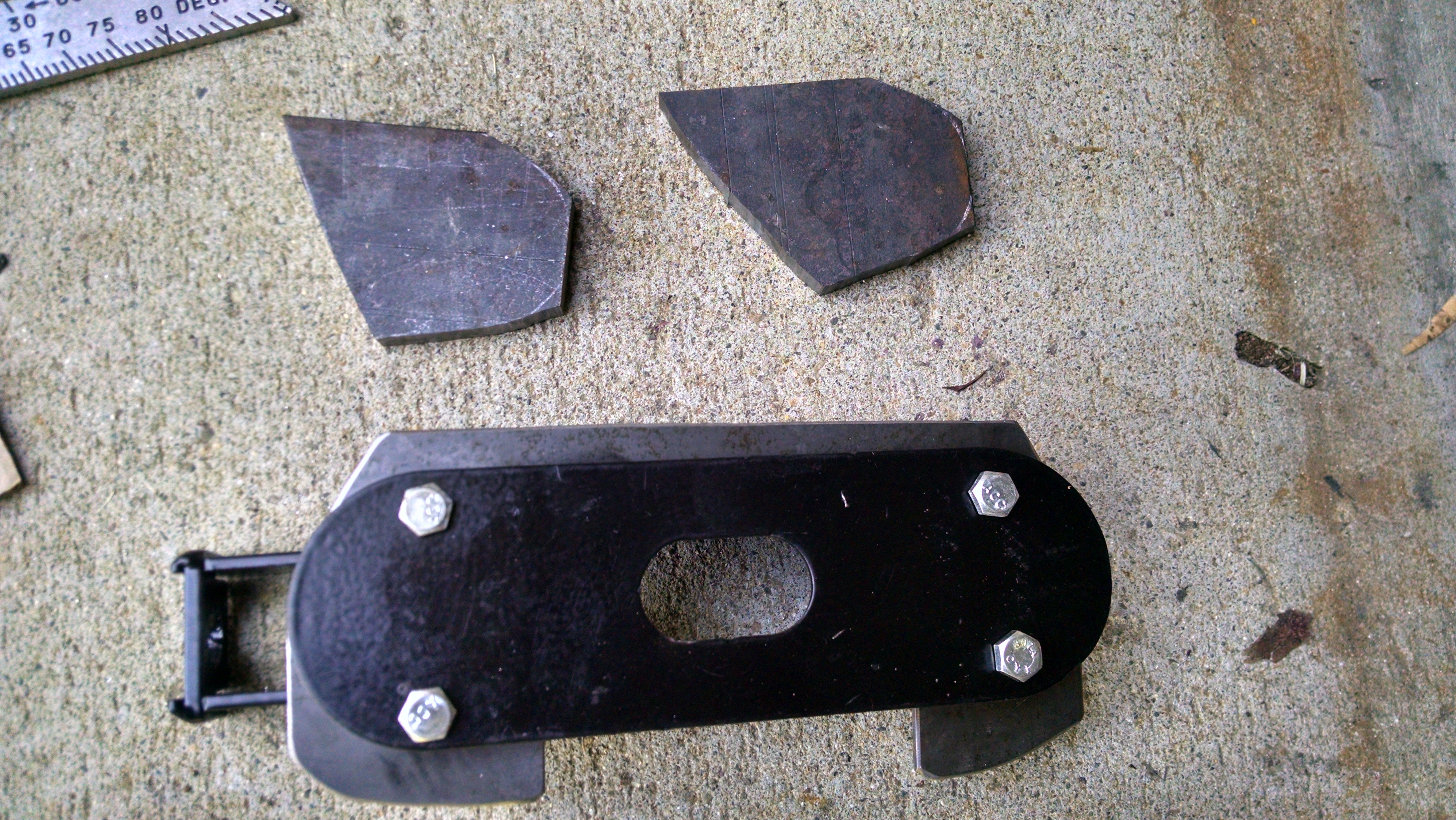

Floor shifter has a flange that is to be used in any means needed by end user. I decided to use 4 bolts and have a mating plate on other side of body sheet metal to clamp. Large enough to spread the load, however, the shifter is pretty smooth.

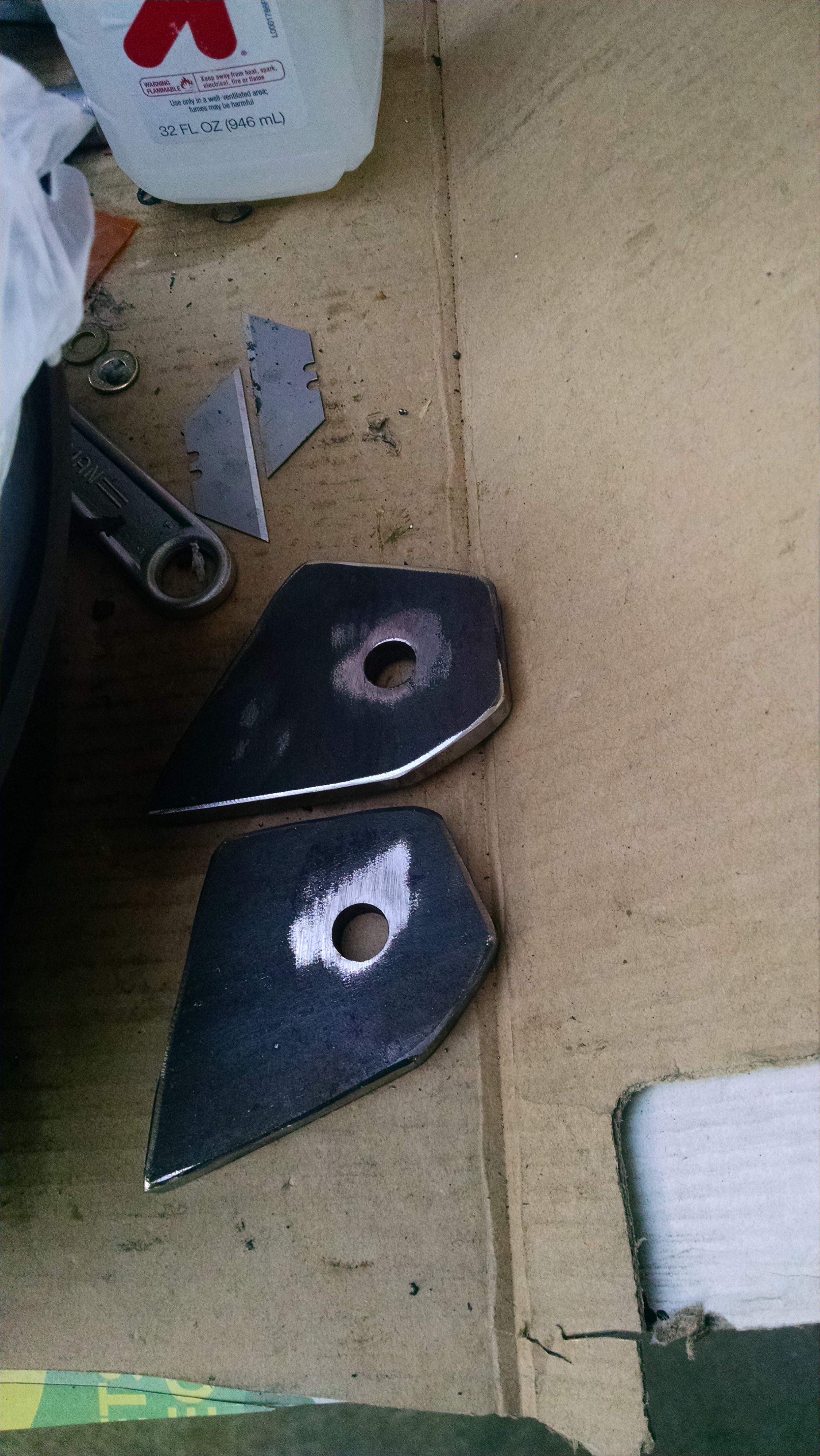

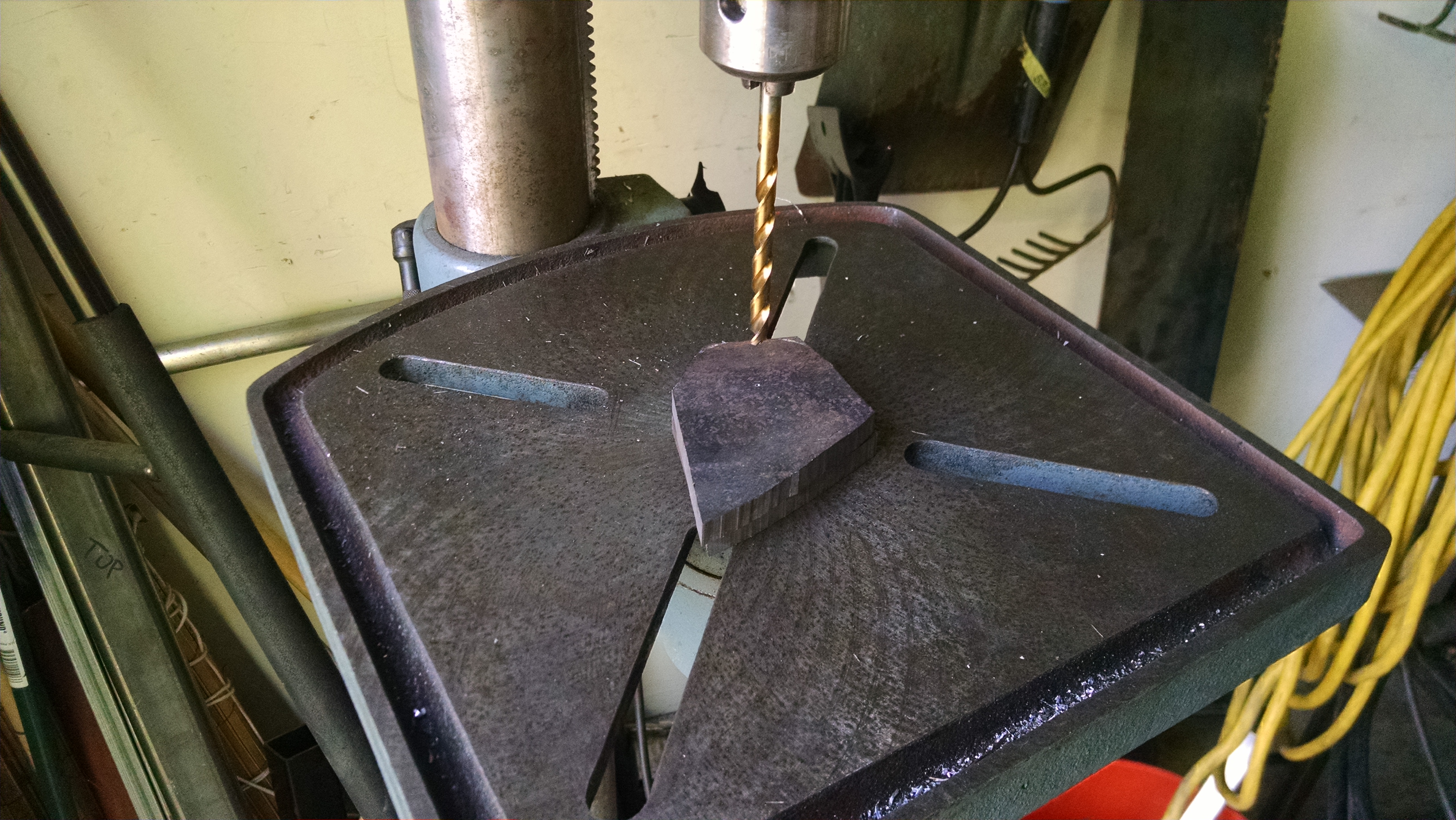

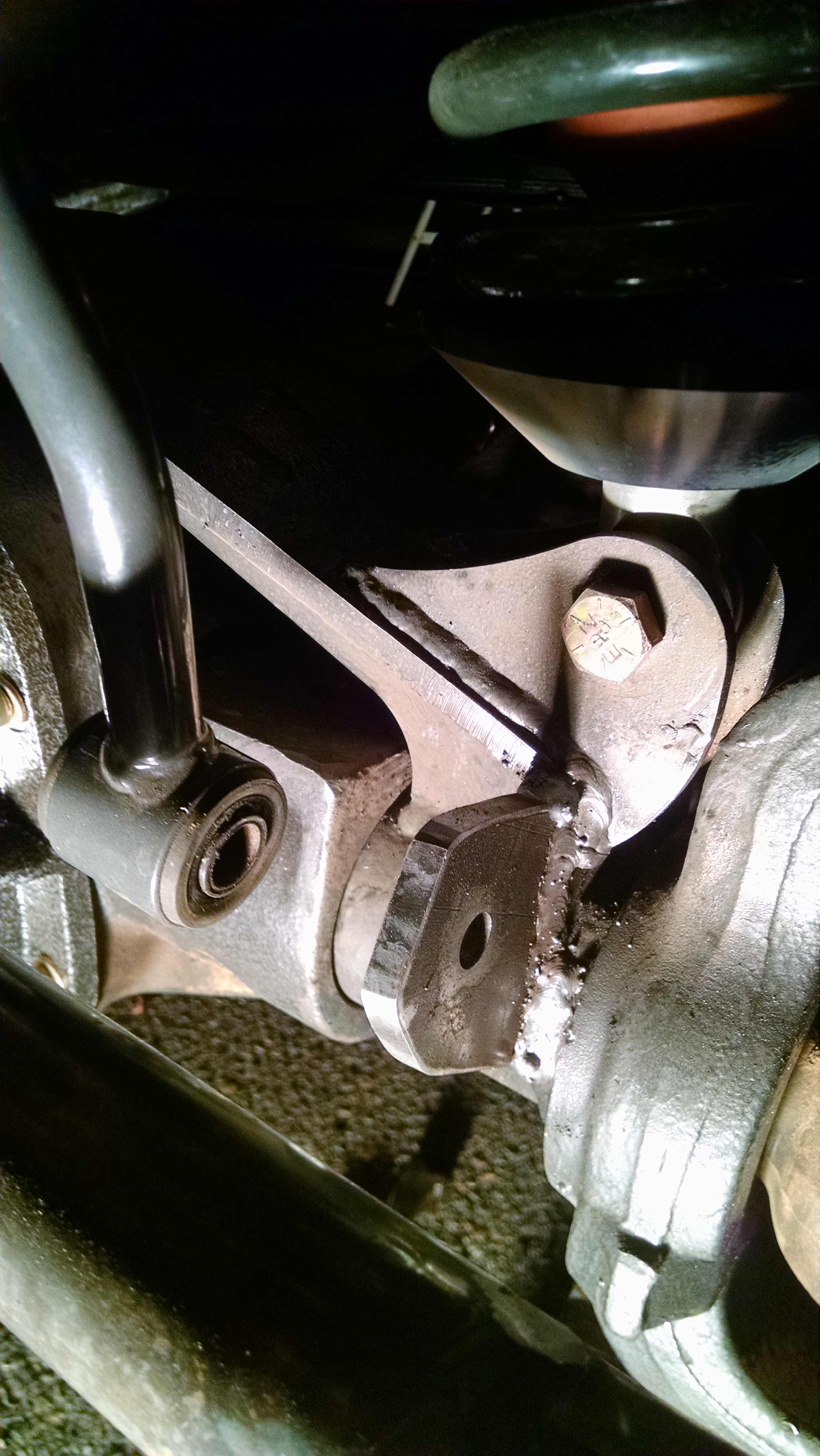

I also cut out tabs from some 3/8" plate. Drilled the holes for my existing sway bar links. Got driver side fully welded on in the dark. Passenger is tacked and will finish tomorrow.

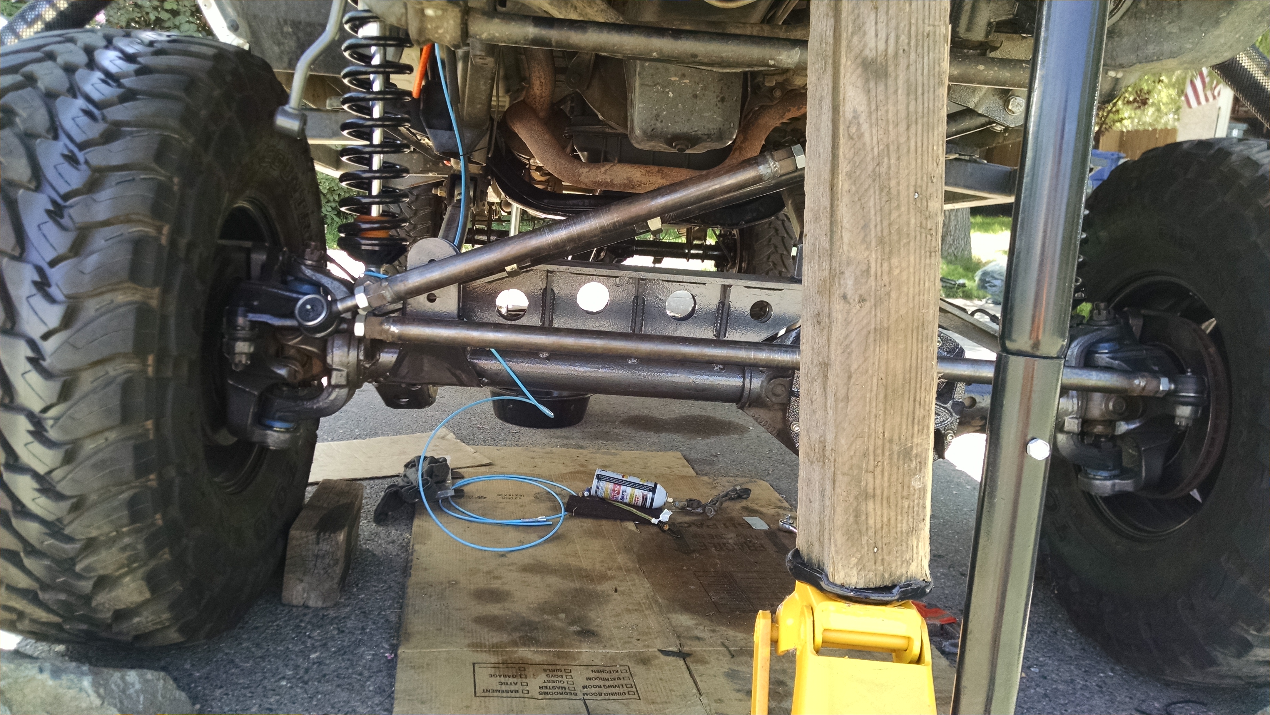

Got alot done today
Done --> Rear brake line on axle
Done --> Rear brake line feed
Done --> Rear shock mounts
Bleed Brakes
Done --> Front brake lines, T junction
Grease locking hubs
Transfer Case
Done --> Assemble shifters for 241 and BB
Oil in BB and check 241
Front axle
Done -> Check alignment, position, toe-in, and steering wheel
Torque all fasteners
Done -> control arms -- 140 ft lbs
Done -> track bar -- 130 ft lbs
shocks
Done --> Determine Sway Link tab location
Determine shock reservoir mounting location
Steering
Done -> Torque all TREs --70 ft lbs
Done -> Install cotter pins
Done -> Torque pitman arm @ draglink -- 70 ft lbs
Done -> Torque pitman arm on gearbox -- 185 ft lbs
Add Tranny fluid!
Design crossmember
Diff fluid
ARB hookups
Breather tubes
Charge shocks with N2
Should be driveable Friday...
Cleaning up tonight...got friggen spooked!!
About 3 fingers thick. Biggest one this close to the house. Just weird he worked his way up there while I was working, making all kinds of noise. Buddy came over to help with his BB gun. That didn't take him all out b/c his shooting sucks. lol But was enough to reduce motion to shovel him.

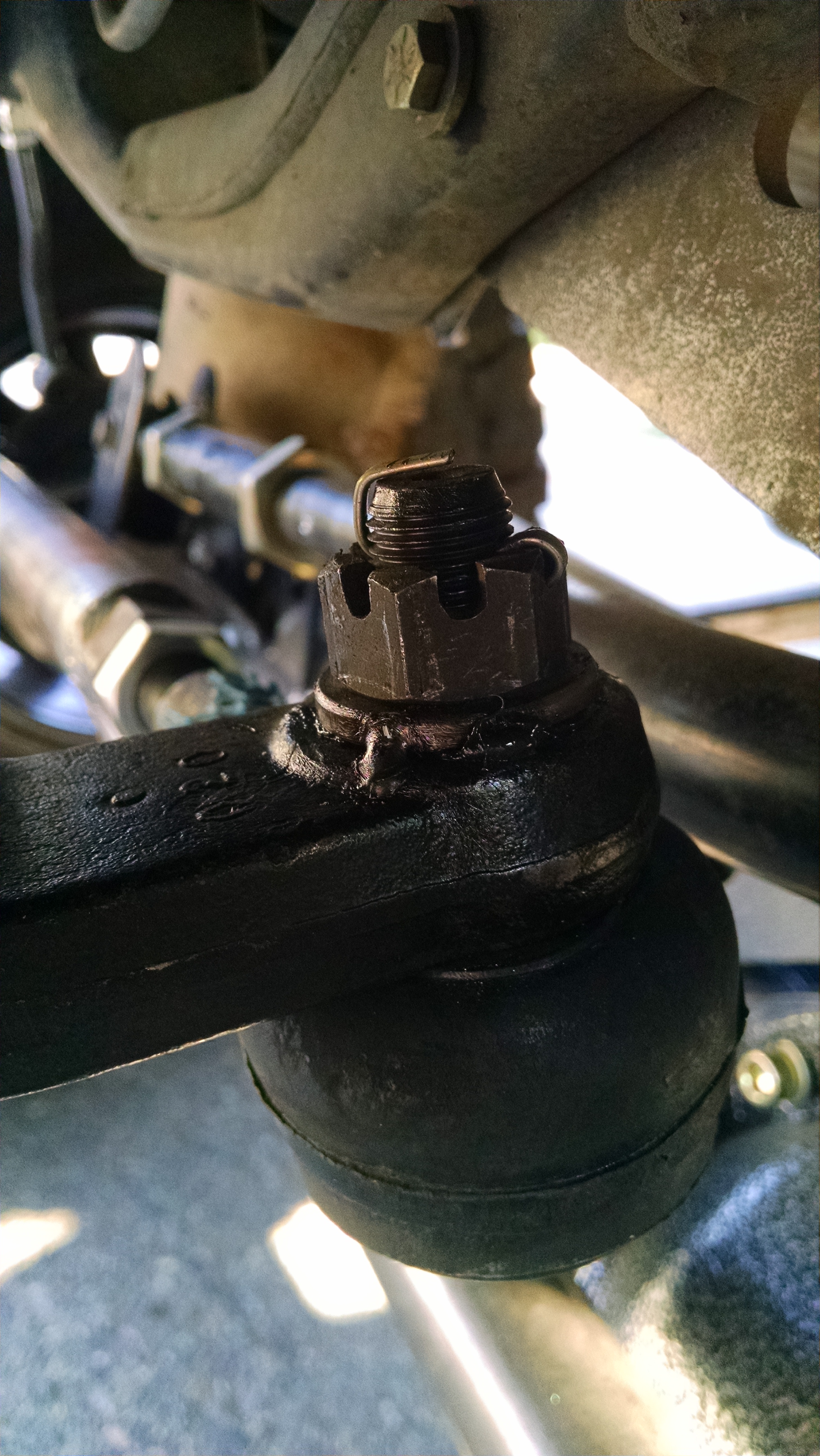

Yea cool big *** snake good job.
Look at that cotter pin, aren't you fancy lol.

See the tack weld near the cotter pin?
I'm down to the last darn 1%

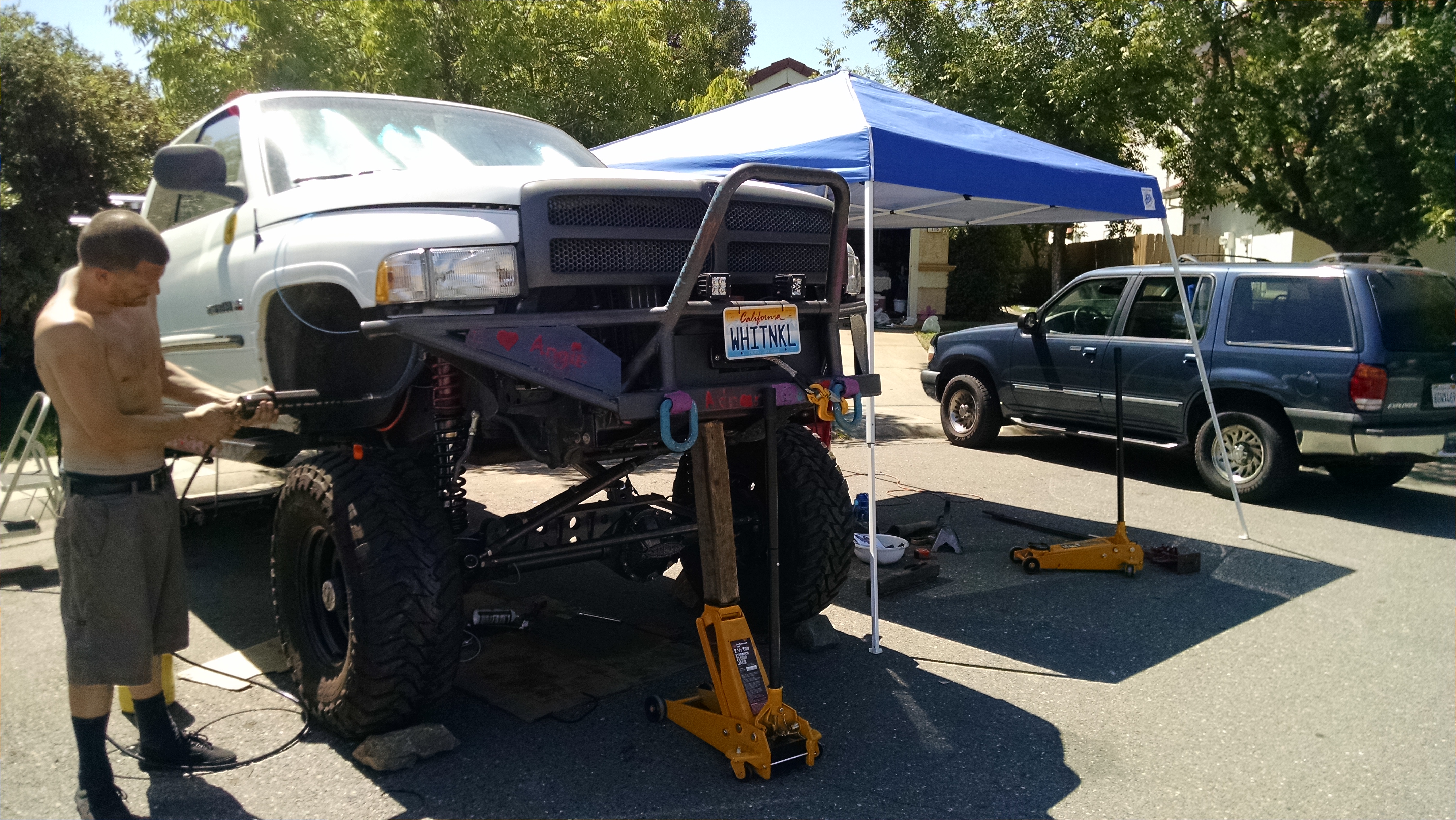

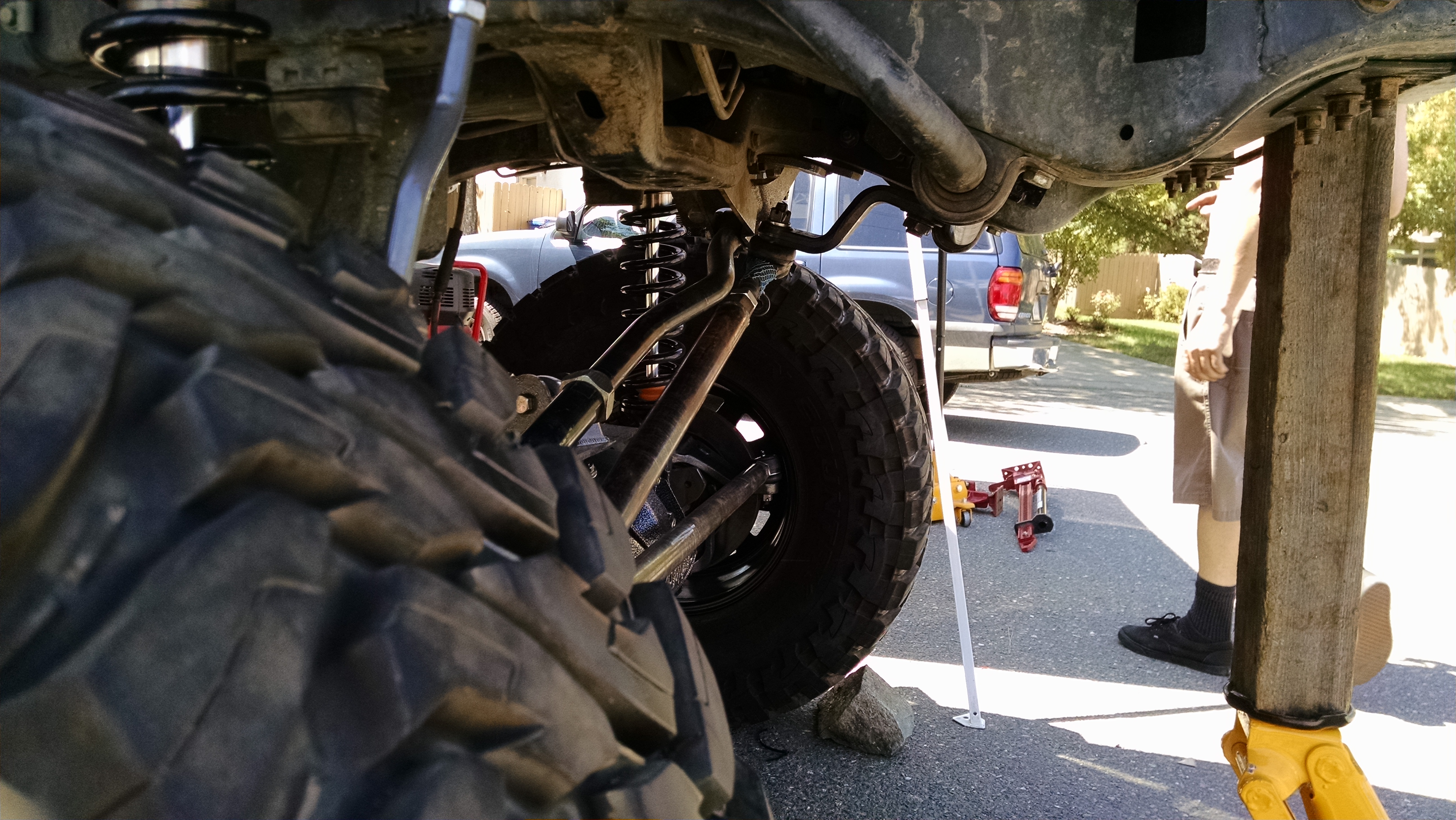

Here is the shock charging session
Steering appears spot on....
Charged to 250 psi to start. It added 2" of lift.

I didnt see any tack weld near the cotter pin?
