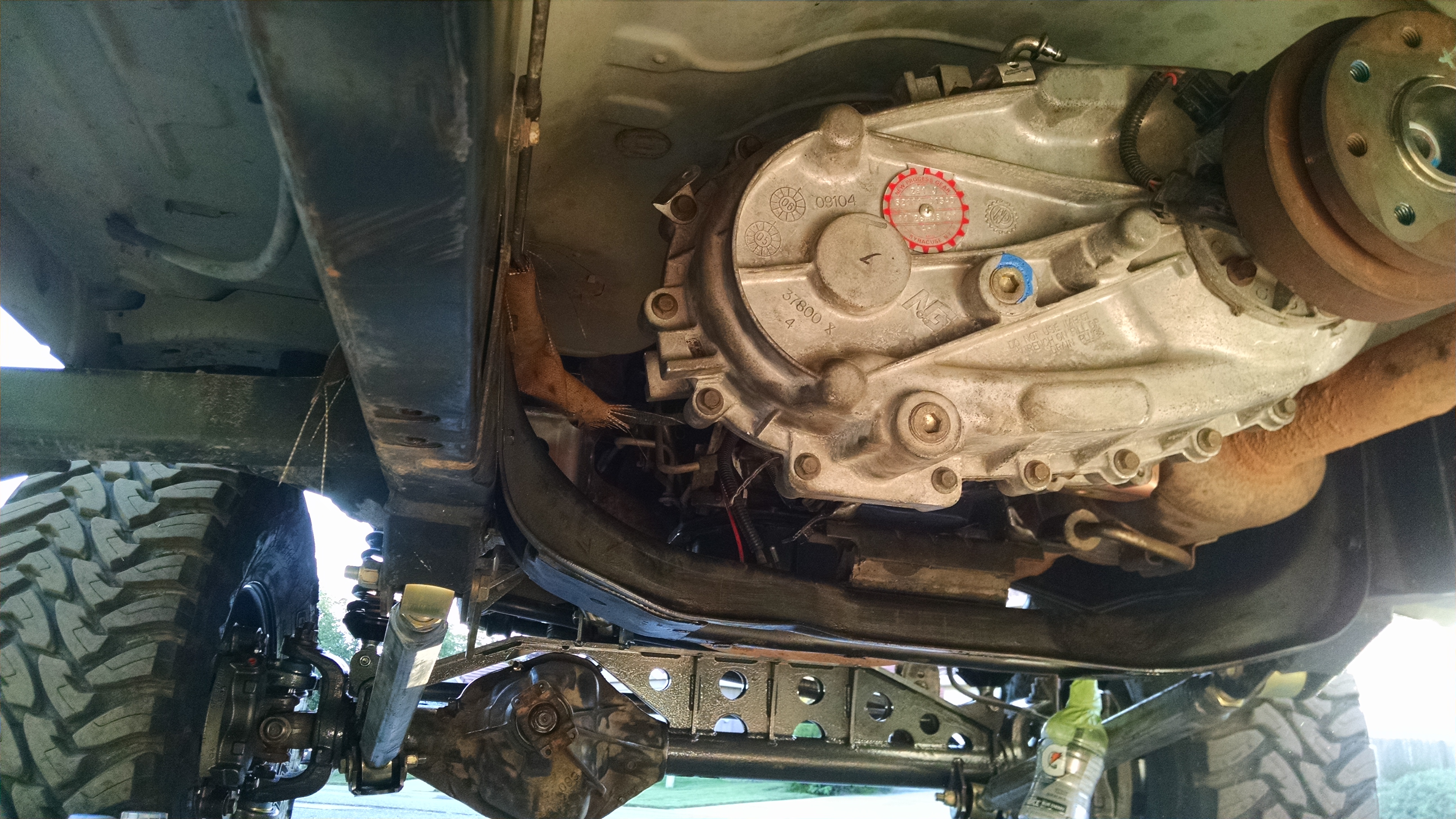

Setup at home and pulled the tried and true 231 tcase tonight.
Link to thread on the seals for input.
https://dodgeforum.com/forum/2nd-gen...case-seal.html

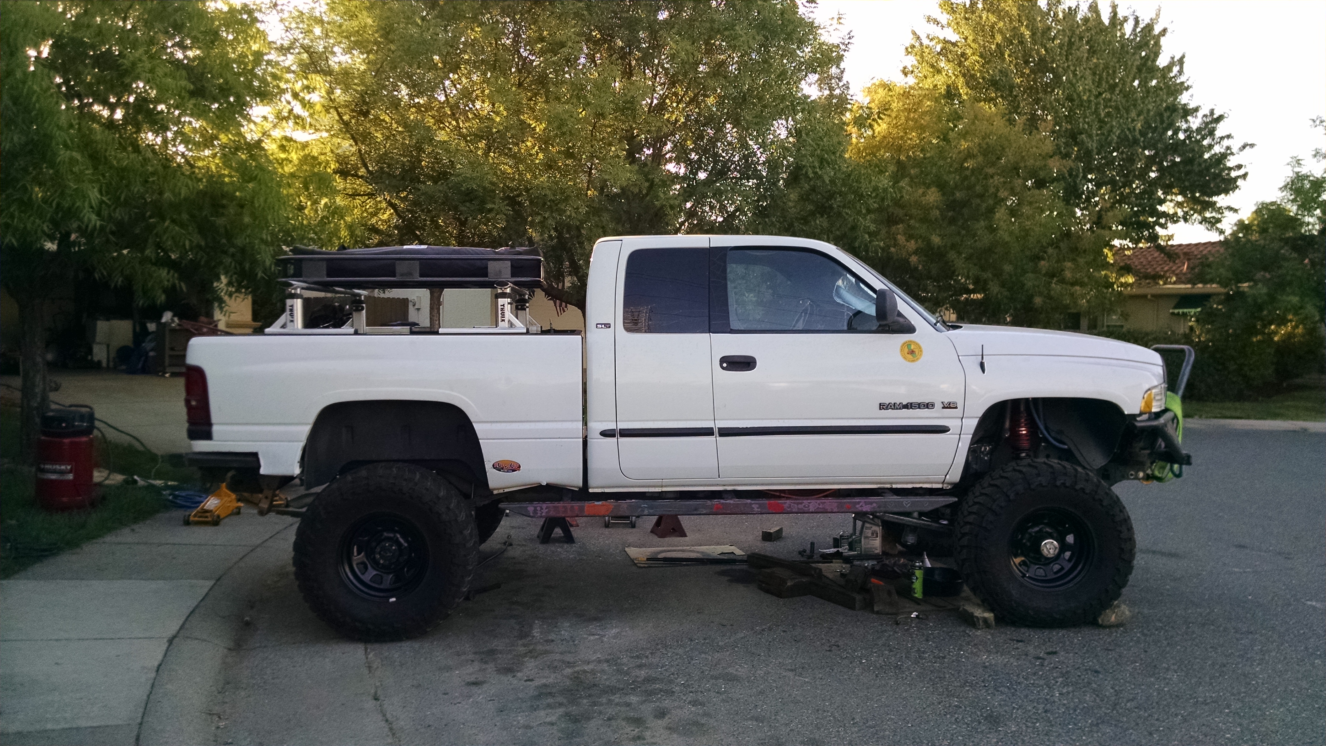

Default Rear Dana 70 is in
Thanks...it's a moving so close to the end....
So roughly 3.5 weeks to get to this point!
Sitting on both axles now. Rear came up a bit as expected b/c the aftermarket perches are about 1" taller than the ones on the Chrysler 1.25". My culdesac has a crown to it though too.

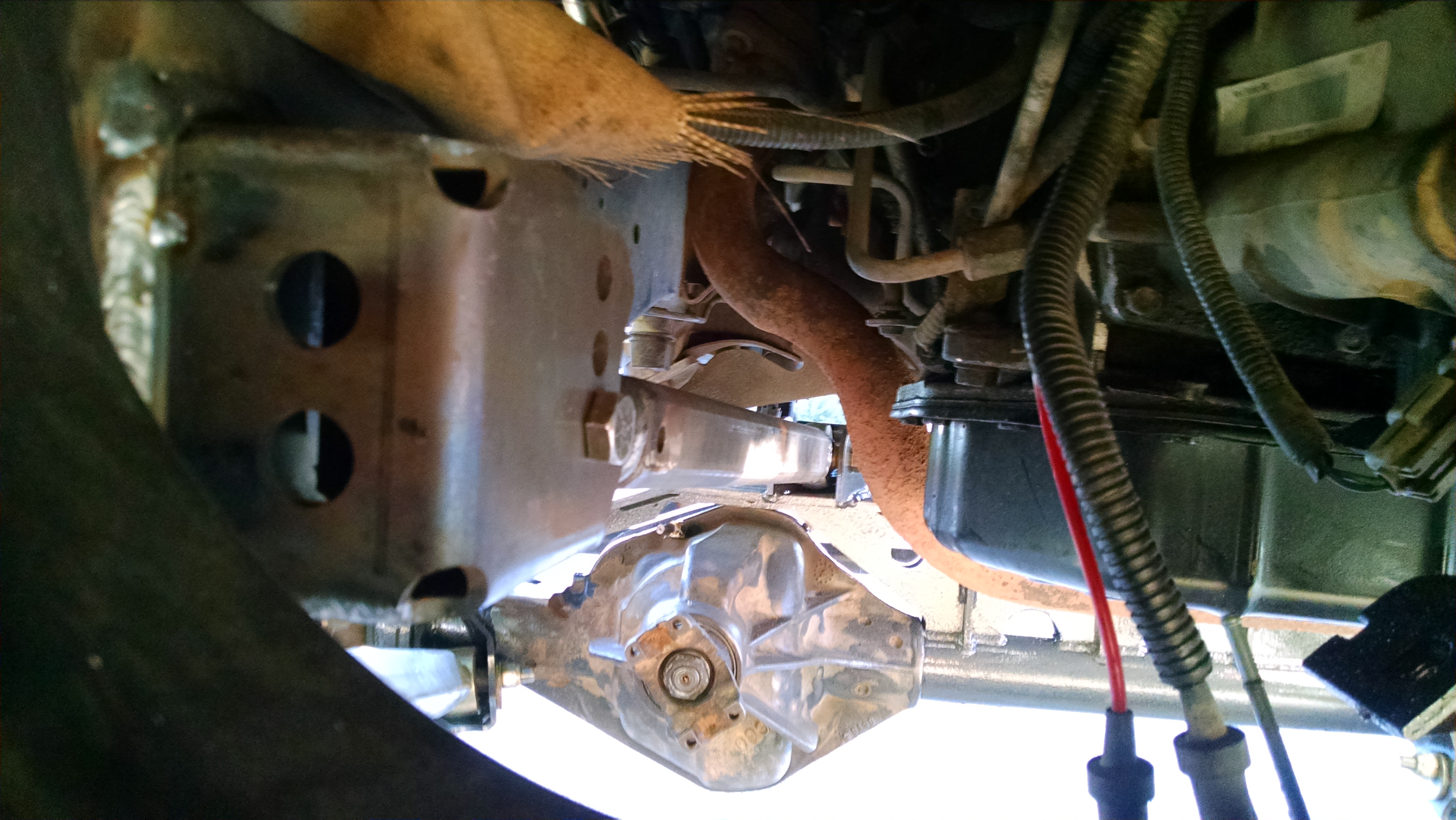

Set pinion angle to within 1*. Perches are hard tacked. Driveshaft ordered and ready Monday. Plan is to pickup, install, and drive back to have them double check the angle. If needs a change, then easy to grind off and then full burn in.
Tcase all mocked up for the above setup. Today hoping to pull out and final mount to be done.
