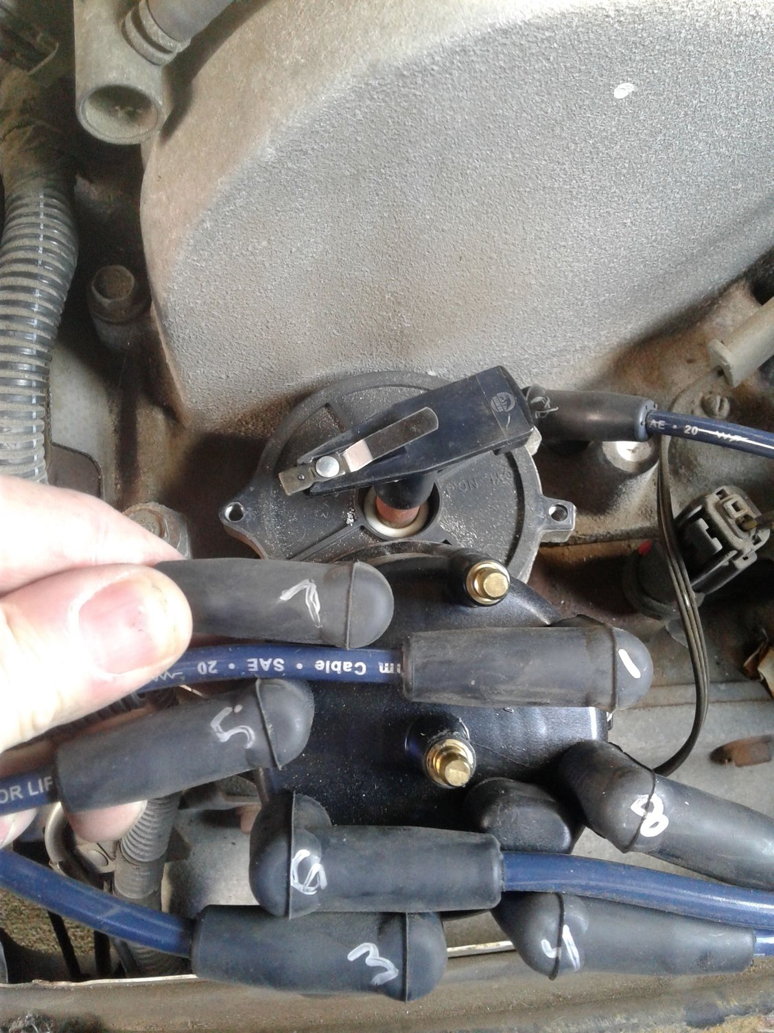

Does this look right, the marks on the harmonic balancer are lined up, shouldn't it be facing 180 degrees from what it is to line up with number one cylinder
Old Oct 2, 2021 | 10:31 AM
Posts: 87,480
Keep in mind, the marks will line up twice per one revolution of the rotor. Verify that #1 is at top dead center, on the compression stroke. Looks more to me like it's point at #6 in your pic.
Old Oct 2, 2021 | 10:53 AM
Eddy67's Avatar
Eddy67
Joined: Sep 2021
Posts: 61
Number one is TDC not sure what stroke
Old Oct 2, 2021 | 10:54 AM
Eddy67's Avatar
Eddy67
Joined: Sep 2021
Posts: 61
yes it roughly between 5 and 6
Old Oct 2, 2021 | 11:02 AM
Posts: 87,480
Are both valves closed on number 1? Try blowing some air into that cylinder, see what happens.
Old Oct 2, 2021 | 11:25 AM
Eddy67's Avatar
Eddy67
Joined: Sep 2021
Posts: 61
yes there closed, pressure built up in the cylinder
Old Oct 2, 2021 | 11:34 AM
Posts: 87,480
Distributor is 180 out then.
Old Oct 2, 2021 | 11:38 AM
Eddy67's Avatar
Eddy67
Joined: Sep 2021
Posts: 61
Does it make sense that it would still run?
Old Oct 2, 2021 | 11:59 AM
Posts: 87,480
It shouldn't. I would more expect to have it backfiring, and make all sorts of rude noises. If the engine runs, then timing is at least close.
