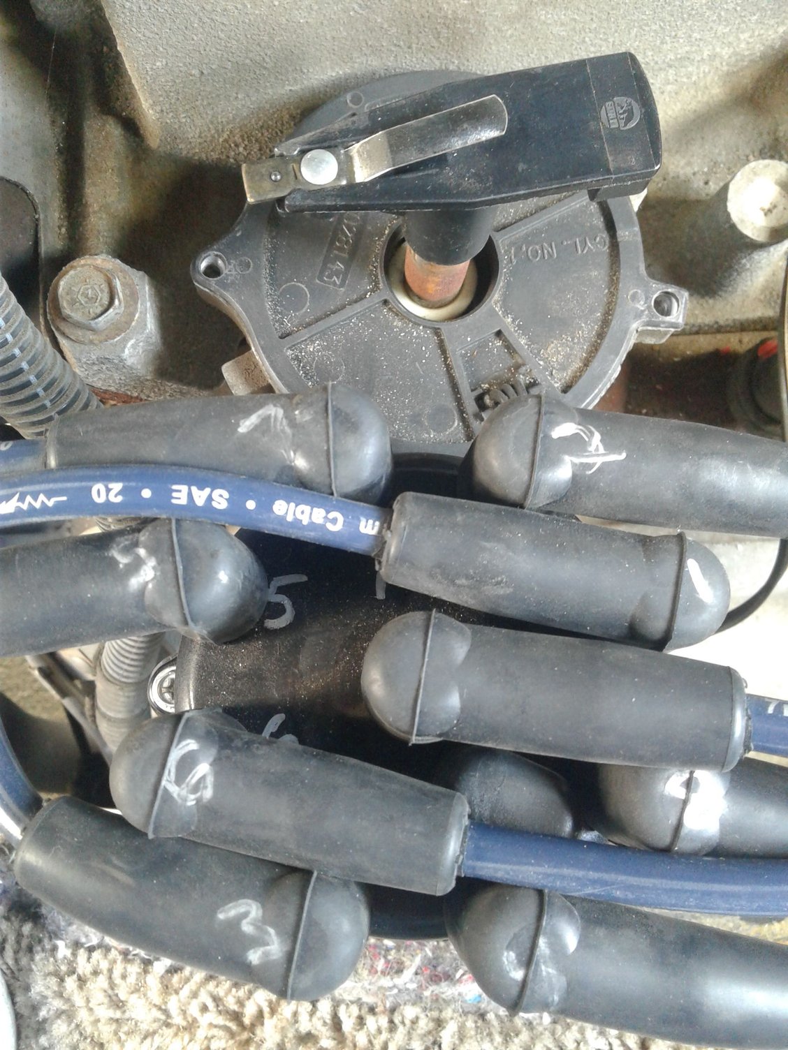

Heres a pic of it you can see where it says cylinder number 1, yet it was 180 out, what is going on with this thing?
Old Oct 3, 2021 | 10:22 AM
  #24
Eddy67's Avatar
Eddy67
Joined: Sep 2021
Posts: 61
the engine has been turned over since I put it at TDC, I guess I can do it again

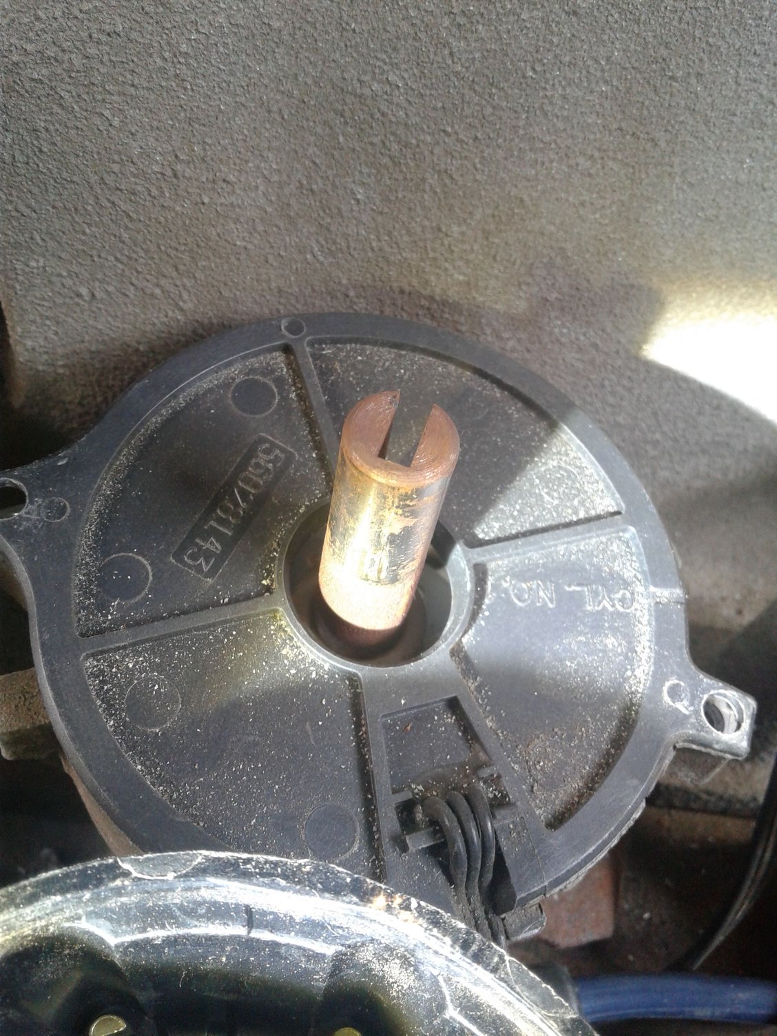

so here it is again, piston 1 at TDC I blew air into the cylinder, pressure built up and blew back out at me when I removed the hose, as you can see its facing the wrong direction, yet if you look at the firing order its set up with number 1 cylinder at 180 from were the rotor points, again it runs but it bogs down when i first hit the gas pedal then revs up

Reset everything. If you have to, pull the distributor. Make DARN sure #1 is in firing position.

I suspect what is happening is, the computer is firing the injectors 180* off. PCM doesn't need the cam position sensor, once the engine is running, but, it sure needs it to start the engine.

Likes: 578
If you look at how the cam sensor works it only tells the pcm where 4 of the 8 cylinders are. But the pcm needs this info other wise it doesn't know when to fire the coil/injectors. With it 180* out it's firing the wrong cylinders. Pull the distributor put it back in 180* it should fire right up. You may have an issue getting the distributor to drop into place with oil pump drive. Get it where it belongs and if it doesn't want to go all the way down slightly turn the crank until it goes in.
