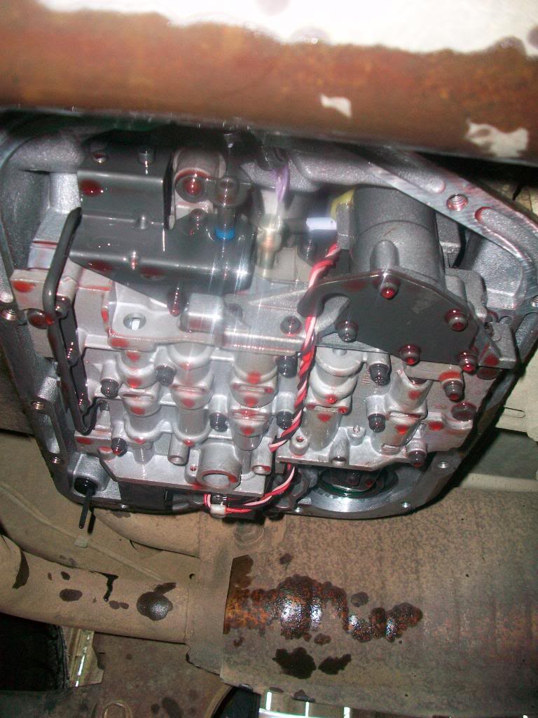

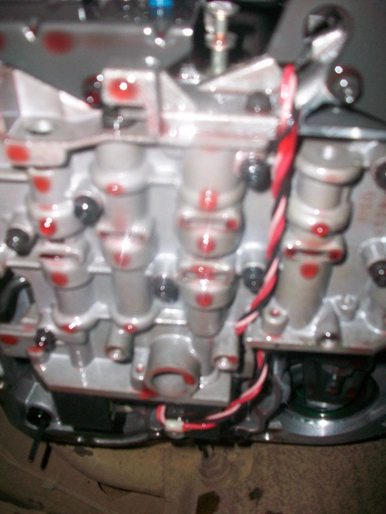

MONTEC, does it look like my tranny was rebuilt? this is 24K after the rebuild....PO had it rebuilt, i saw recipt....just wanted to make sure the whole thing was rebuilt. and this is the first tranny flush since the rebuild...fluid looked good for 24K.....truck has 202K, this looks to clean to be original....just would like a second opinion

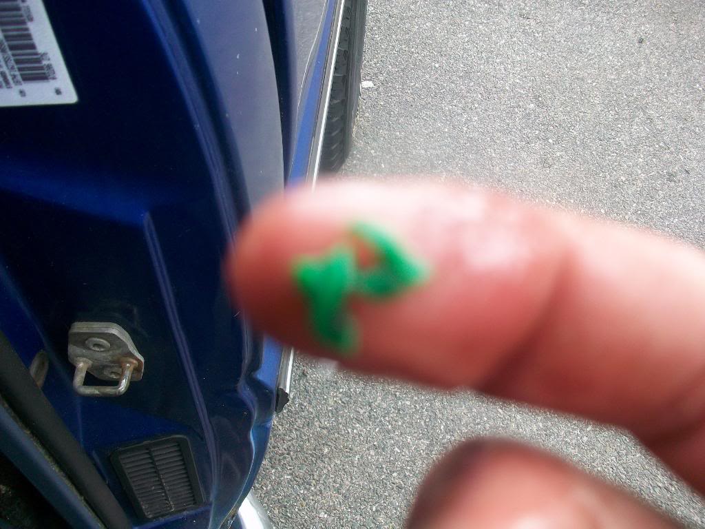

AND THE GREEN TWIST I TOLD YOU ABOUT....
Doesnt look bad. It was either really well maintained or rebuilt. When you said "TWIST" i thought of a bread bag twist. What you have there is a "zip tie". That zip tie holds your internal wiring harness together. Your mystery twist is a factory zip tie, no big deal.
