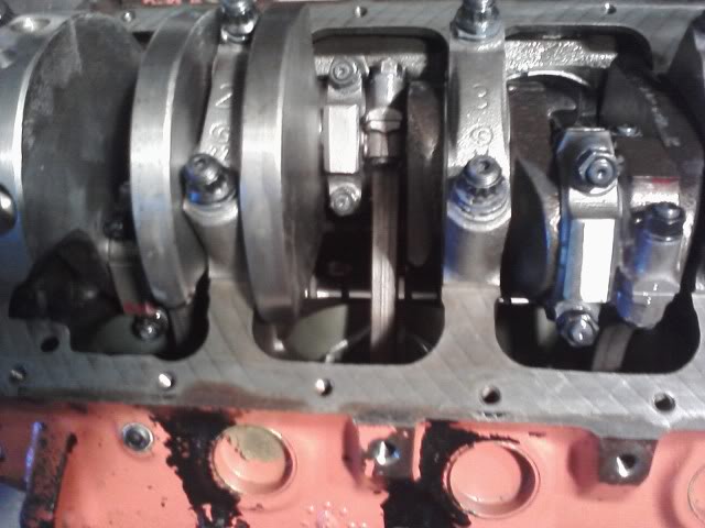

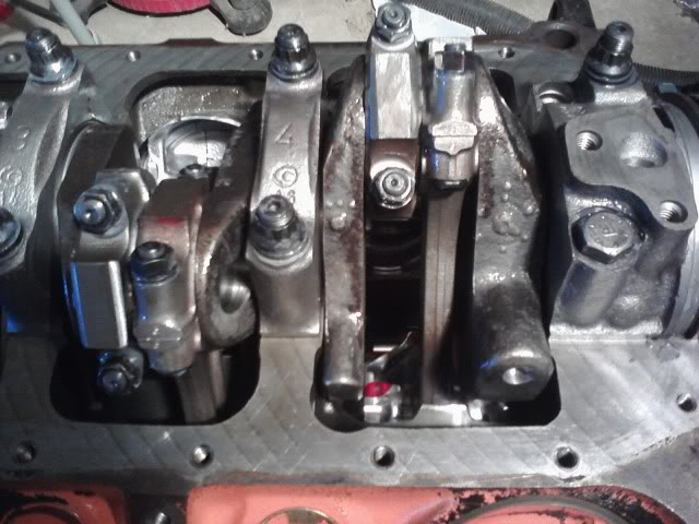

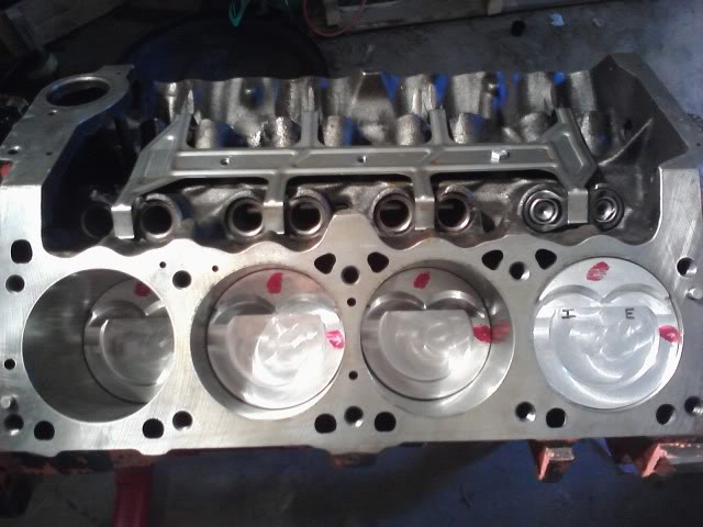

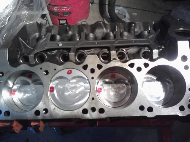

PICS!

i think he put the stud on the rear main on the wrong side...

Hell, order up the entire upper engine gasket rebuild kit from www.rockauto.com and save yourself about $50. It'll have the correct felpro headgaskets with it, plus just about everything else you need to reassemble a short block. Take the other gaskets back to wherever you got them form if you already bought them.
Remember, once a headgasket is compressed, there's no reusing it, so be sure you're done with everything head related. I'd torque them in at least a 3 step sequence following the FSM, and then check them every 10-15 minutes to see if they'll take any more torque. Mine took 5 times before the last bolt stopped taking torque and settled in.
Whats the problem with the rear main? Don't see anything out of order on the pics you have posted. Show a pic, or it didn't happen.
I'd seriously consider turning the crank over a time or two to make sure every single rod arm clears the bottom of that block. Best to know now. Not sure what the proper procedure is for lubrication in that instance, maybe someone else could chime in.
I foresee a tranny rebuild in your immediate future, muhahahaha!

the block was grinded for rod clearance during the initial build, it rotated just fine the last time it was assembled.
when i took it apart a while back, the bolt in the rear main was where the stud is now, and vice versa.
