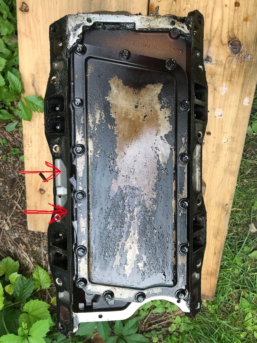

Like an idiot, I drilled all the way through a plenum pan hole on intake after it stripped, thinking I cld put a wing nut on the inside to hold the bolt on. Bad idea, then I fixed threads, got a tight bolt in there and put some black gasket maker on bottom of hole, under bolt. Had no start problems ever since.
Could this be the reason and do Ineed to replace the intake manifold no matter what or wld the bolt being tight give it an airtight seal? Thanx for any help guyz.

A vacuum leak won't give you a no start, I suspect you didn't plug something back in. Cam sensor in the distributor, perhaps? Are all the grounds back up by the power steering pump?

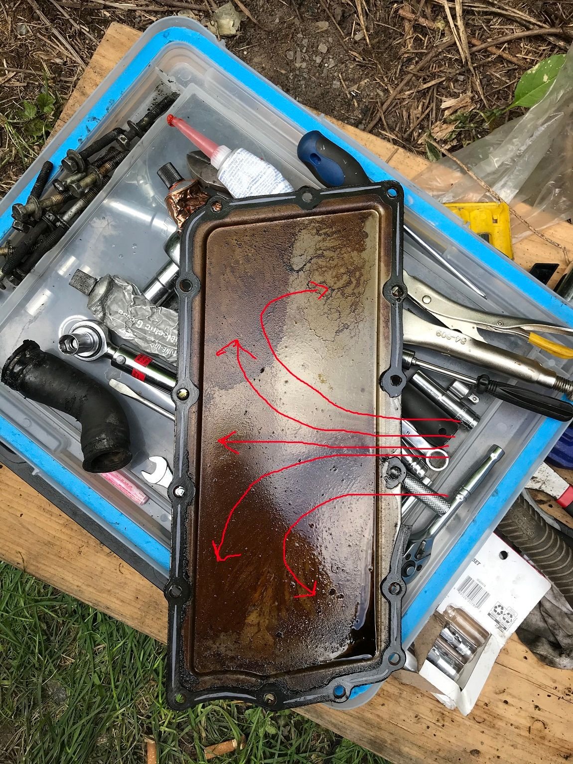

Finally got around to doing the intake plenum gasket repair on muh 96 Dodge Ram 2500 5.9 V8 two wheel peeler. Used an aluminum replacement plate I bought off ebay, a Fel Pro gasket set from RA and a couple of parts from a Dorman kit I had also purchased. I'm not going to go into minute details as the procedure is well documented here. The process took two days under the shade tree. Everything came apart pretty easy with basic hand tools. To be honest the biggest PITA were the electrical connectors. After 120,000 miles and 24 years they had sealed up pretty good, but I managed o.k. Broke the connector for the engine coolant temperature gauge sender clean off, but stuck it back together with some RTV and it still works (ordered a new one from RA just in case it does quit). Everything went back together pretty easily too. Started it up and had a misfire due to switching a couple of plug wires, but after remedying that the truck runs like new. No more surging at idle, and hopefully no more oil consumption I'll attach a couple of pics I took of the blown out gasket where you can see that I was getting a nice, even flow of engine oil for the burning. Thank you to everyone for the info here. It's priceless.
P.S. While the service manual is awesome for torque specs/sequence and whatnot, the procedure for Intake removal is def. over simplified. I could not figure out how to take the intake out with the throttle body still attached. The cable bracket prevents this. The rest of the intake came out as a unit after a couple of thunks with hammer and wood block.. I also did not remove the fan shroud or radiator as many have done. After removing the bolts for the generator and AC mounting brackets and disconnecting the electrical connectors for both, I had plenty of room to very gingerly twist the whole assembly off to the passenger side of the engine compartment, being as gentle with the AC lines as possible.

You just remove the cables from the canoe bracket and you can take it off with the intake

4 steel bolts vs. 24 year old plastic clips... I'll take the bolts and leave the plastic alone.
P.S. i was scared to death the plastic ends on the cables would crack when I took them off. They did not... thank goodness. Hopefully I will never have to touch any of the plastic parts on the intake again.
P.P.S. ... and how about 12 Ft Lbs. on the main intake bolts? I don't know jack about intakes, but after torquing them in sequence for the second time... I don't know... It just did not feel like it was gonna be enough to hold the thing down. It works but it felt weird leaving it like that.

That's what I used and it is holding fine
