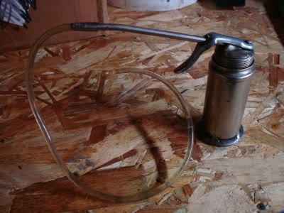

i used this little pomp to push the oil in for the wet test,
and i press about 4 times on it,for the oil to go in,maybe is little more than one teaspoon i guess...
