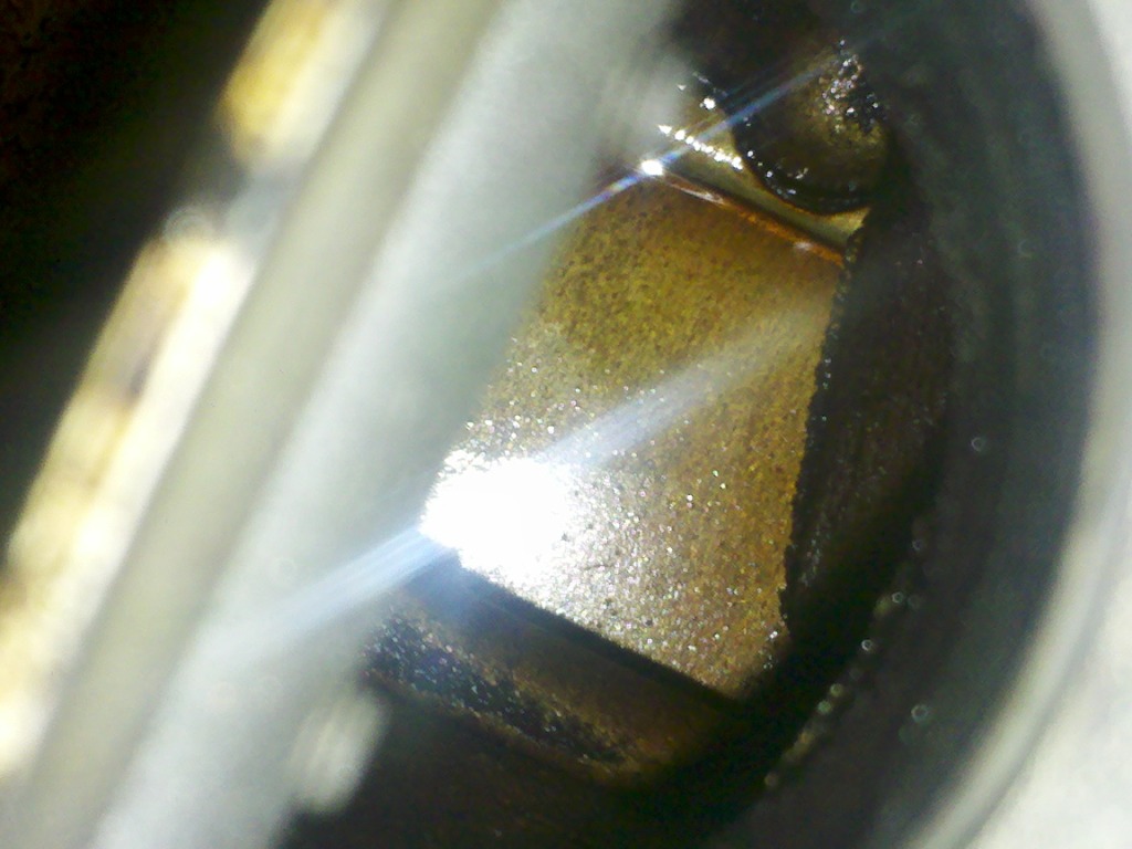

I just finished reading this thread&I do burn a little bit of oil but I just noticed the valve cover os leaking&maybe the intake for there is a spot of oil on the block by h20 pump.Ill relpace vc gasket&then see.Anyway Don't think I have spark knock but I have tinnitus so I cant hear much.Im not throwing any codes,but figured Id look in the throttle body while I was there.Now I looked in the pic thread fir the plenum but mine looked pretty clean but it did appear to be a drop or 2 of oil so what do you think?Heres a few pix but they kinda suck

That second pic tells the story of what the inside of the intake manifold should look like when you have a blown belly pan gasket. Sorry but it's time for the fix.

Yeah when I saw it I was hoping I wouldnt have to but I kinda Knew it.Well atleast I know where my mpgs disappeared to.Im wondering if this is also why my hvac has been acting funny?I cant seem to find a vacuum leak anywhere.Well off to watch the youtube vids on it.
