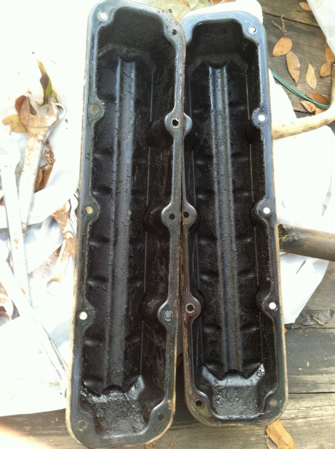

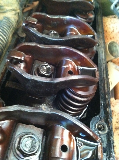

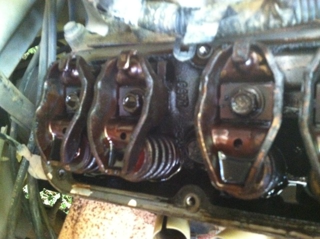

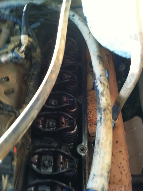

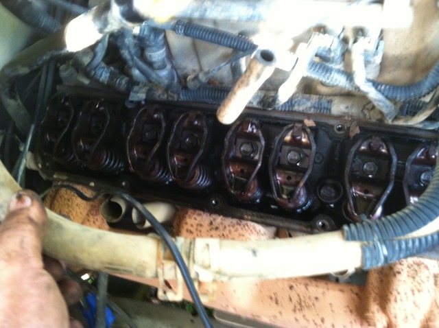

I got the valve covers off today. Thers no water up there at all I can see. They do look nasty dirty but nothing out of the normal but I did notice a lots of the bolts weren't tight. I never thought about them coming loose. I am going to pressure wash the covers real good and get them as close to clean as possible. Thats one thing good about having a pressure washer.

I hope the pictures come out good and you can at least see what I am seeing. They look fine with no water and the springs look fine. Im thinking that once the head gasket is fixed, I should see good compression. Tell me what you see other than nasty valve covers.
Well, I see rockers and valvesprings
