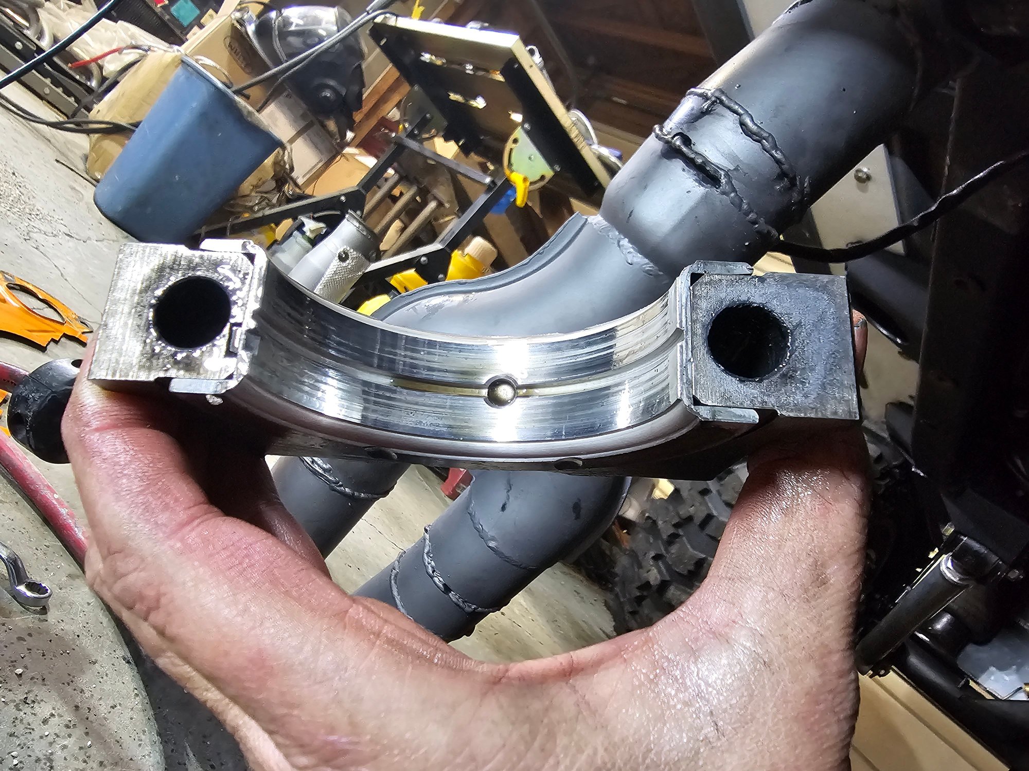

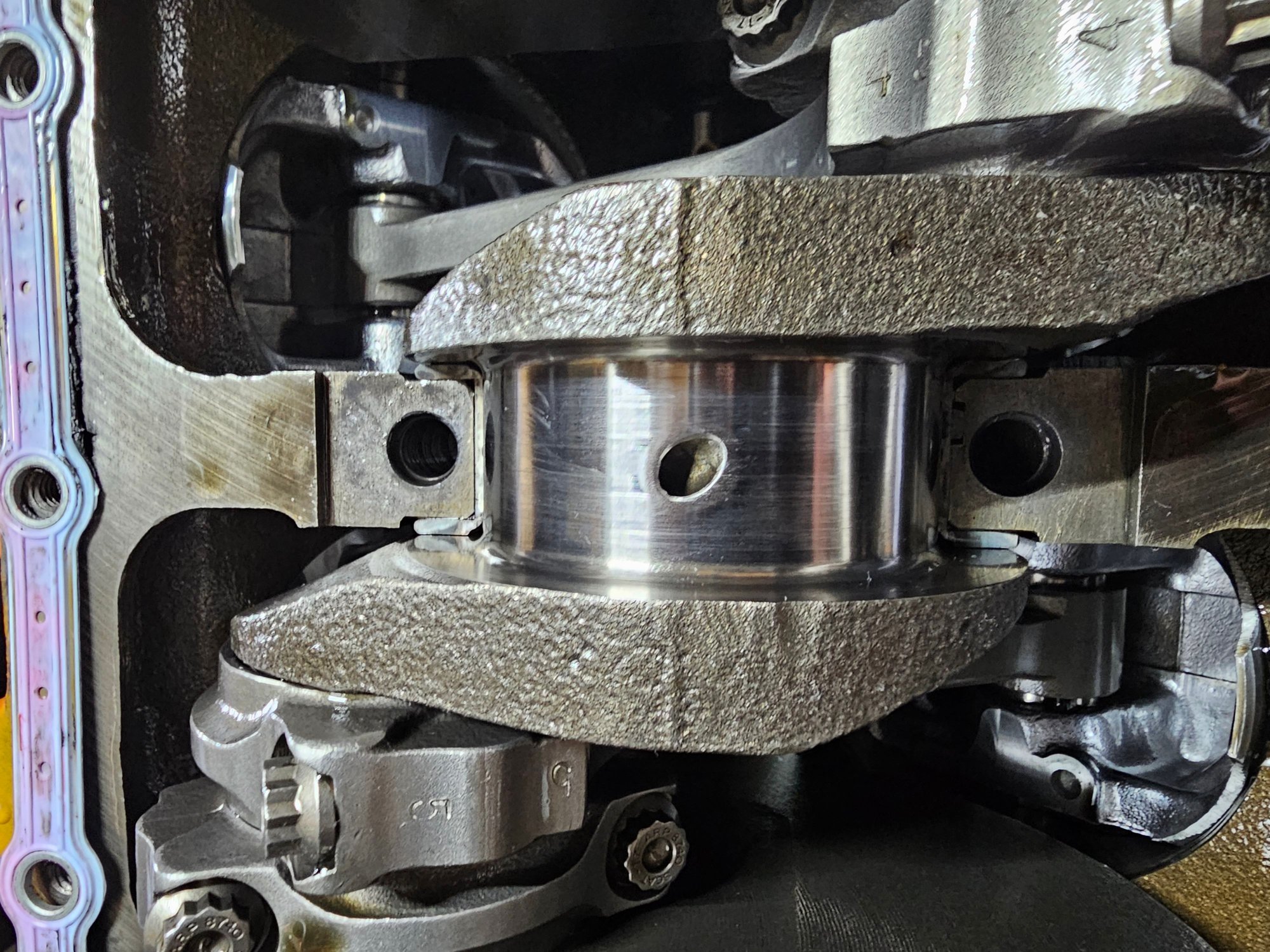

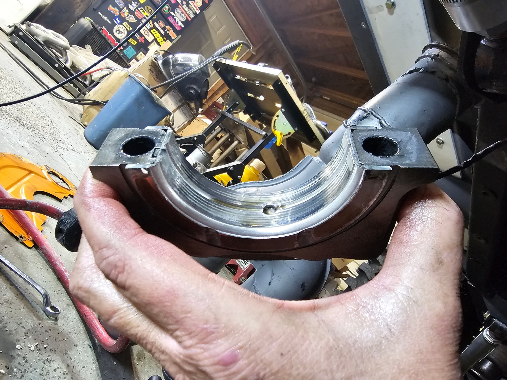

Here's the #3 main bearing. The bearing surface is smooth even though it doesn't look that way in the pictures.
Tried to get a different angle..
Crank journal.

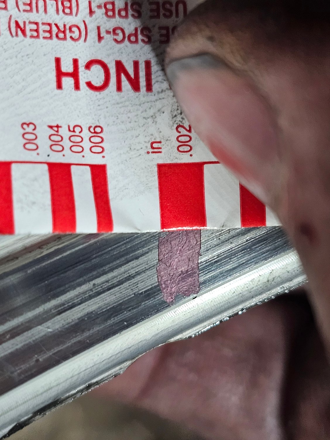

I didn't have any Green plastigauge left.
@ .002 it's still within tolerance for clearance. It was a major PITA to get that main cap retorqued again so I didn't pull any of the other caps.
