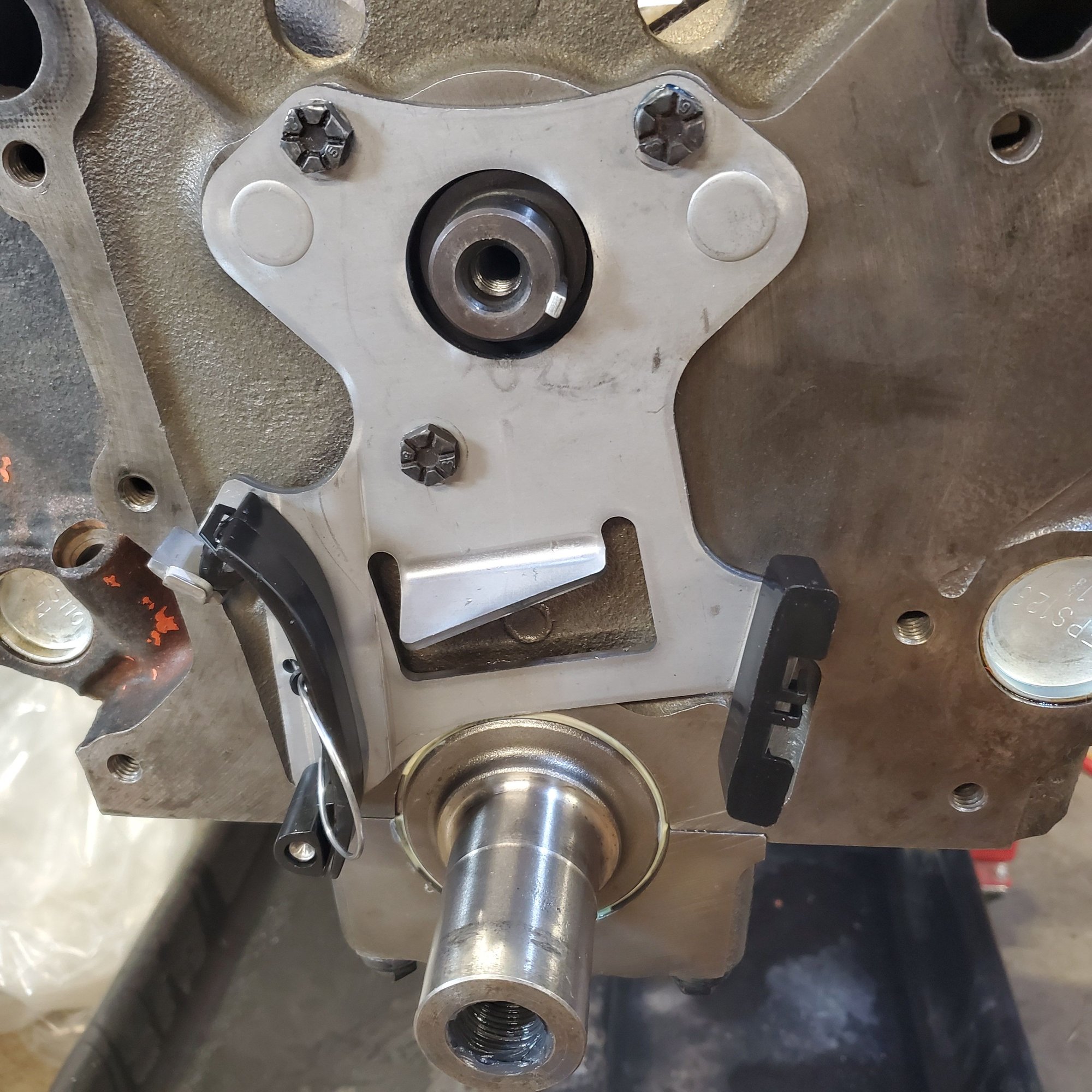

Do you have the engine out? If so, pull the timing cover, and have a look at the front of the block. If I am reading things correctly, the cam retainer plate *should* be covering the holes for the lifter gallery oil passages..... Is that indeed the case? Could pressure be leaking around that plate?
No the engine isn't out. And yes I remember those holes but don't remember what I did with them. Will have to look at some old pictures and see if I have any of that area.

Here are those two plugs in the holes.
I'm not seeing them coming loose but anything is possible.
And the timing plate over them.

HHhhmmm... yeah, I tend to agree, I don't see those plugs coming out, especially with that plate on there. That's just odd.
