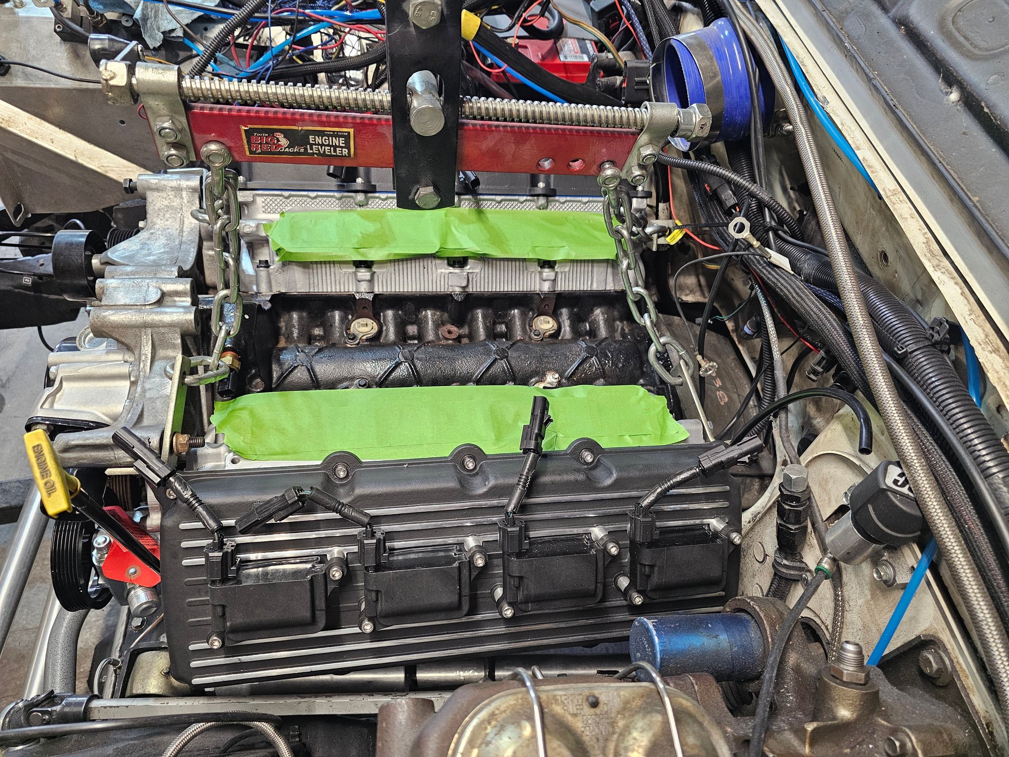

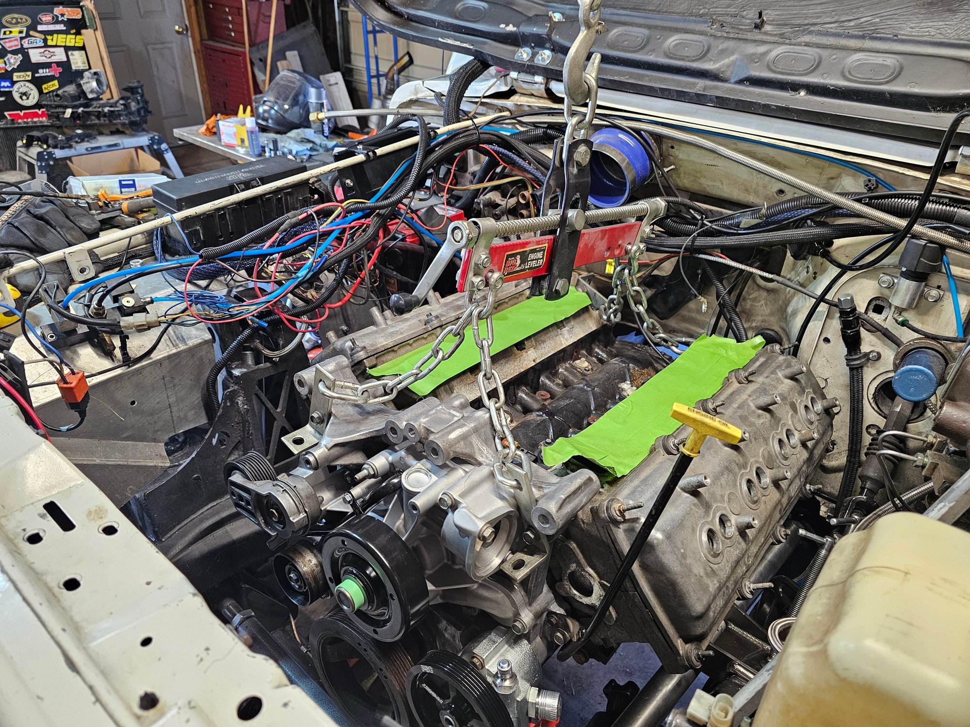

Initial test fitting of the engine with the heads installed.
Added the transmission to the mix.
Getting all pretty... That Hemi don't look bad.
Going in for the last time I HOPE.
Fun City.

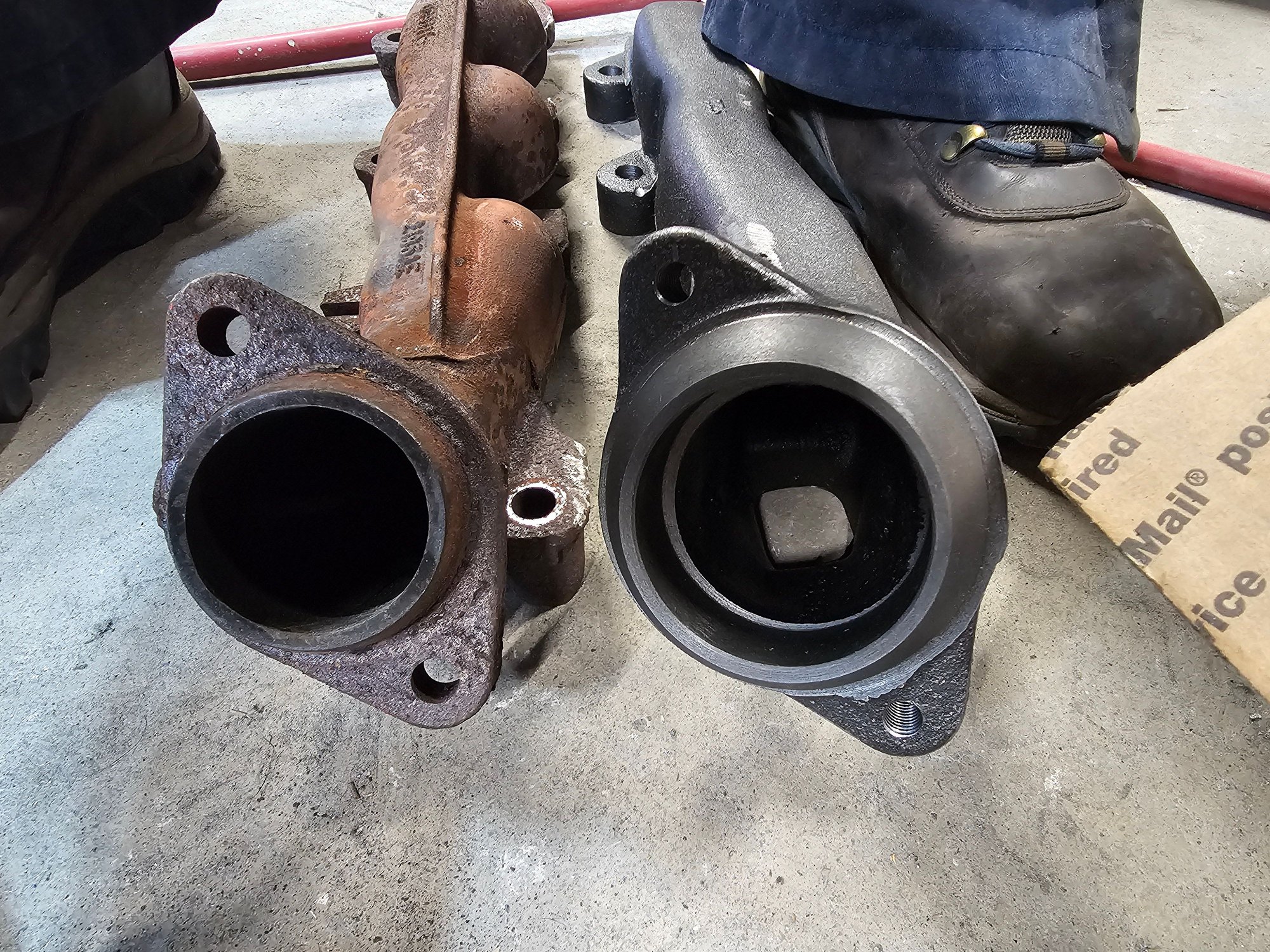

Added some performance parts. The engine is a 2003 model so I upgraded to 09 & later Eagle heads & then went from a 80mm to 87mm throttle body.
Left exhaust manifold is a 03-08 pre-Eagle & Right is a Eagle manifold. That thing should breath pretty good even if it isn't a header.
