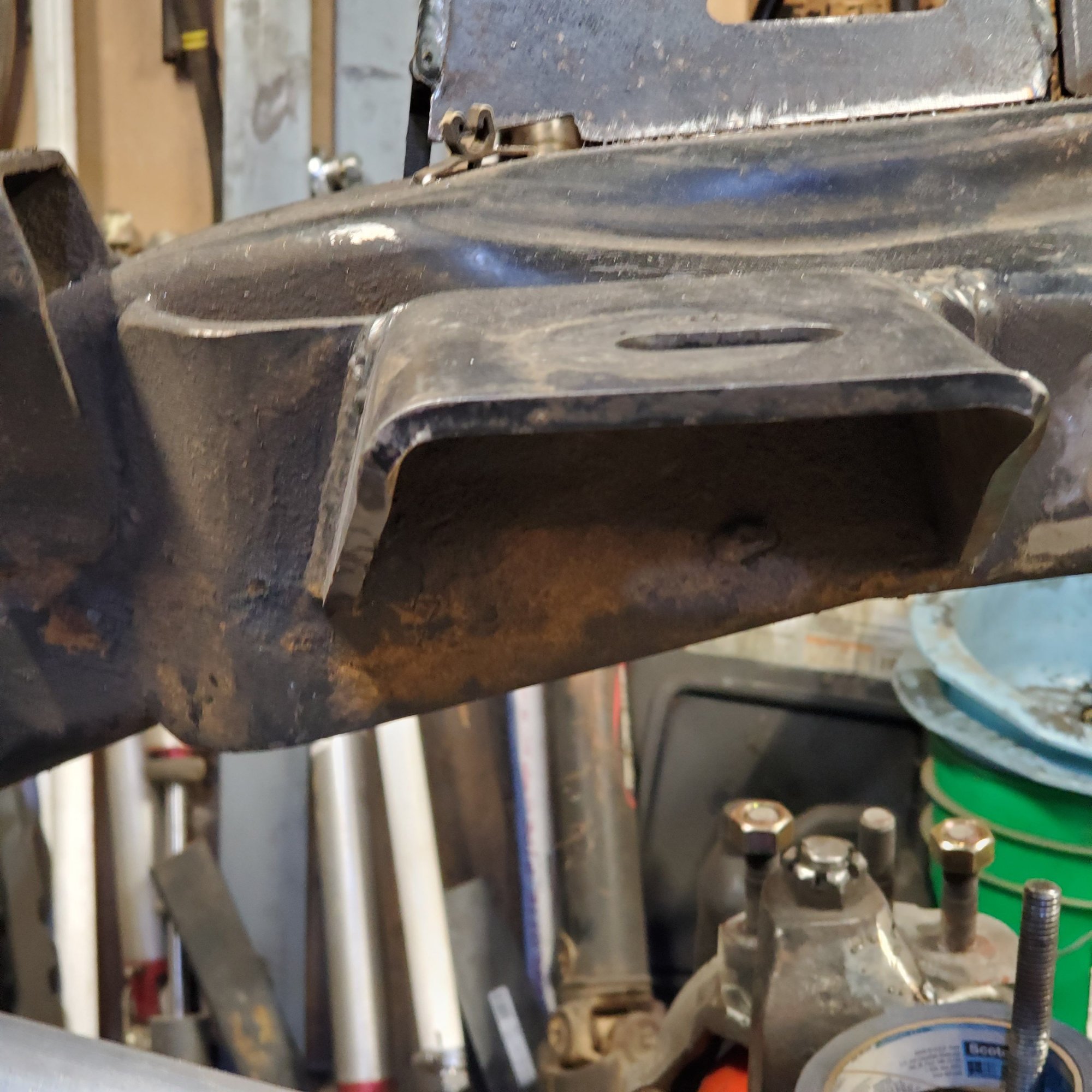

The pictures of the drivers side are with the axle at what my full bump will be. I wanted to make sure that upper link would clear where ever I put that brace/mount at.
What about at full articulation?
I've got to cycle the axle once more to make sure everything clears. But the last time I cycled it it all cleared.

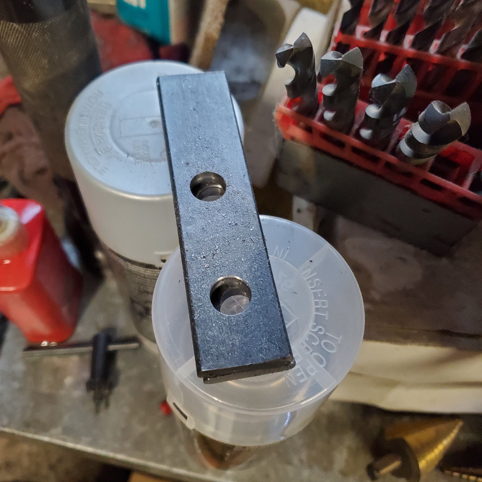

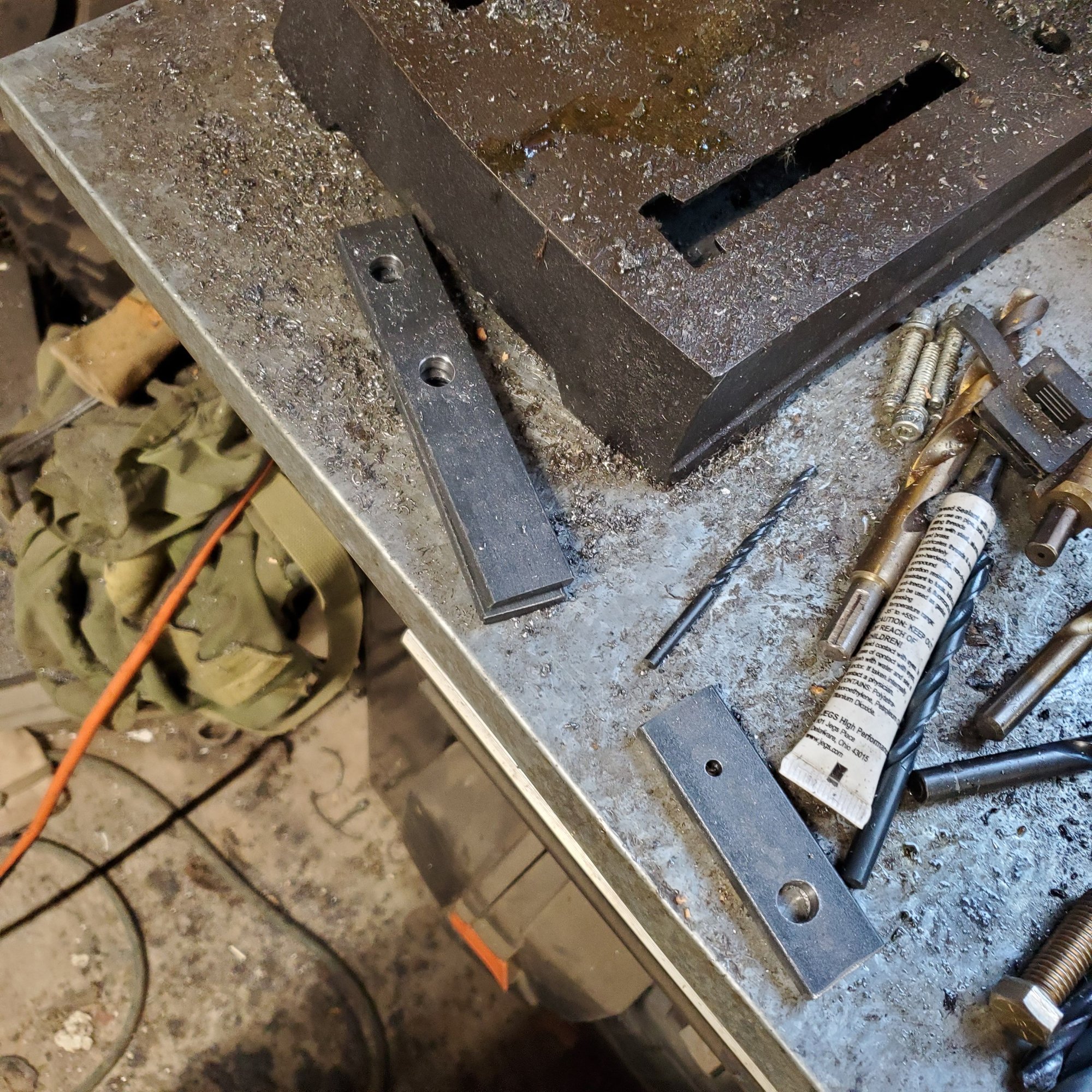

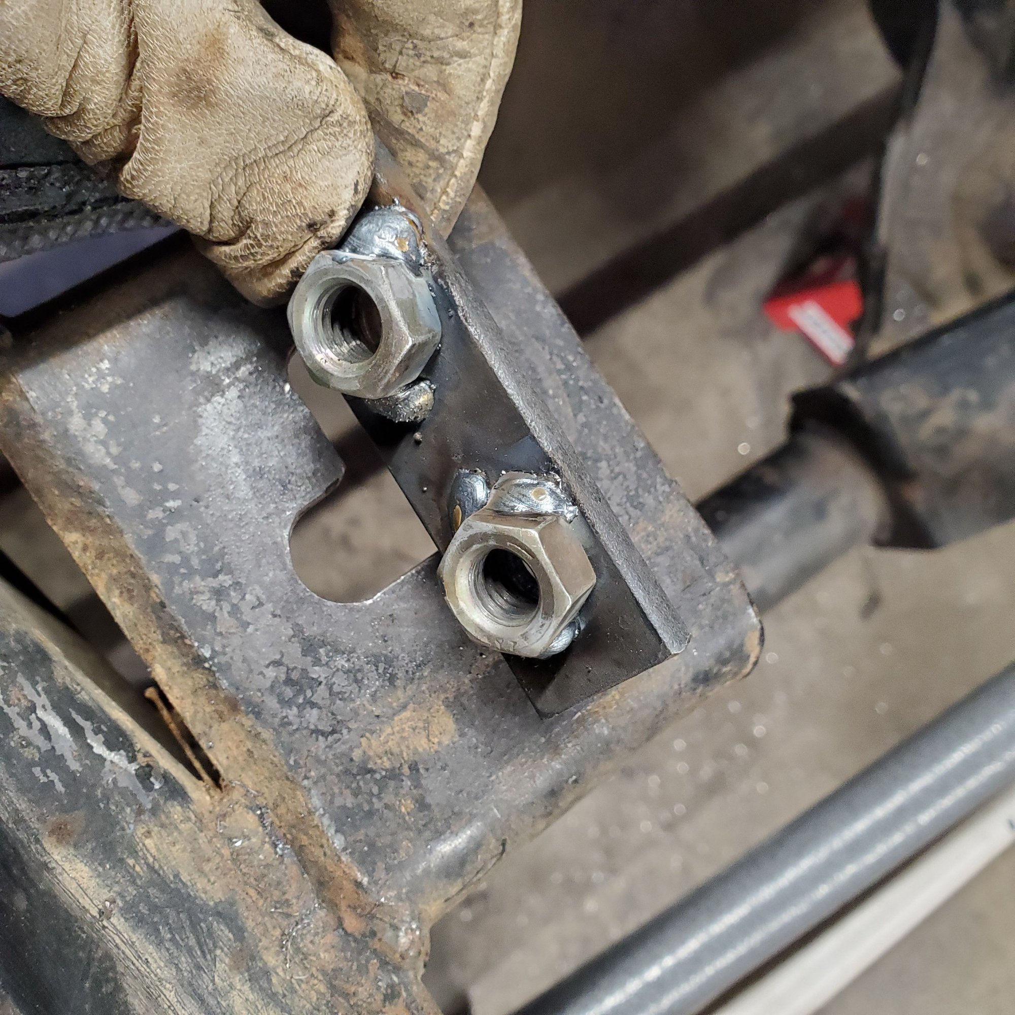

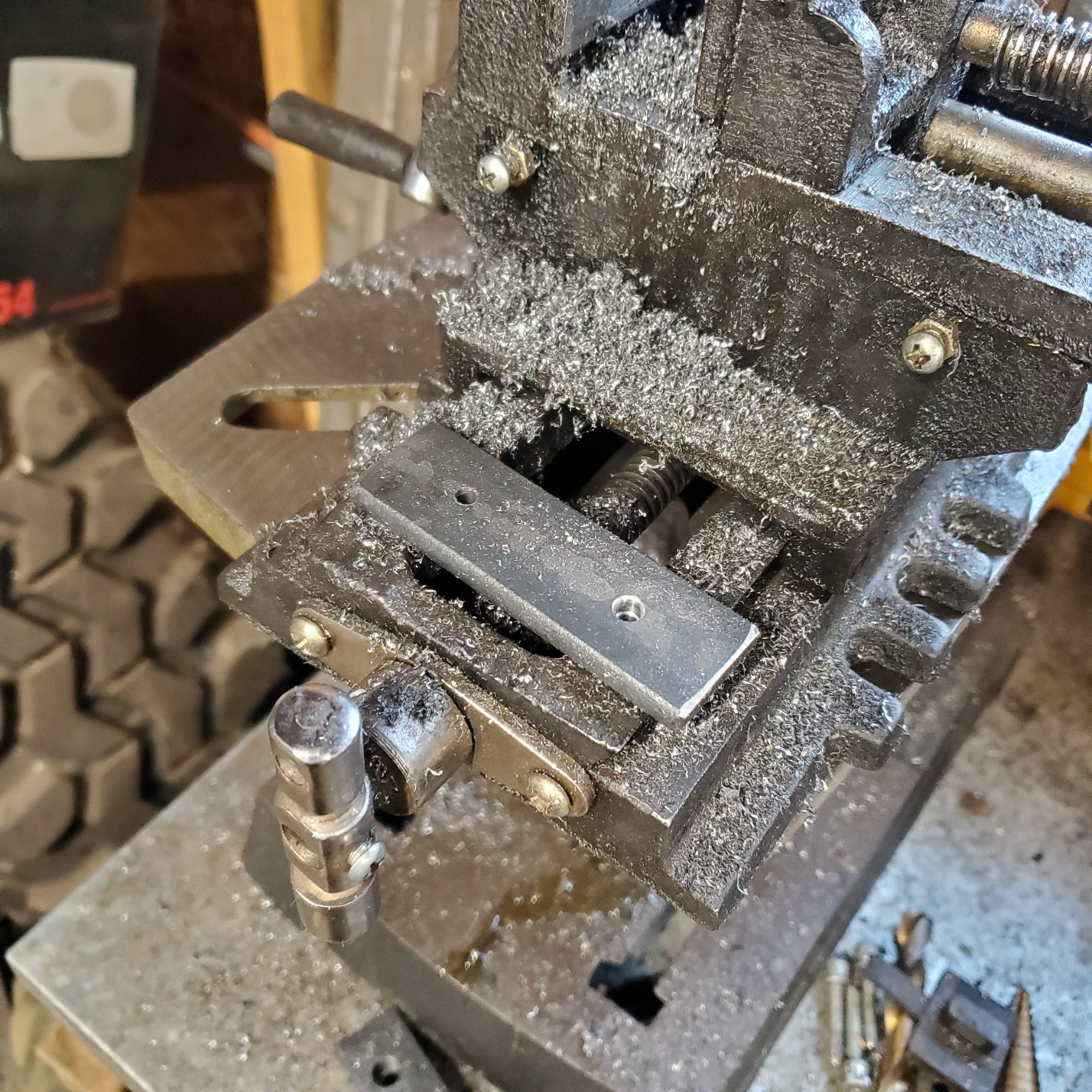

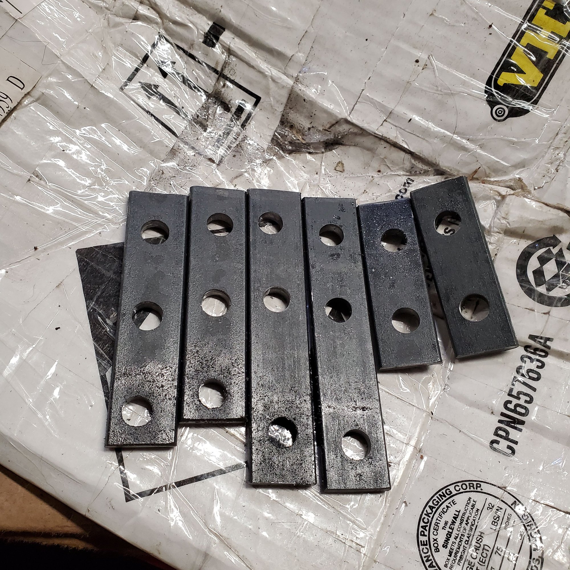

I finally got all the holes drilled into the plates so I could make my brackets for the transmission/skid plate.

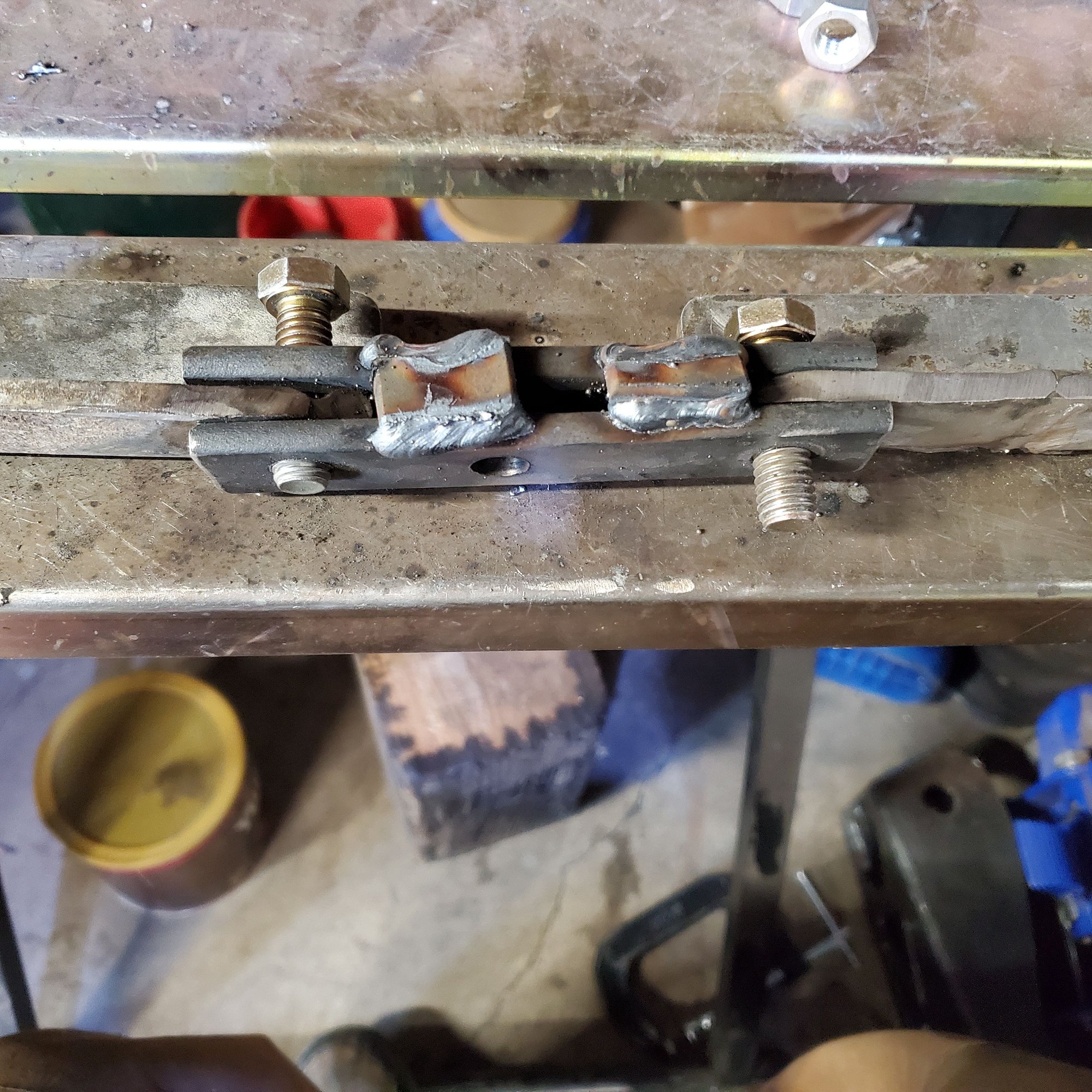

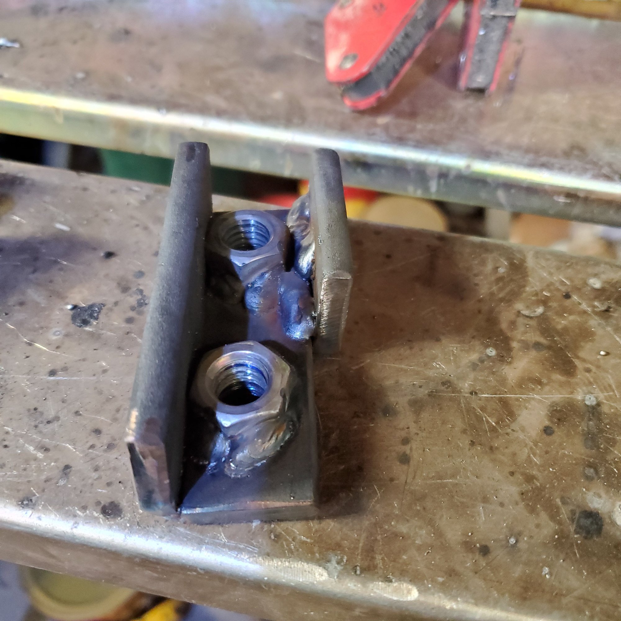

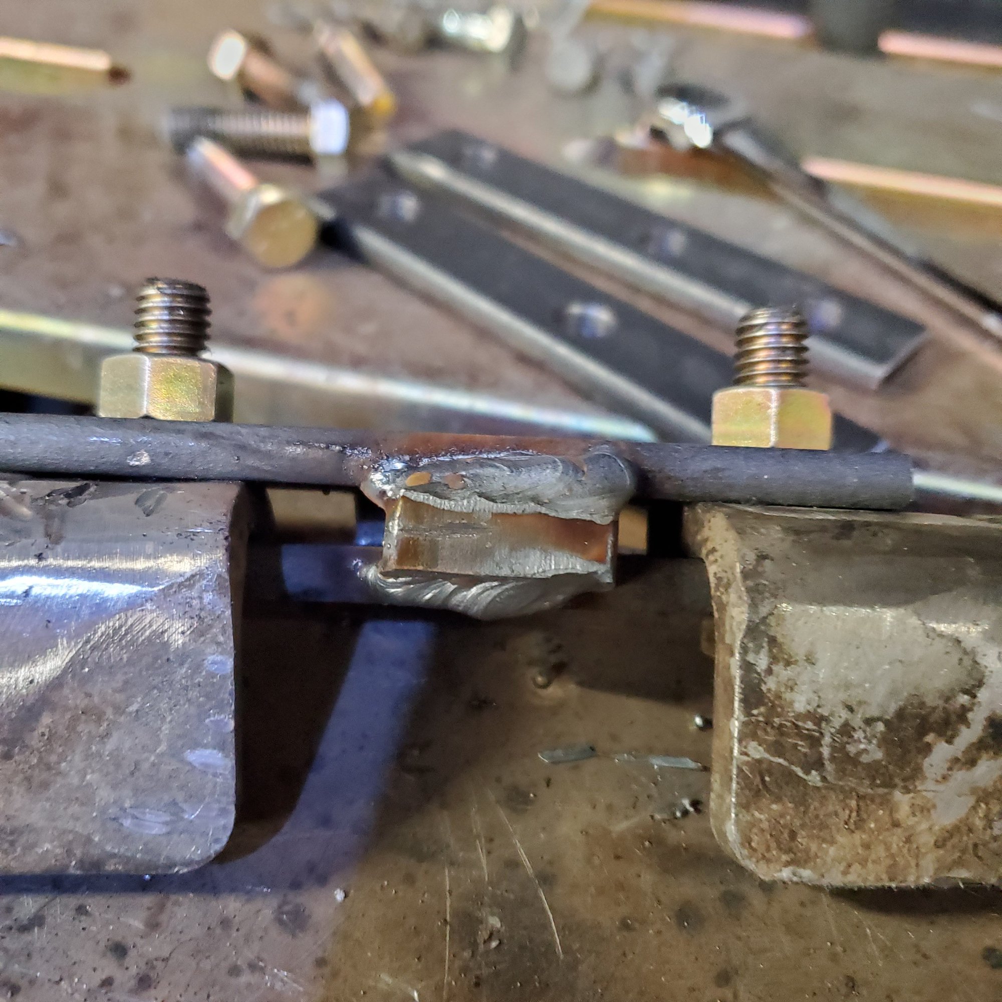

Then I welded some nuts to the back of the shorter plates. This will be my nut backer plate that the brackets I'm building will attach to.

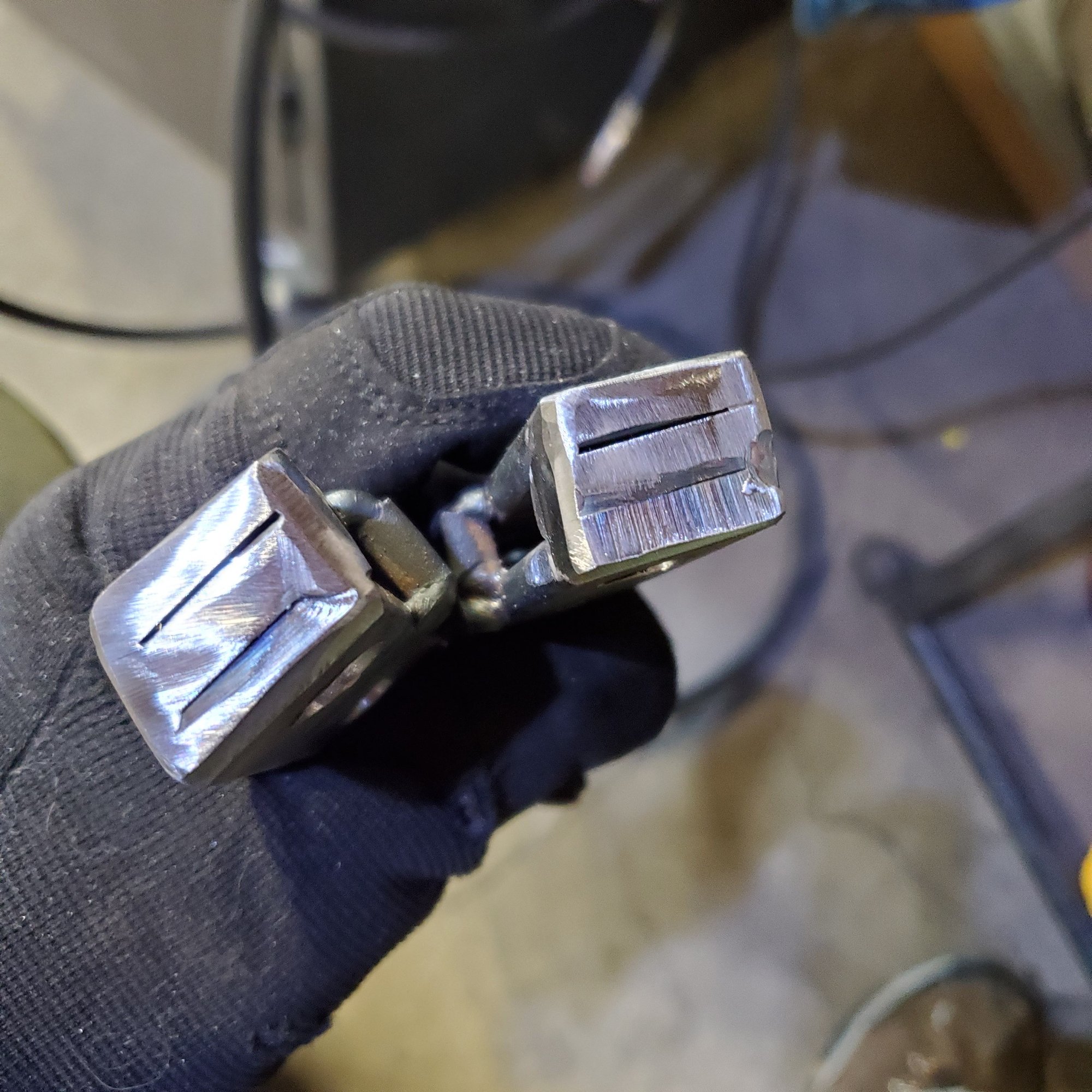

With that finished I then started to work on the brackets that will attach to the nut plates and the arm from the skid plate. So I used the arms as my template to make the brackets with. I'd cut a bunch of little spacers and they helped out a lot.

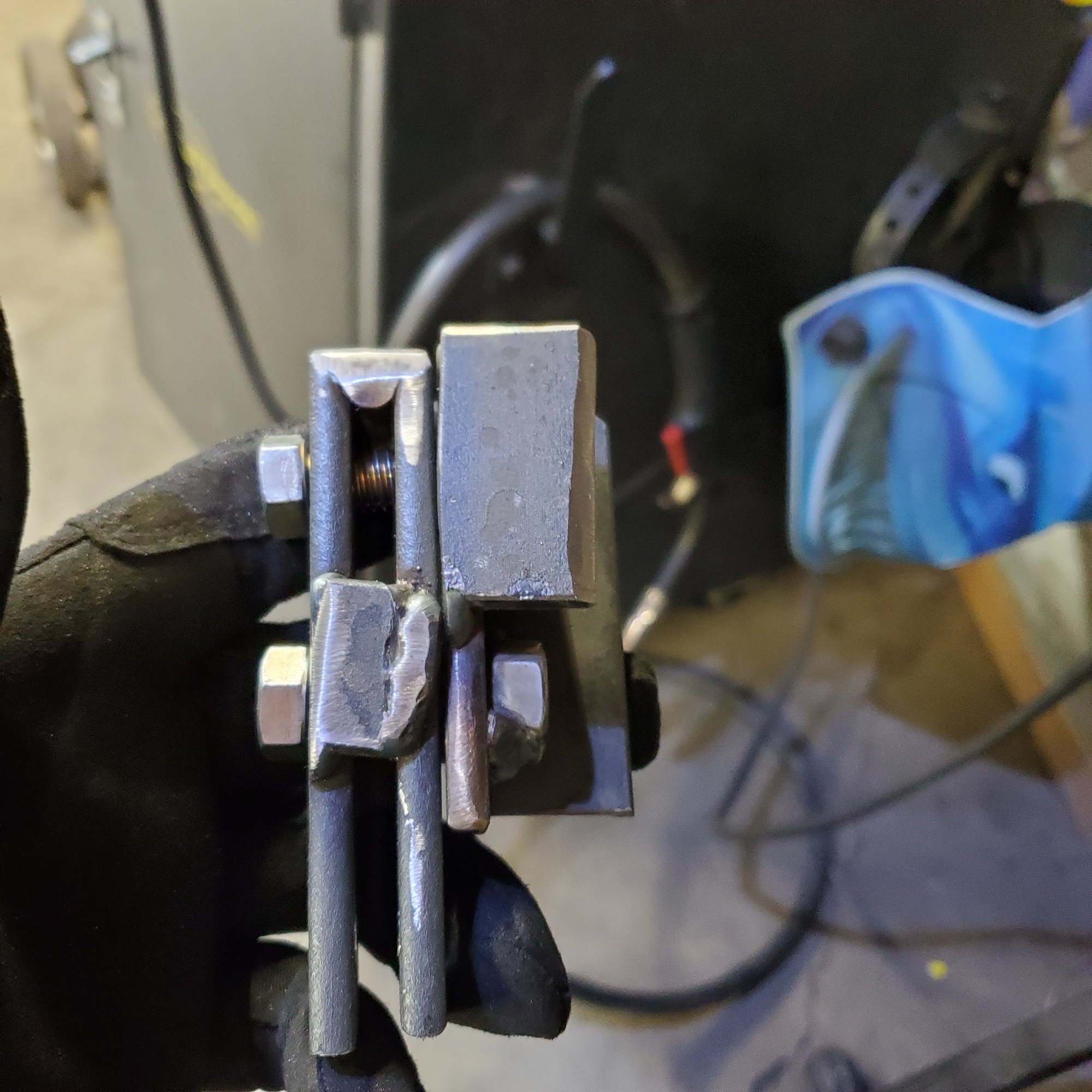

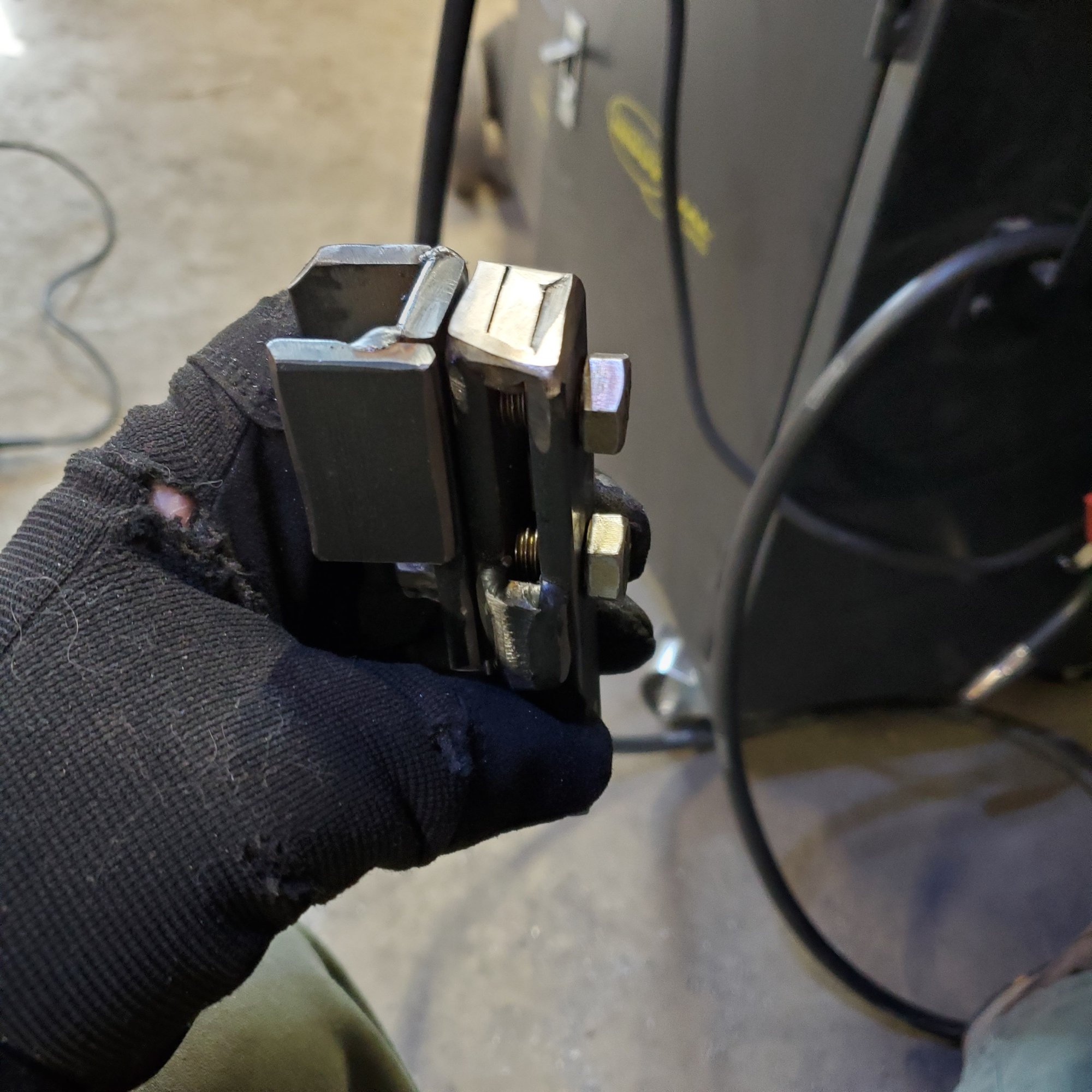

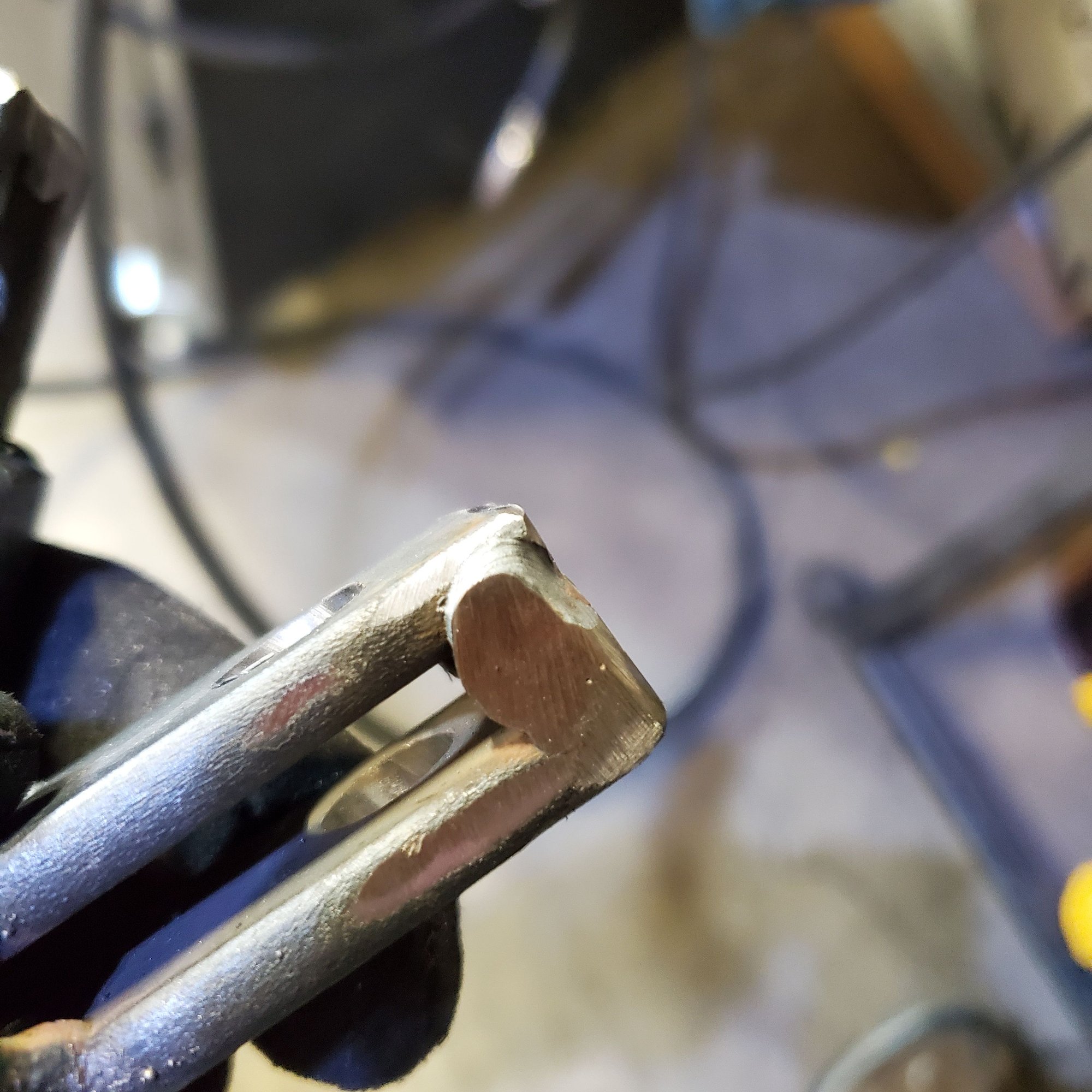

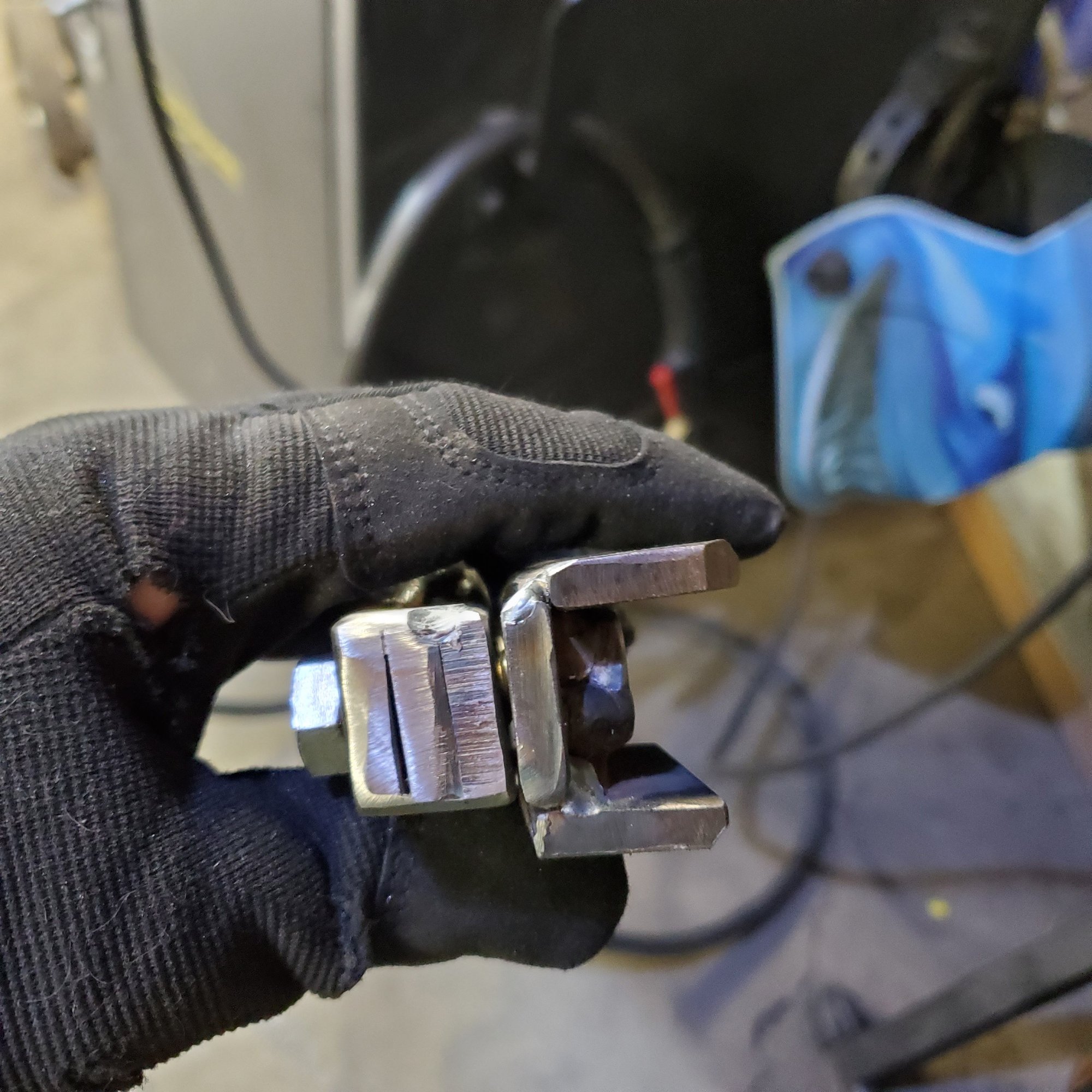

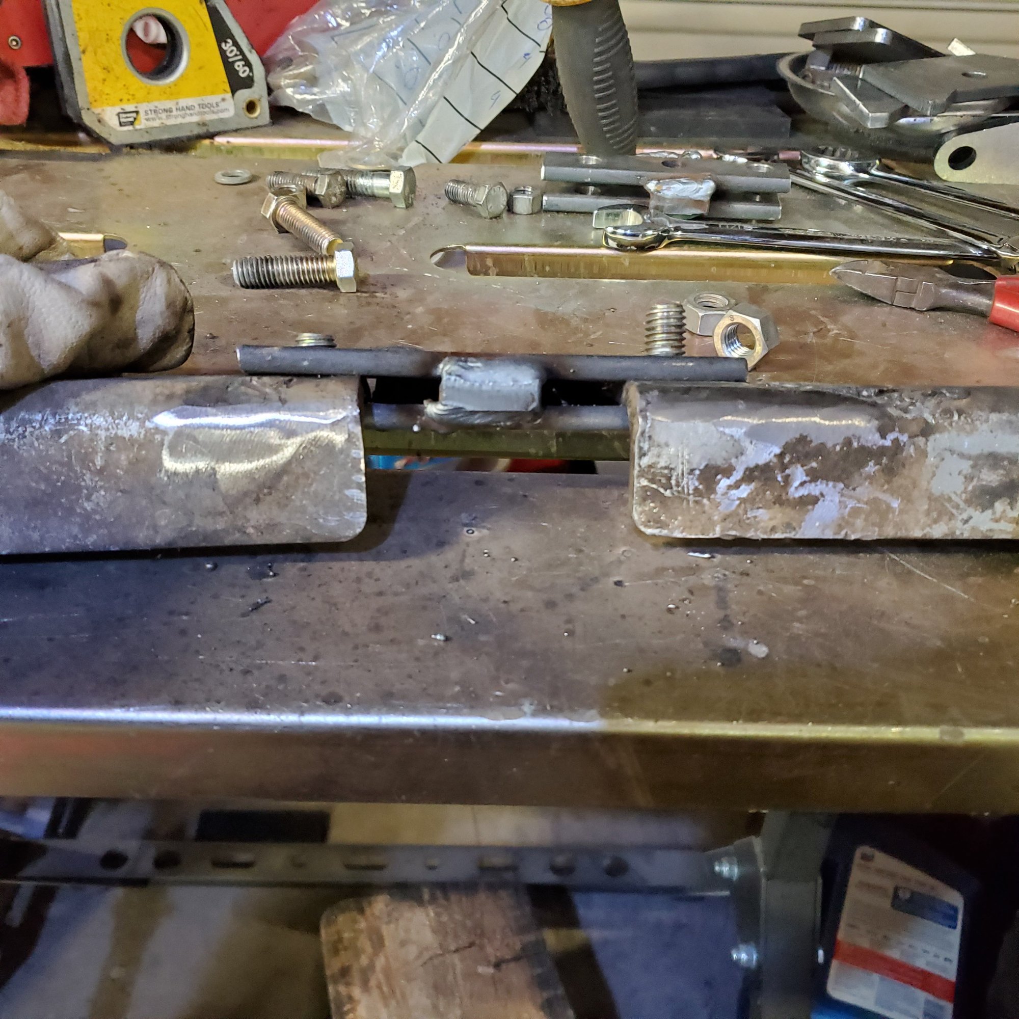

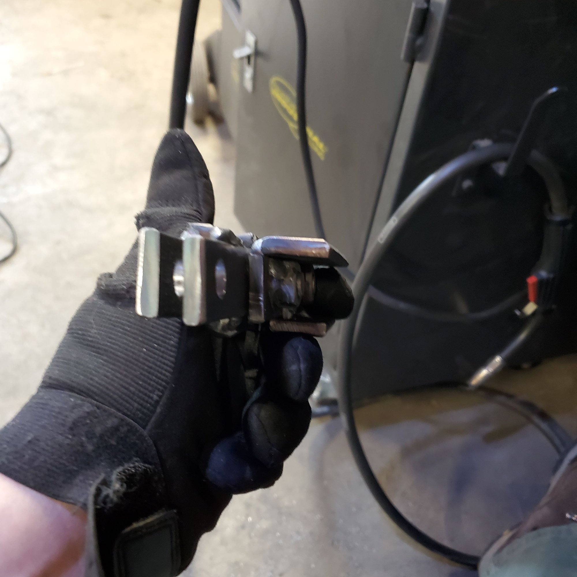

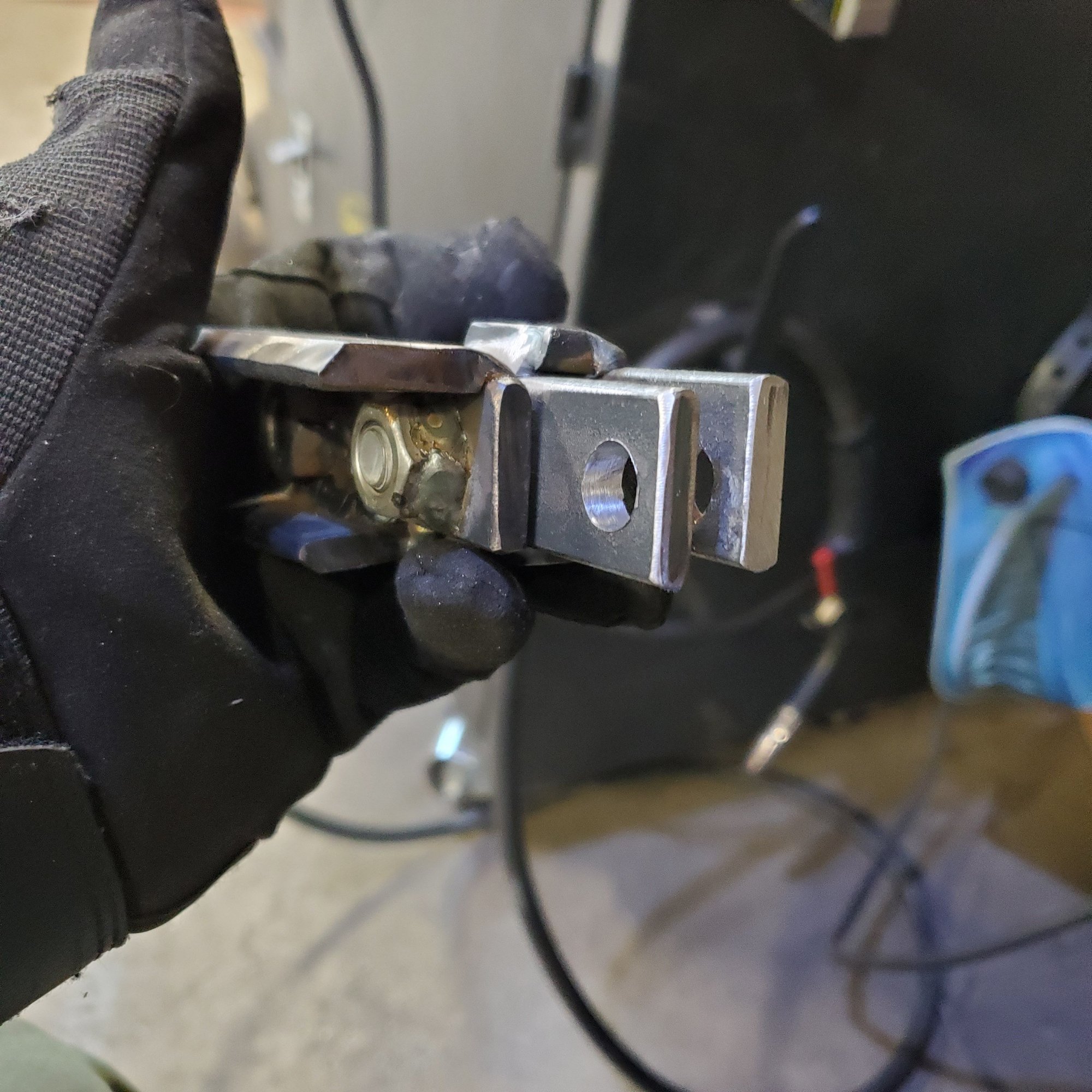

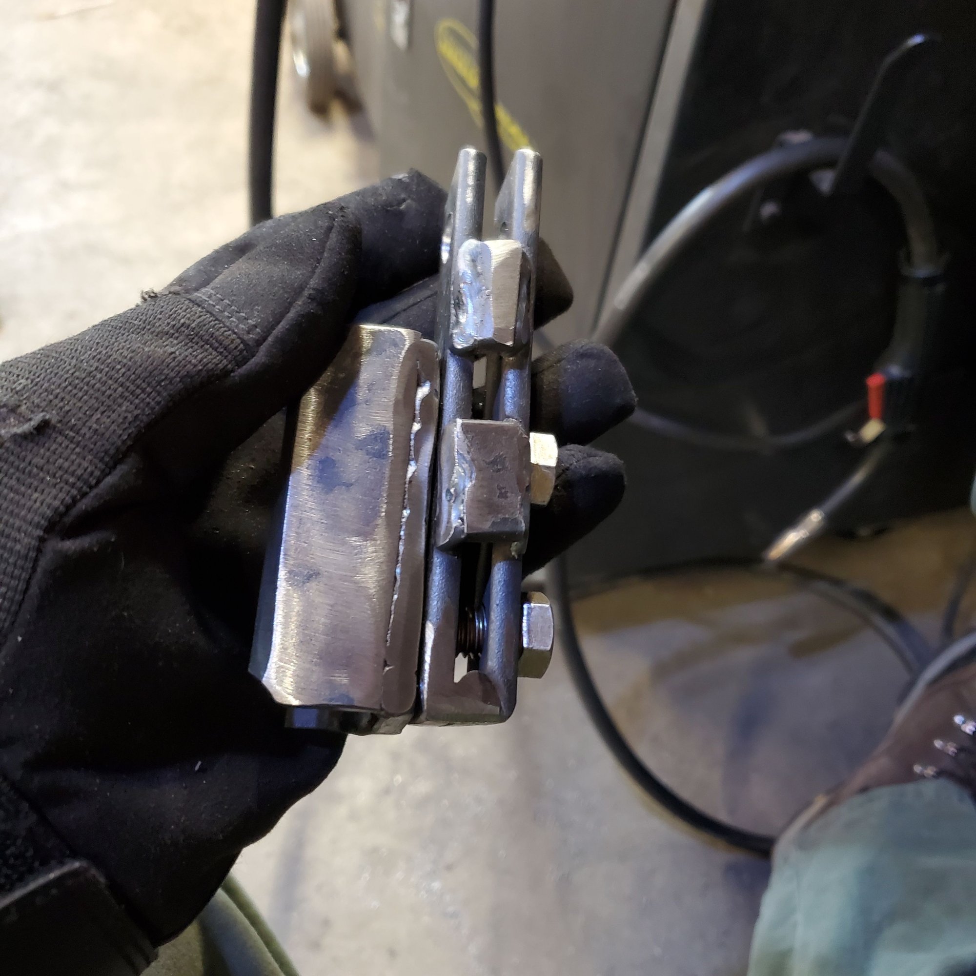

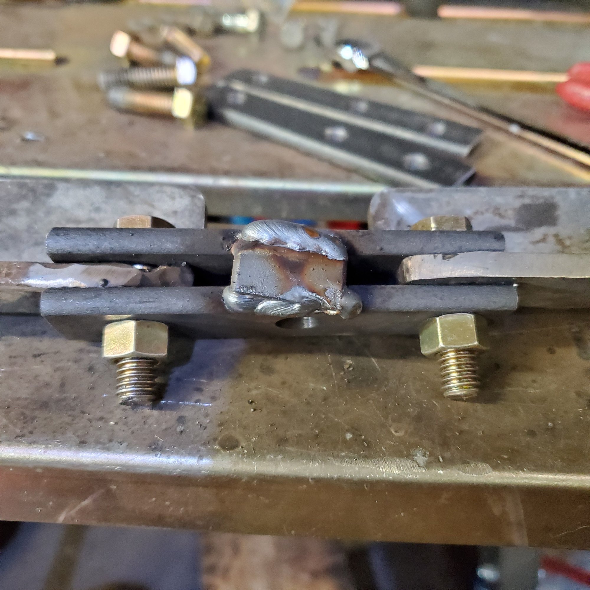

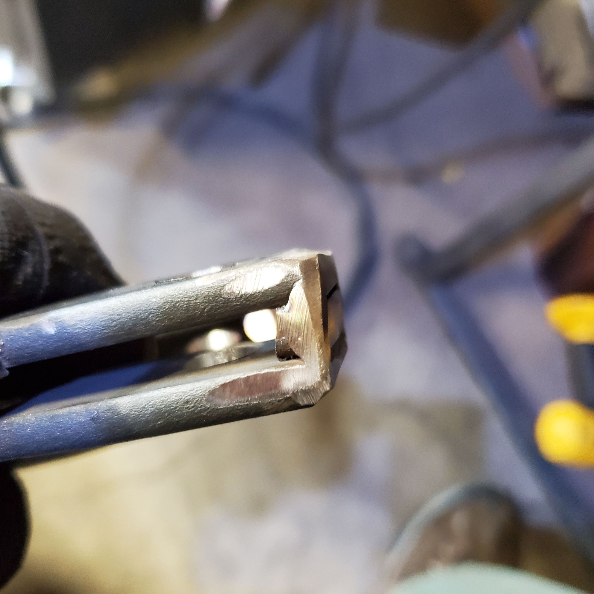

I was messing around with the brackets I'd made that will bolt to the nut plates and noticed that the end where it bolts to the plate would compress and bend that brackets. So I welded in a shim to keep them for being compresses.
They turned out okay and serve their purpose. .

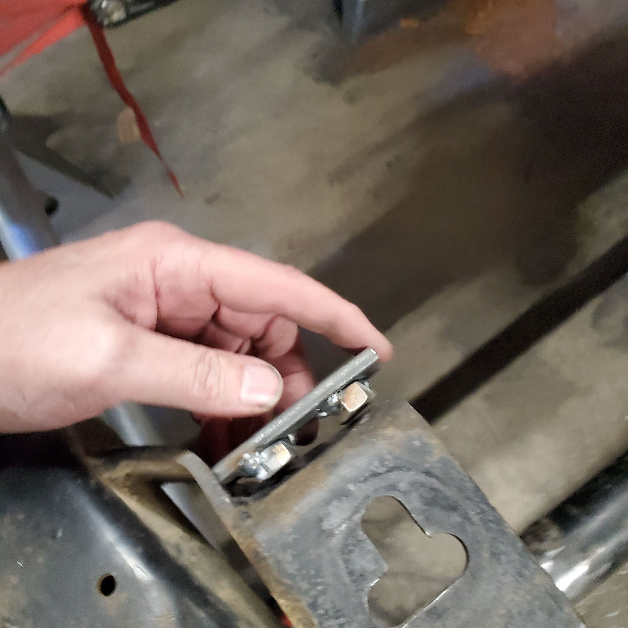

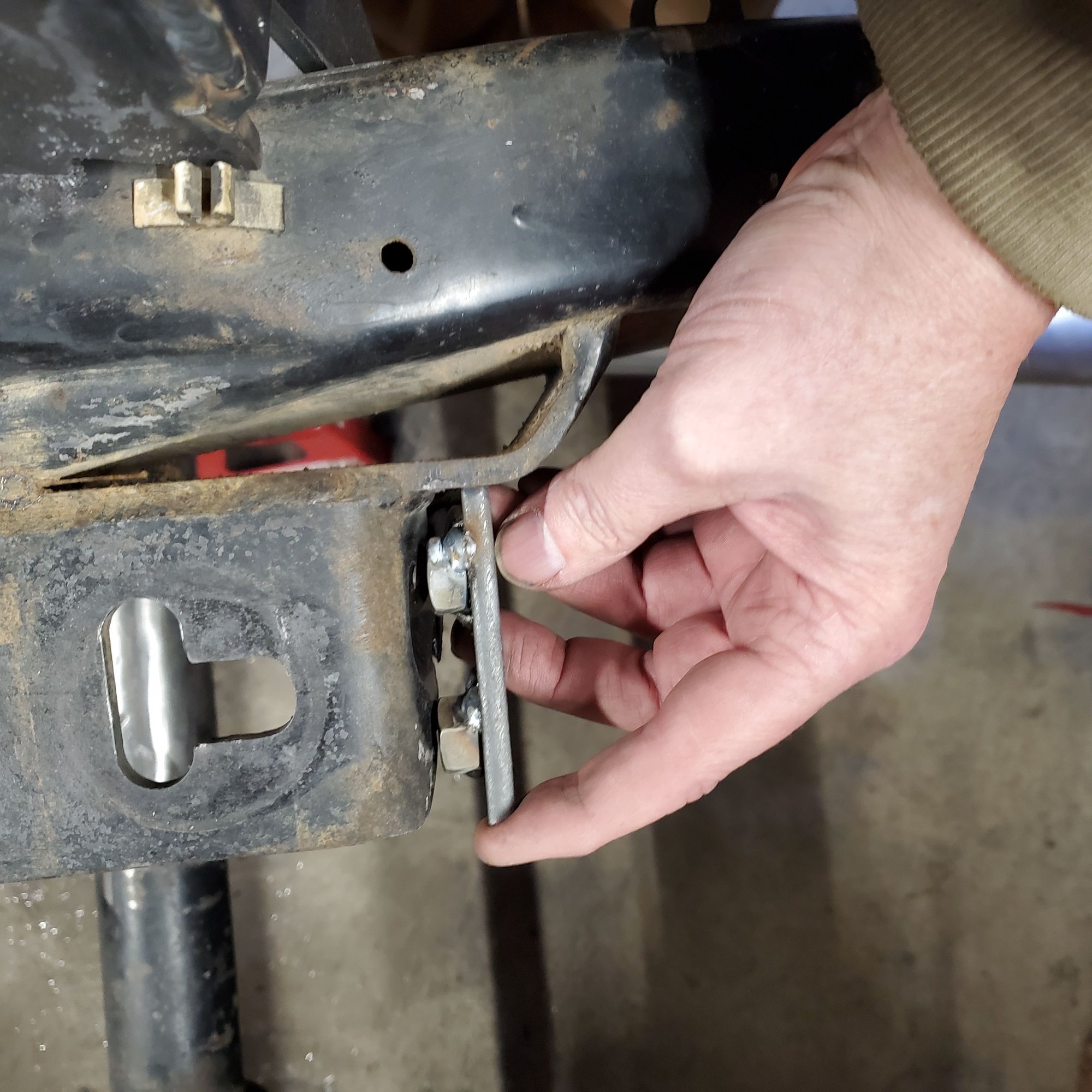

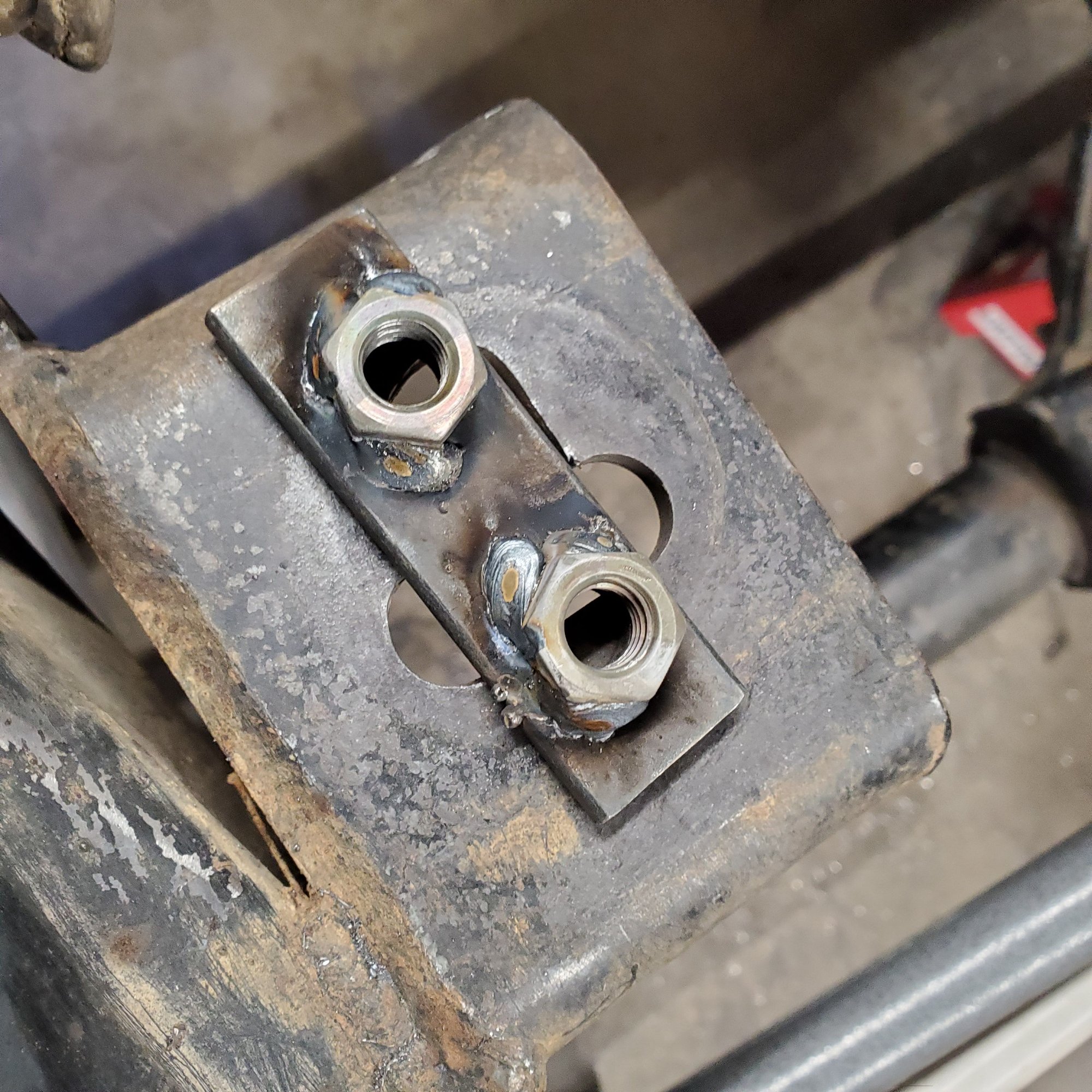

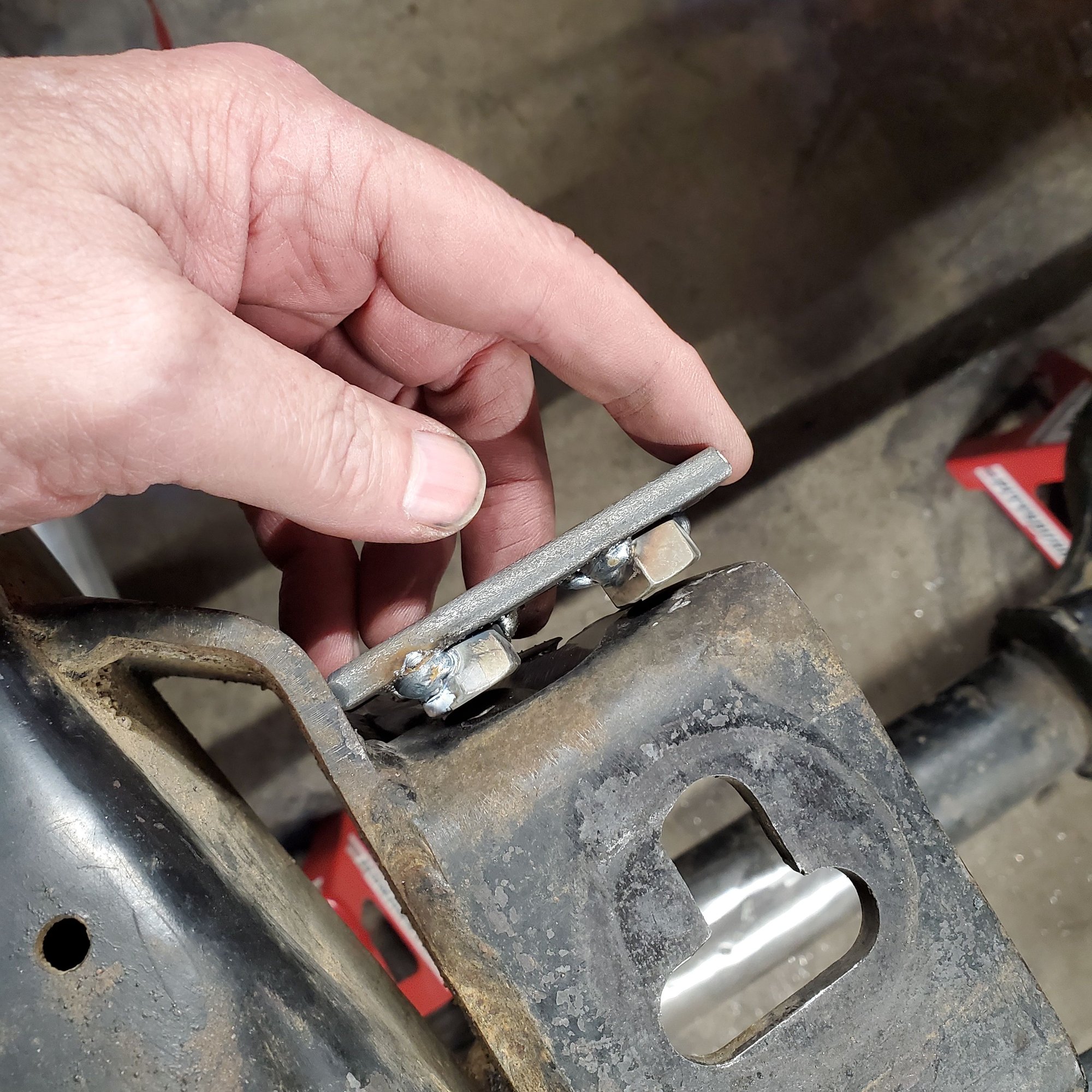

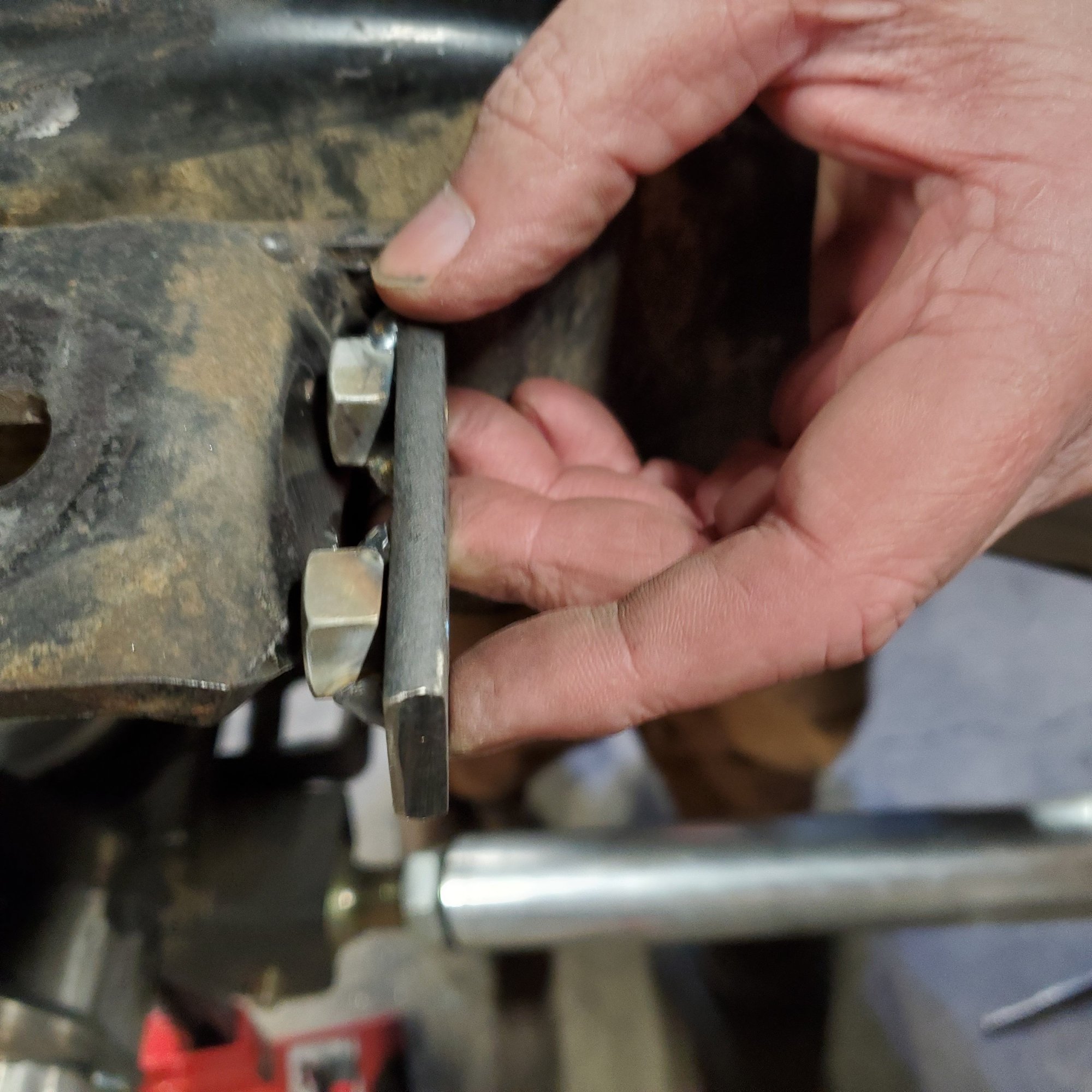

Then after looking at how I want to mount the nut plates to the motor mounts I figured out I'd use some of the 1/4x1" flat stock and a way to mount them.
Since the motor mounts are tapered I needed to make the top farther out than the bottoms. Done and not bad IMHO.
Bolted the brackets to the nut plates just to make sure of fitment.
Drivers Side
Passenger Side
