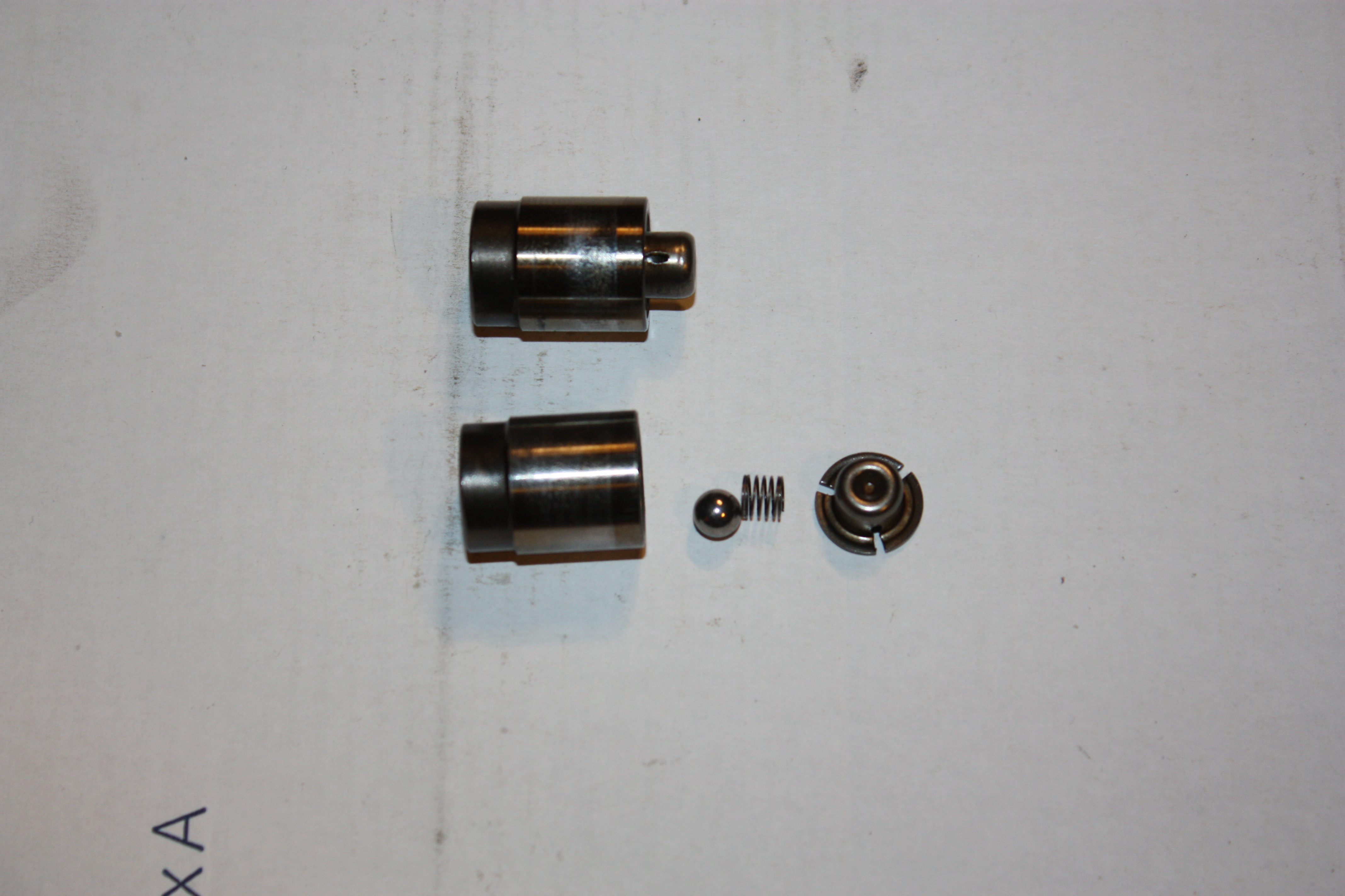

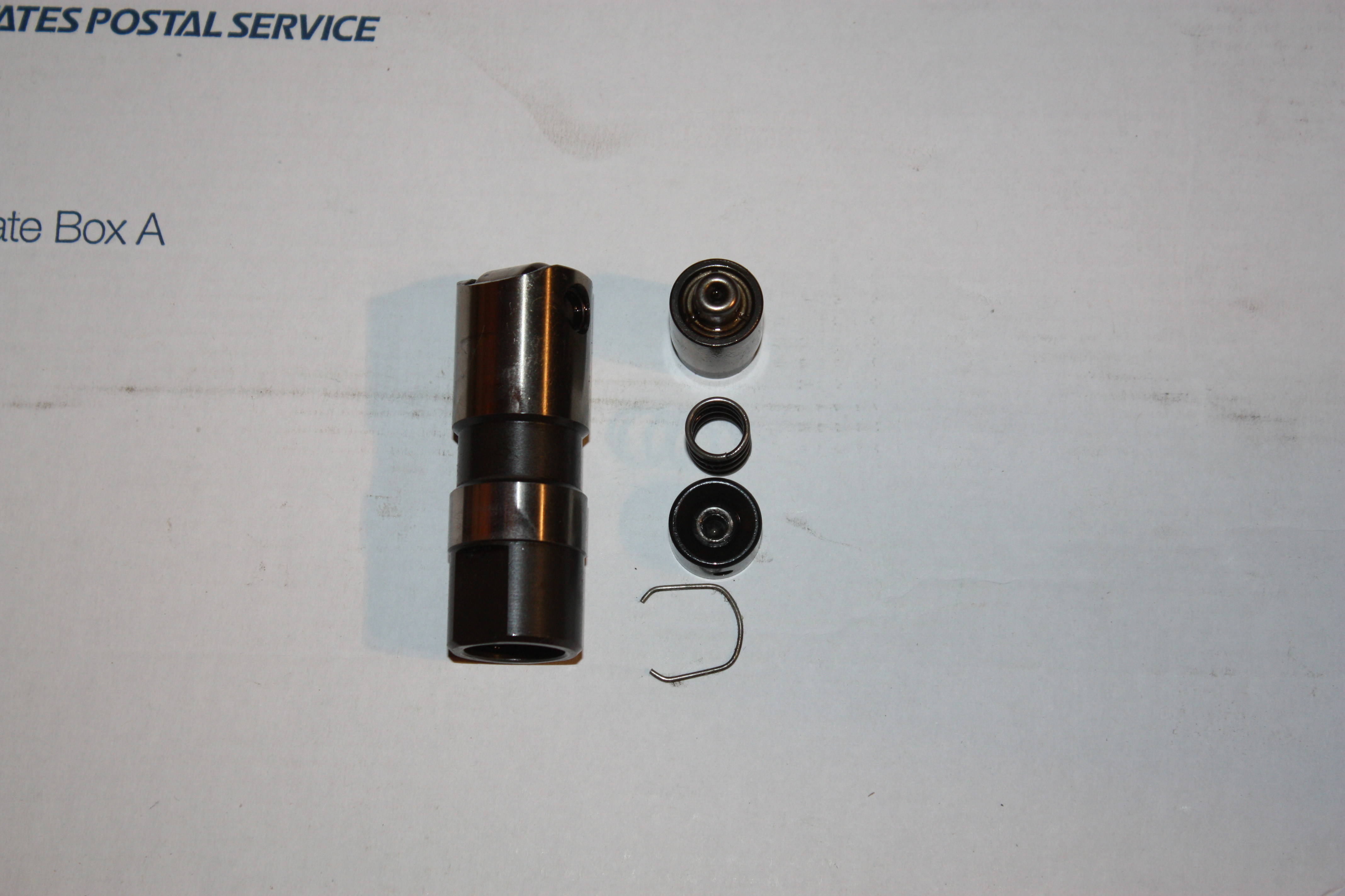

Well I ended up cleaning all my lifters today which was a good thing. I ended up finding out that I had one bad lifter out of the bunch too. They were also very dirty and had a bunch of the contaminated oil with water.
For those of you who have never taken a lifter apart I took some pictures for you and also the lifter that broke.
So here is the lifter taken apart with all the parts.
On the left is the lifter body, then on the right from top to bottom: Plunger, Spring, Cap & Clip.
This picture shows the order that the parts go in.
Next is the good plunger and the broken plunger parts that are inside the it.
Then here is a picture of how the plunger goes together but it is not suppose to be taken apart.
Now this is the bowl I was cleaning the lifters in and I had dumped it out twice before this because of how bad it had gotten.
So I guess I'll be looking for a new lifter now.

Old May 2, 2013 | 09:34 AM
  #125
Posts: 87,475
You can just replace the one. But, given that you can get a set from Mopar Performance for around 110 bucks..... I would consider that cheap insurance. All the lifter live in the same environment......... any idea what cause the one to break?
