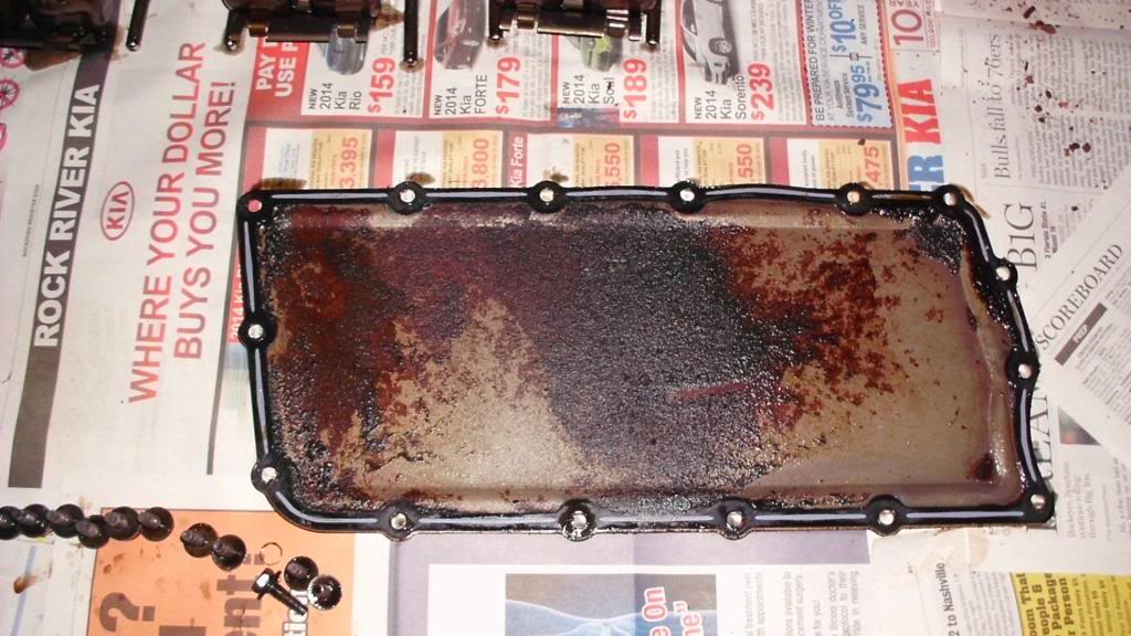

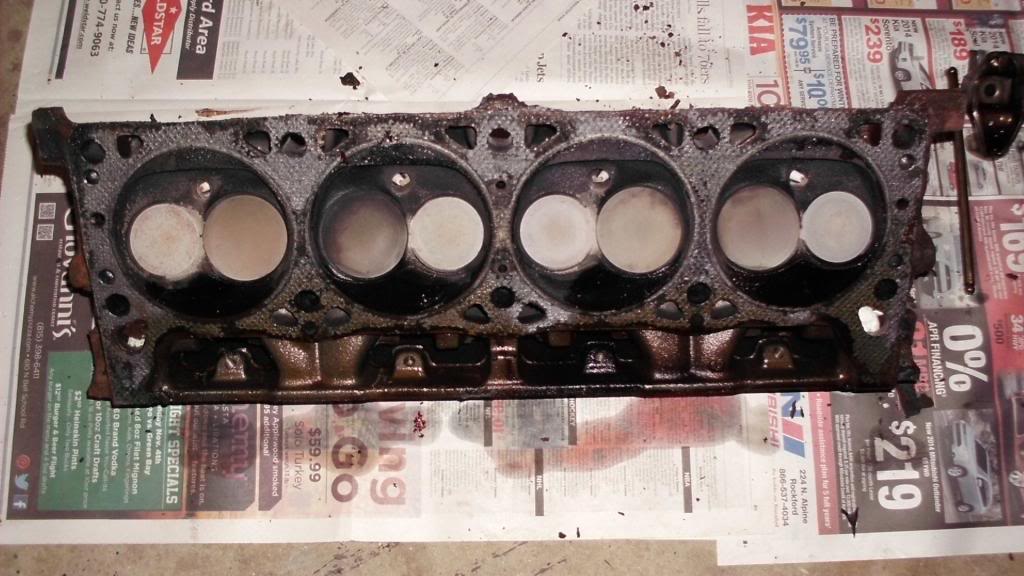

Posts: 88
8 thru 2
7-3

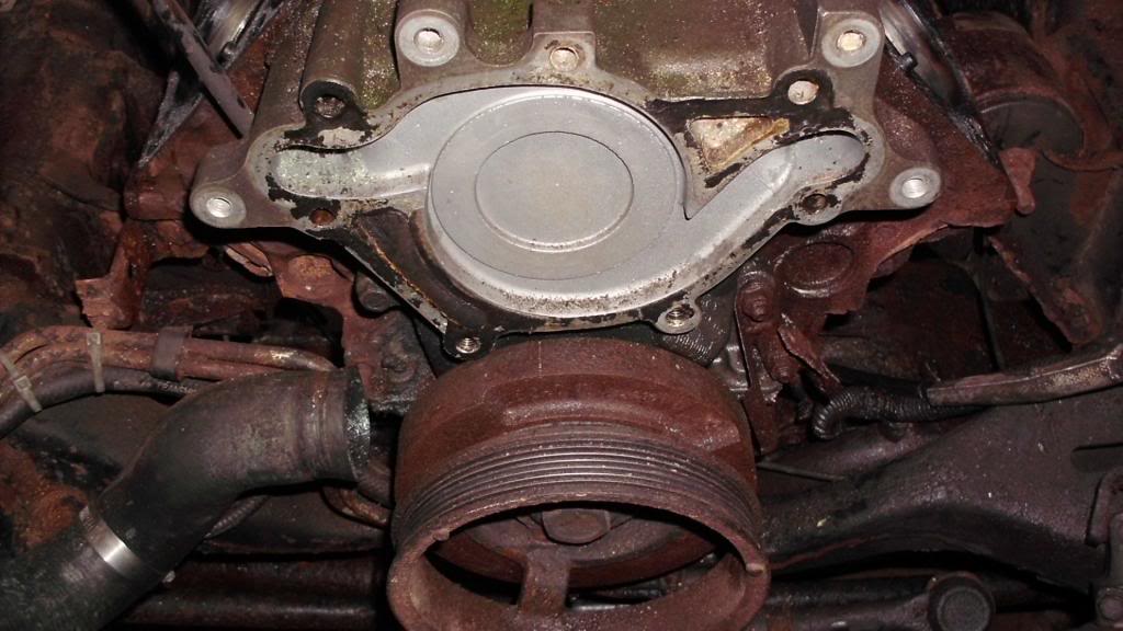

Blown Plenum

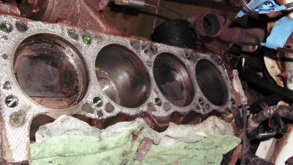

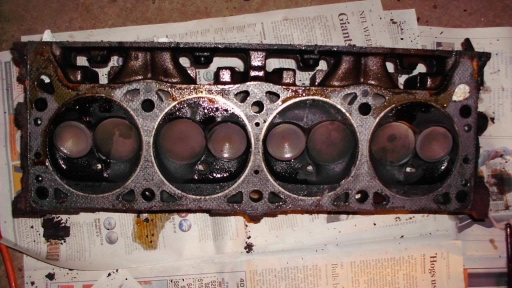

7-1
8-2
Next time pull the freeze plug DA$$.

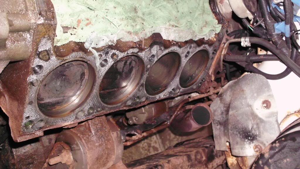

Old Nov 21, 2013 | 11:43 AM
  #30
stallion81's Avatar
stallion81
Joined: Oct 2013
Posts: 88
What next? The truck appeared to be leaking antifreeze at the bottom of timing chain cover/front of pan, BUT I assume it was leaking at water pump and going down? Is it possible to leak from timing cover? Thought that was oil?
Gonna hunt down some new heads, plenum, maybe kegger. Gotta get the TB off. Head gaskets looked good, gotta assume the block top is fine. Gonna price fuel rail and injectors. Off to hunt =).
