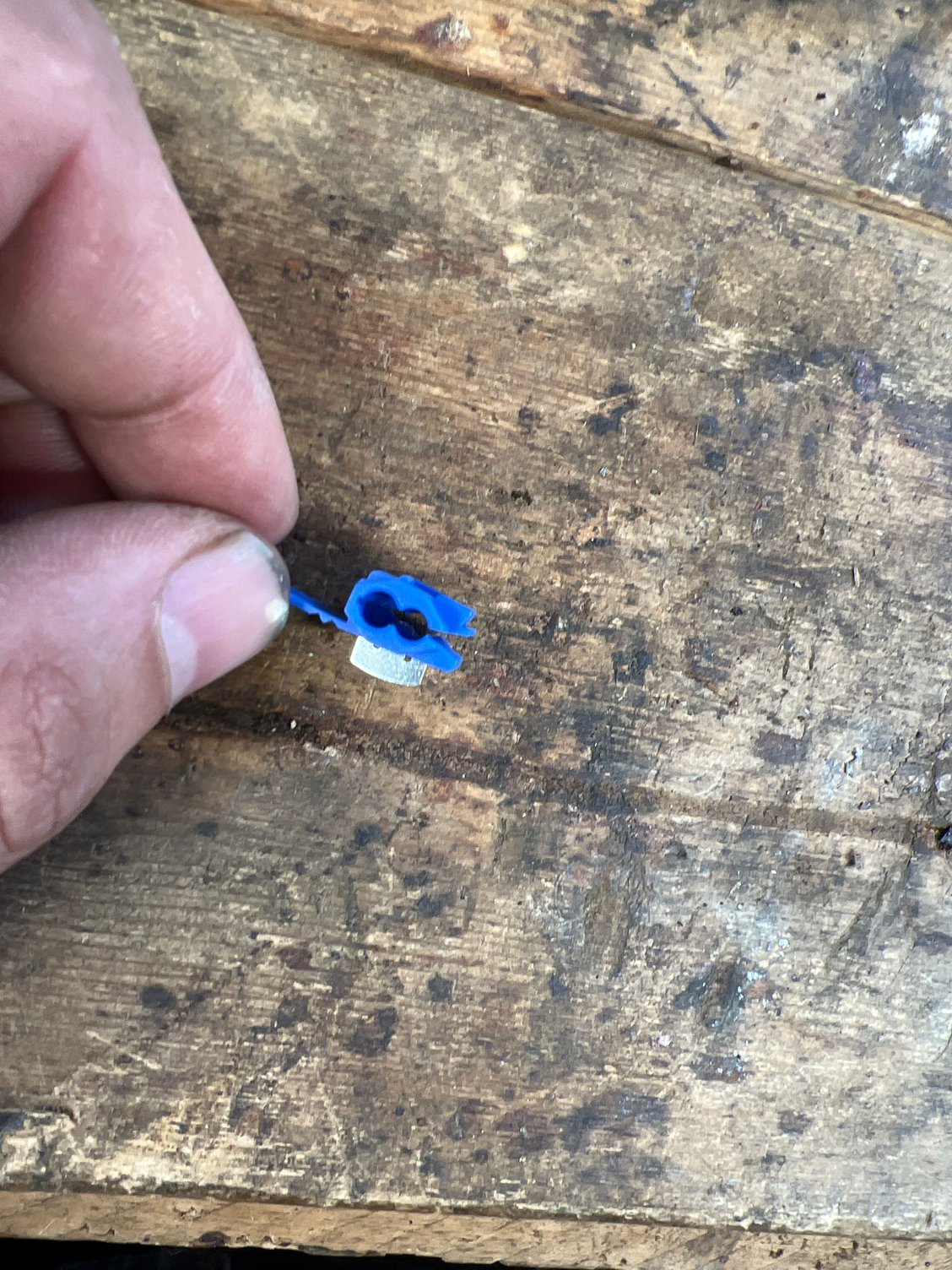

i read this procedure in the book, i am a little confused how to do it correctly though? I believe im supposed to leave the connectors attached to get an accurate reading, how would i probe the wires to get a reading from them while its connected to o2 sensors?
first thought was maybe use one of these wire taps that would allow me into the wire without causing to much damage to wire, which would require me to use 4 of these to test all wires
