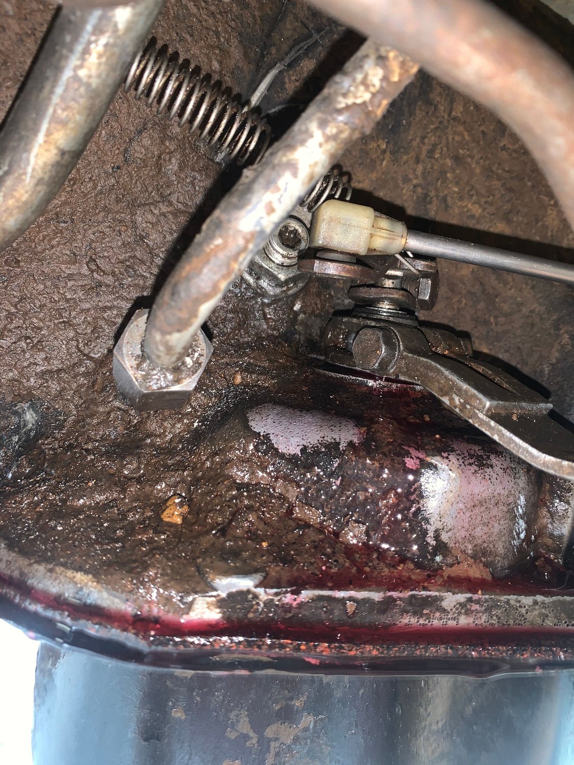

well all my electronics worked fine until the trans messed up. So I still feel like it’s the valve body. Which is kind of suspicious now... because it shifts quick and doesn’t down shift... I could understand if a passage was clogged but the whole thing? Also now that I’m noticing it more, my trans has been leaking, and I can’t find out for the death of me why. When I get under there and look the only place it looks like it’s leaking is from the whole where the shift lever goes into the pan onto the valve body. But why the heck would that leak like that? I know for a fact all bolts are tight on valve body. What else might it be?

I think there are a couple o-rings in there, to seal around the shaft.
well I’ll definitely have to look at that.... I’m fixing to go buy another valve body off of a guy and replace o rings, and do complete fluid change, if that doesn’t fix this stupid thing I think I’m about ready to give up on her. I’ve put a lot of money in this thing lol
