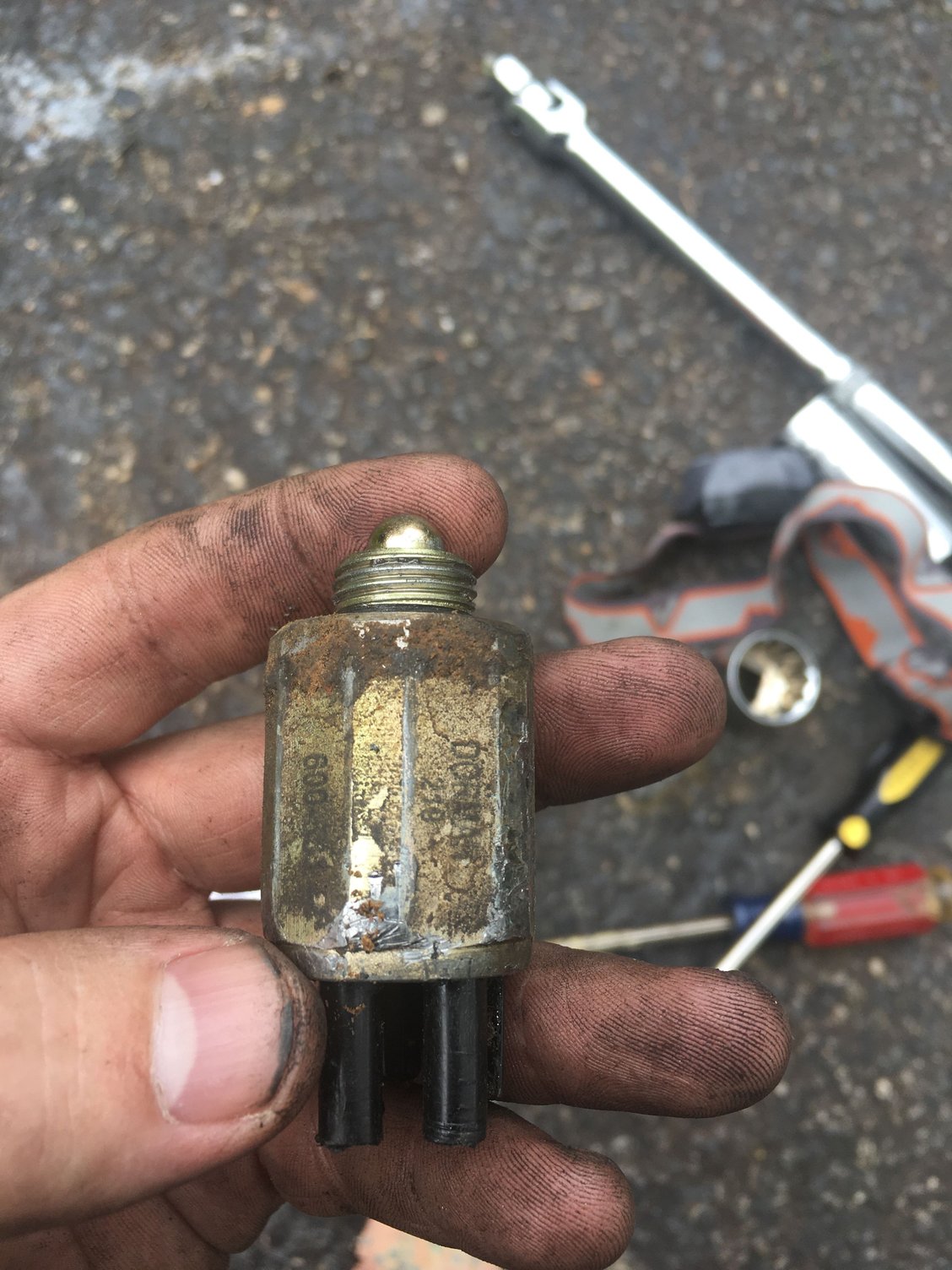

Fixed 4wd it was that switch now light comes on and everything

Awesome.
