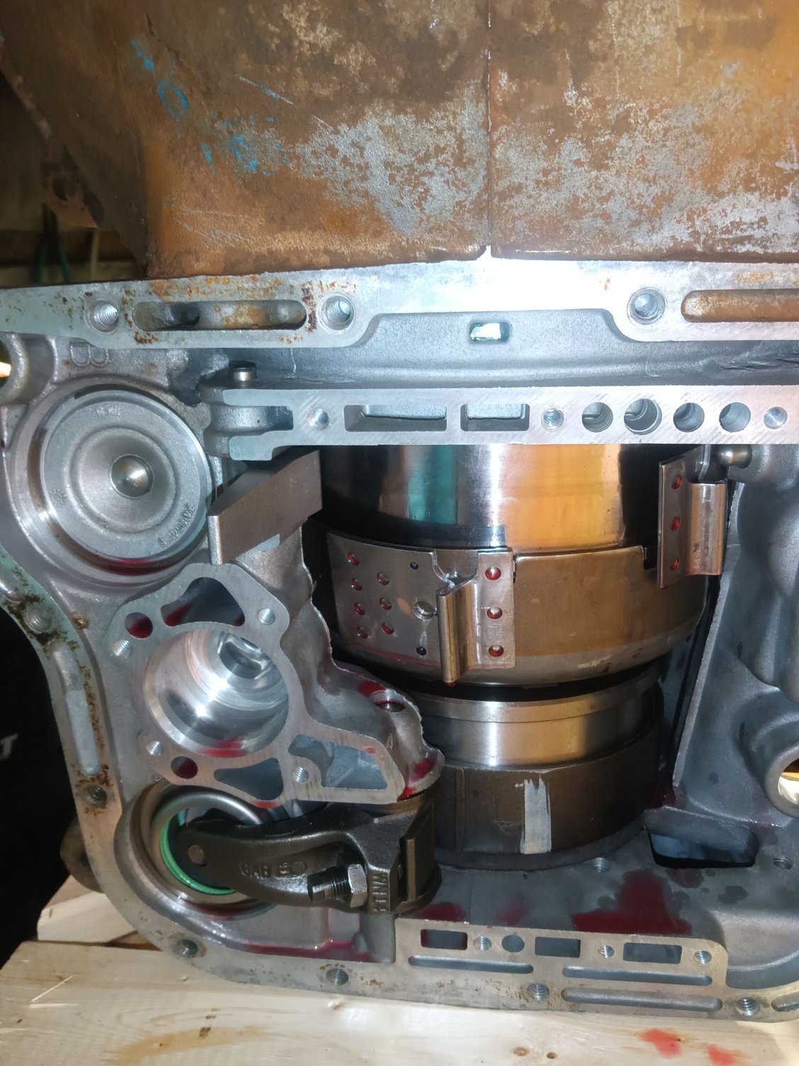

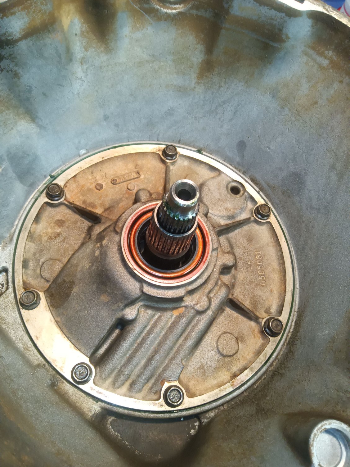

Keeping head down and making progress here so far. I have it done the the pump installed. Did a bench air check and everything worked as intended. Can't find feller gauge so going to make a stop by the auto store to pick one up on the way home so I can do check, then on to getting the band done and adjusted, Then go from there.I can say I am learning a lot from this. I am going to post a couple of pictures and will continue to update. Thanks

Well officially down to the valve body. I will admit though I had to go back in and flip the band. lol, Brain fart I would call after putting in upside down. I still thinking about get another torque wrench that goes up to 100 Num. I didn't realize the one I bought doesn't go up enough to go by the 72 lbs Num to may a proper adjustment. I'm pretty confident I did a pretty good job so far. Few hiccups but I am sure that is expected with a first time rebuild. I figure once this is done. I will be looking at a new timing chain since it hasn't been done with the millage it has. Thanks Guys.

If you are talking band adjustment, they get torqued to 72 INCH pounds.....
I bought a num torque but didn't realize it only goes up to 40. Just have to break down and buy another one but one that reads high enough. I have the info just not the right torque wrench. I still have a few things to finish as well some more parts to get so not rushing here. Have a O2 sensor to replace as well as new lines. Other than a few hiccups. It wasn't bad at all.
