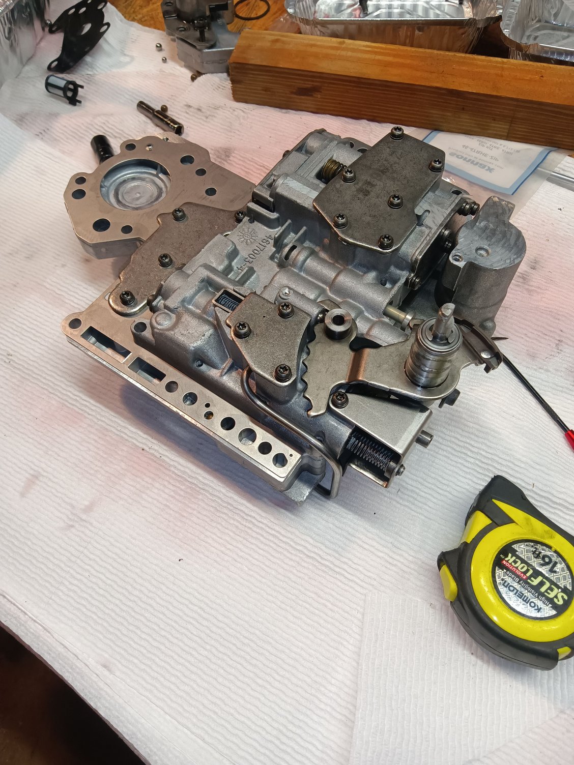

Man, I couldn't even get mine as clean as yours. I'm going to have to cover and clean a spot good enough to do the same with information of rebuild. I just completed the valve body rebuild. My problem is I bought the solenoid kit back in May of 22 and I am questioning if I should just order a new kit or replace these back in? My problem was slipping and erratic shifting. Sometimes it was good or little off or just play goofy delays. Limited experience with rebuild knowledge doesn't help with making this call with complete confidence. I wont be ready for install till next weekend since I am waiting on a my O2 down stream sensor to come in this week. I replaced the up stream but found out the down stream was bad also. I just figured while it's out. This would be the best time to replace it as well as the trans lines I just got in. I am almost there.

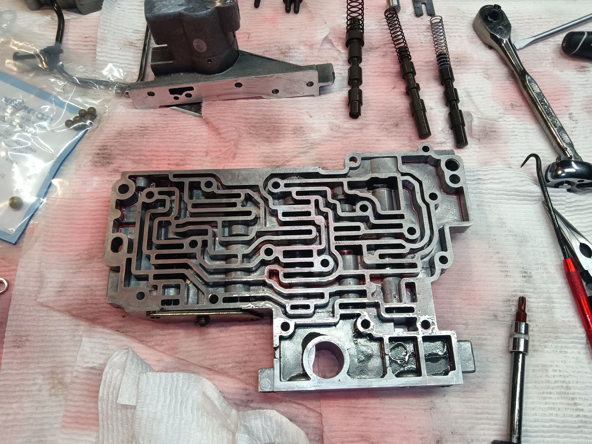

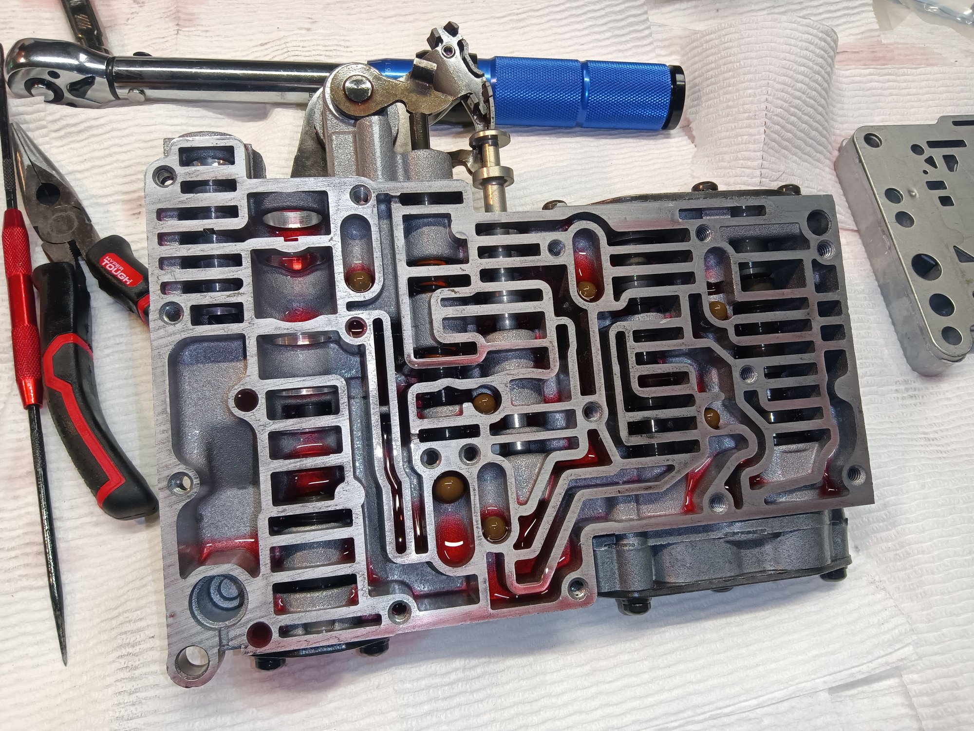

I checked out your link and it didn't fit mine but I found one that does with drain plug for $30. Heck it's worth it. Thanks. I did notice during the tear down of the valve body there was black sludge build up but like real bad but enough to coat your finger tip. I'm sure is very typical for the millage on it. Mainly build up no signs of any metal. Overall I have really enjoyed doing this rebuild. If you said I would be doing this 30 yrs ago. I would have said your crazy.lol. So far I have over came any issue I ran into and fixed them ( or I should say corrections). I will install converter sometime this week to take my measurements to make sure those are correct. I wrote everything down when I took it out. I have some pictures of the valve body tear down and cleaning. You see the sludge and where I made a finger tip impression.
