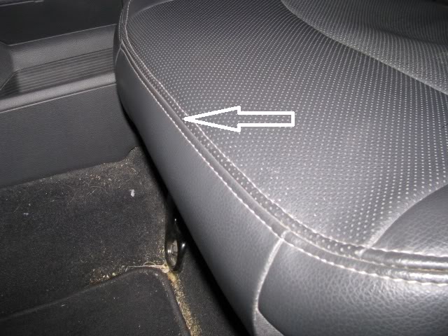

If your seat has the "double stitch" going around the front like mine it must be replaced. The service rep showed me the procedure, it had a pic of the stitched seat and the new improved seat with no stitching around the front. The inspection is to see if you have this stitching, not to see if its torn. If your seat looks like the one in this pic it must be replaced and it makes no difference if its torn, don't let them feed you BS. Thankfully my service rep didn't....And yes my truck needs cleaned lol

Yeah my seats do not have the double stitched seam along the front.
