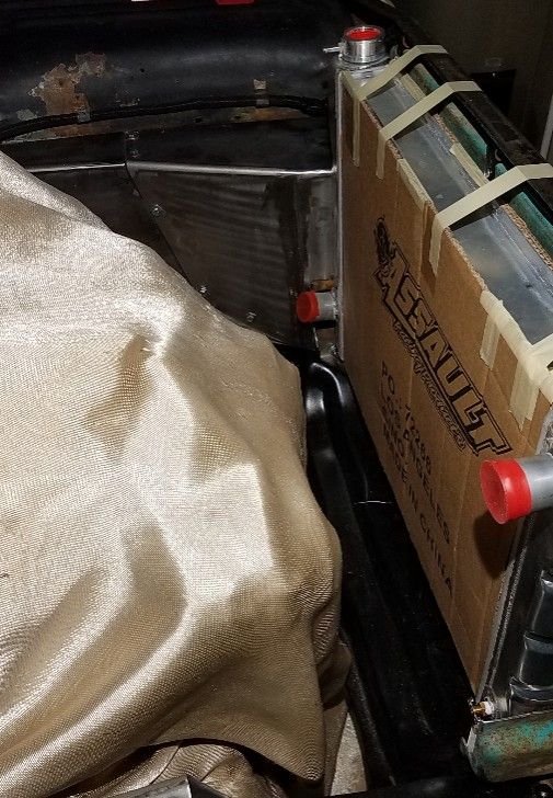

I started a few things this weekend. I got my radiator in, so I started fabricating a mount for it. It seems I didnt measure the hole right, or the radiator was a little wider than expected, but it was super tight, so I modified the core support. I needed the radiator to be as far forward as possible because of the electric fan. It would have fit without cutting, but It was going to mess up the radiator over time. Plus I had been trying to figure out how to make a smooth transition into the radiator support/core support area, so this fixes that also. i think it looks good myself. I still need to work on the inner fender wells to make them look better, but Ill do that after I get them all fabbed. Also it is a 3 pass radiator, so the bottom hose is on the opposite side. I never planned on using stock radiator hoses, because I want to install a 5.7 hemi eventually. This radiator should cool up to 700 hp, which Ill never make. I got one of those AFCO hose kits that should work, but it will need a few additional pieces.

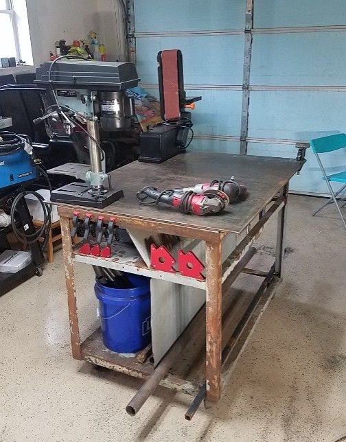

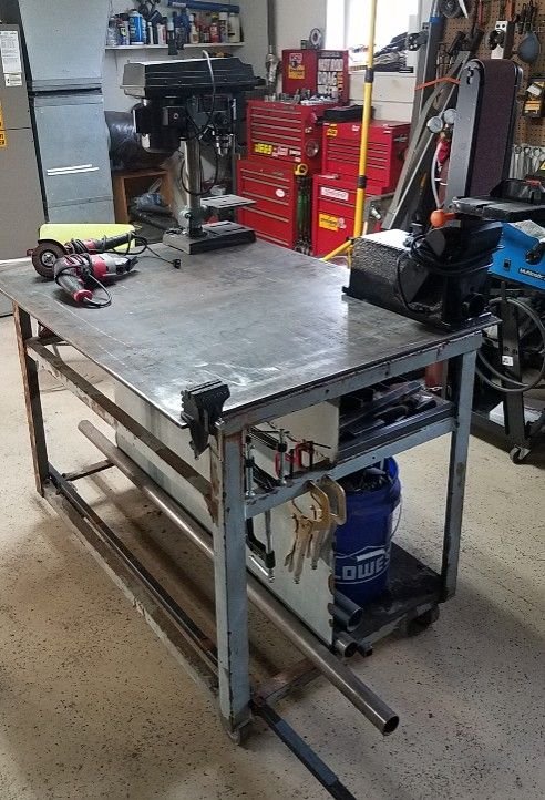

And, I got a deal on a welding table. I have been using one of the fold-up tables from Northern, with a 3/16 plate on top of it. It worked okay, but it was low and it killed my back. Plus it was a small table so it got cluttered fast.
The new table is old and a bit rusty, but its taller, and more than twice as big. It needs work so Ill deal with it when the weather turns. Its too much rust floating around in the garage to do it with the door closed. Ill get the rust off of the table, make some mods, and paint it.
Im going to add a "leaf" on both sides and extend it. It is currently a 3 x 4 top, and its 3/8 thick. Ill extend it about a foot with removable leaves that slide into receivers. Ill make one to hold the drill press and belt sander too. I will make it so they come off and can be swapped easy and used on either side. Then Ill paint it. Should be nice.
