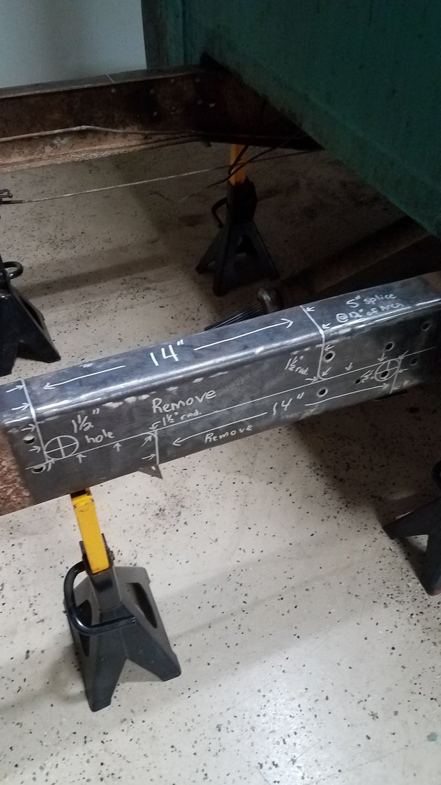

My layout of the cut. The long bed is 24" longer. 14" between the rearend and the cab, and 10" at the back. Ill cut and weld this, then weld a patch over the entire area. Future plans will include boxing the entire frame, and a 4-link. But not right now

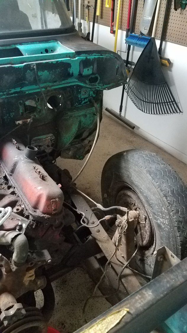

Everything is ready to go, to remove the engine. The cab will be first though. I think itll be easier.

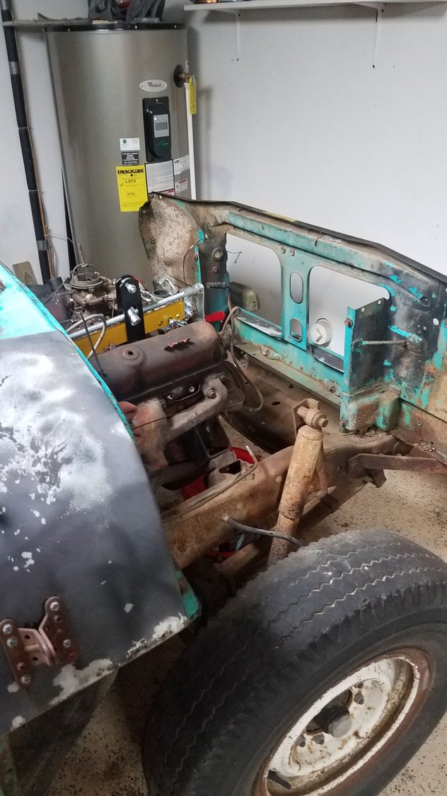

The radiator support is almost perfect, no stripped bolts or dents. Its dirty, but nice and original.

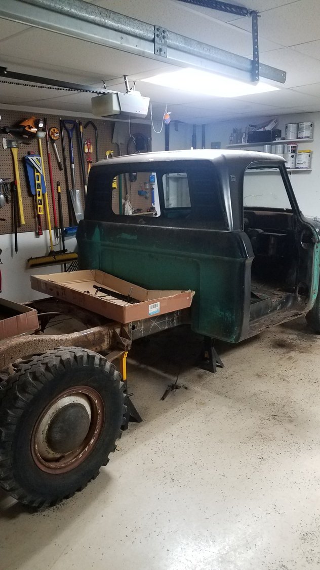

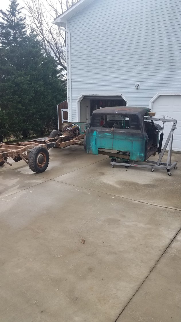

This is the last time this cab will be on this frame. Im going to keep the cab for repair parts. The green wagon on the frame (in the box, barely seen) will be how I move the cab around the yard. Ill also move the beds back and forth.

Made good progress today. I got the cab, engine and transmission off. I pressure washed the frame and got some of the crusty stuff off. Ill have to work on it some more. Im going to try and box the frame also. Im ready to cut and shorten the frame now. Hopefully Ill get that done in a week or two. Then I can start the IFS. Im going to try and get the triangulated 4 link while I am this far in. It would be a shame to let $600 stop me while Im in this deep. We will see.

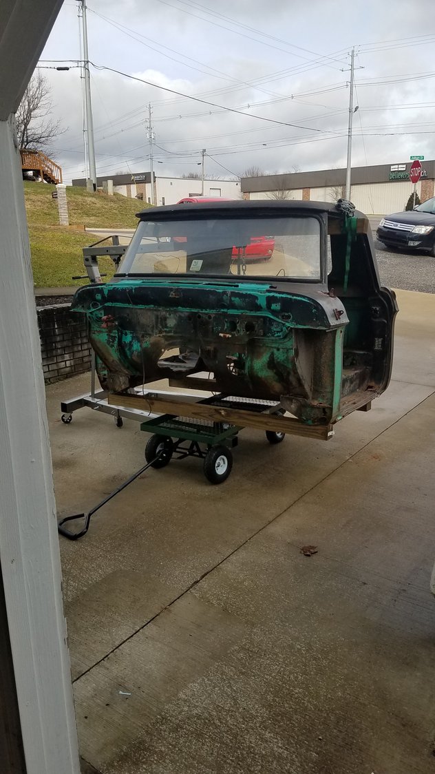

Cab comes off. It wasnt too bad.

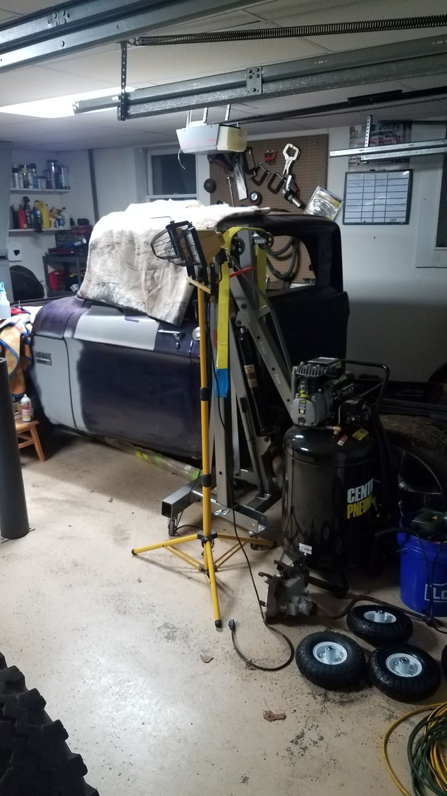

Without the engine hoist it would have been impossible. Money well spent.
I bought one of those garden carts just for this. It worked well. It is a bit wobbly.

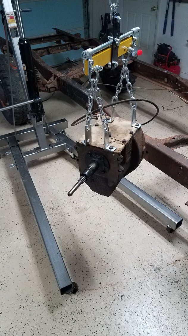

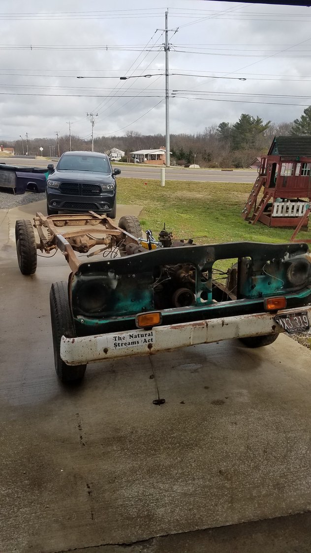

The NP435 comes out. It was heavy.

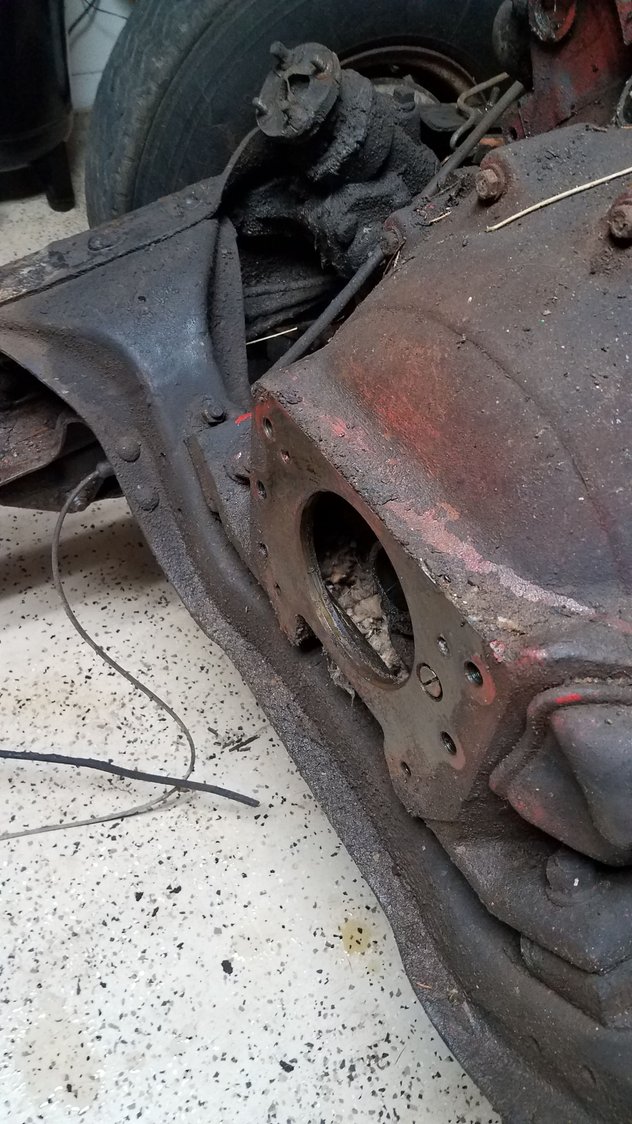

Bell housing had of a mouse nest. Im sure "it ran when it was parked", just like all of them. Hole in the radiator, empty gas tank, no clutch or brake fluid, all kinds of issues.
And the engine comes out. I have no idea what to do with it though. Im going to have to get rid of some of this stuff soon.
