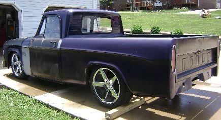

I am sure Ill have to get thinner spacers. It will help with the wheel arc issue and the fender clearance issue. Im already looking at the inner fender wells, to see if I can widen them or something to keep the tires from rubbing on them.

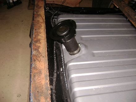

So today, I changed the oil, and filled the radiator, and got the filler neck installed. We will bleed the brakes this week, and Ill keep working on the wiring. I got the windshield wipers working...sort of. They came on, but didnt park. Then they just went wide open and wouldnt turn off. Im thinking the rheostat inside the switch failed, and is letting it go wide open. I dont need wipers to make it run, but Ill have to work on them. I also still need to get the radiator fan working. The instructions called for a paste for thread sealing, but I used tape. Ill get the paste and try again. If it doesnt work, Ill buy one of the GM switches which have 2 terminals. Thatll fix it.
So, its ready to start, again, but Im going to wait until I get the dash painted and the brakes bled before I start it.
And Im going to have to figure something out with the tailgate. Ill post pictures, but Im sure its a common problem. I had to finally drill the screws out. But the P.O did a horrible job on the body work back here. What I need is new bed end caps, and I plan on getting those later. But for now, I need a quick fix to get the tailgate on. Plus he cut the tabs at the top where the tailgate closes. I might just have to run a net for a tailgate for awhile.
Filler neck. Its temporary, but itll work.

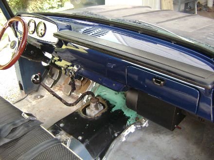

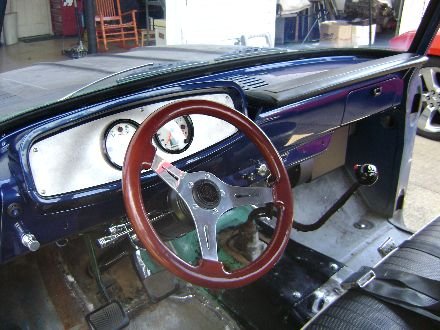

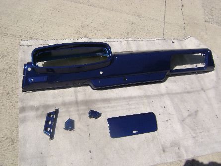

I spent the last 2 or 3 weeks working on the dash. I only spent 2 or 3 hours a day on it, just whenever someone was in the paint shop to watch me. But, I welded it, I filled it, I blocked it, and sanded it. Our paint shop supervisor sprayed the paint. And it is beautiful. The pictures dont do it justice. This was the dash with the radio hole in it.

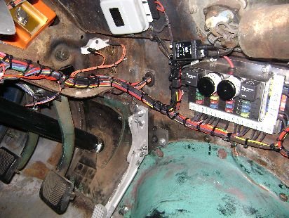

I also fixed most of the wiring. I got the cooling fan working, the windshield wipers (with the factory variable switch) working, and all the extra lights. Now I just need to work out the turn signals and 4-ways.

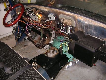

I took a long weekend in hopes of getting the truck moving under its own power. I want the brakes working first, then we can start it and let the clutch out. I also wanted the dash in because of all of the switches and stuff, so now I have it.
Wiring done, for the most part. Ive changed it a lot since it was installed, so if I get to do the 5.7 hemi later, Im redoing the wiring. It can look so much better than this.
Trans tunnel cover and all the switches installed and waiting. Just need the brakes sorted out before installing the dash.
The dash and all the parts. The pictures dont do it justice. It is nice.

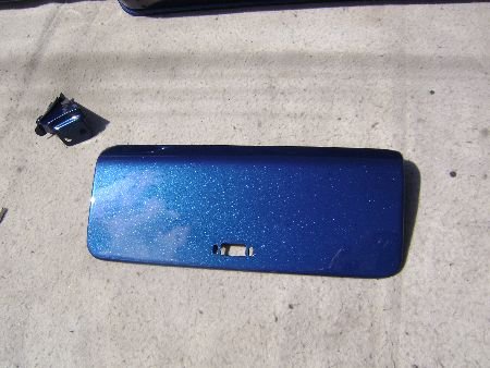

The glovebox door. That isnt a smear in the bottom corner, it the reflection of a cloud overhead. She is sharp.

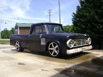

Worked my tail off today. On top of mowing the yard, I got the dash in, and put it all together, including a new glove box. I pushed it outside and started it up. Tried setting the idle and doing a few things, but the transmission is giving me a fit. I started a post on another forum about it, and hope to confirm my mistake. Basically there is no neutral, and I cant find 3rd or 4th. And when I put it in 1st or reverse, it just bogs the engine way down, and barely moves at all. Im thinking I got the shifter plate and fork in the wrong spot. Ill look into it.
As far as the fluids, no leaks in the fuel, or clutch. I have a tiny seepage at one of my intake manifold sensors, but I was expecting that. And then the brakes have a few leaks and the rod issue. I still havent dealt with them. I think I will next weekend when my wife can help.

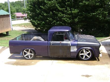

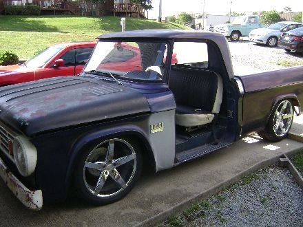

Im posting a few more pictures. I havent mounted the doors, because I need better access for the brake booster. And the steering wheel looks like garbage. I hate it. It HAS to go. Looks cheap and its way too small.
She needs a bath, but itll have to wait.

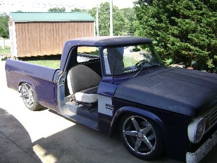

Here you can see the F100 patiently awaiting it turn. I hope to install the 5 speed over the winter.
All nice and shiny. Has a new glove box also.
Look past the steering wheel. Its going to go. I hate it. It looks cheap, and blocks the gauges.

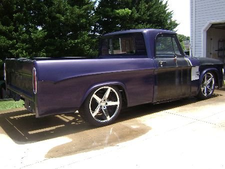

No pictures, but Im still working. I had to temporarily weld the tailgate on with some angle brackets. I hated doing that, but the bed end caps are toast, and there is easily a 1/2" of bondo back there, so I cant hurt it any more. And I didnt want to cut up the tailgate parts I do have to make a temporary fix. Ill replace the end caps when I have the bed rebuilt. Thats going to be expensive. But I also finished the wiring, I think. Everything is in and working, except the horn and I cant test the brake lights until my wife is here to help. I dont care about the horn for now, Im going to replace the steering wheel, and I can deal with it then. I still have to work on the brakes and the transmission issue, and bolt the bed and cab down. Its getting close though. Short of a setback, it might be ready in a week or two.
