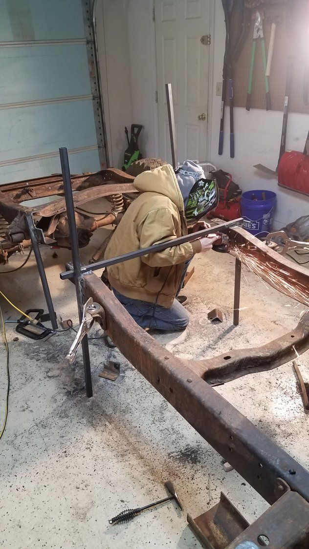

FINALLY, I got the frame cut and shortened. With the new welder, we were able to get it apart, and put back together in a day. Some of my cuts werent the best, so there is some fill work to do, and the welder didnt seem to like the thick frame on 115v. This week Im going to make a 240v outlet in the garage for the welder, and we can try and finish it up. I also got the wrong regulator for the tig portion of the machine, so Ill have to get that exchanged. Otherwise, Im happy.
I know it looks like Stephen (the guy in the photos, who will probably be my future son-in-law) is doing all the work, but we only have a few outlets in the garage, and didnt want to run too many tools at a time. I did some of the work though....
Its a little welder, but it worked pretty good. I have to get the right regulator for the argon, and we want to try it on 240v before we are finished. It did seem to struggle later in the day on 110v.
No turning back now. It wasnt as heavy as I figured. We braced it to make sure it wouldnt move on us.
Grind, cut and grind some more. We stunk the house up, and went through several cut wheels and grinder wheels.
Stephen welding it all up. We have some touch up to do still. We are going to wait till I get the 240v set up, and the tig just in case.

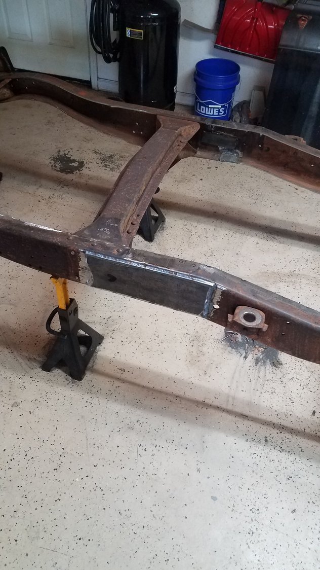

So we are filling in the splice, Stephen is making sure it is solid. Its was grind fill, grind fill. It took me 2 weeks to get the TIG side of the welder going, and today is the first time we got to use it. Man it works great. We were able to get some other stuff done as well.
The splice. It looks better now. We stopped to let it cool, and move to other things. We will probably finish tomorrow.

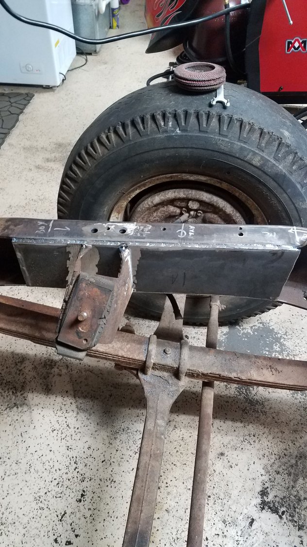

Here the frame was spliced, but it looks like it also had a patch at the cross member. The top wasnt even welded. Scary. We drove this truck. He knew it was for my son.
The other side is just as bad. Not completely welded, and where it was welded, it was done poorly. It was at least bolted with a plate, but even that was sketchy. Unacceptable.
One of the cab mounts. I made the joke I could pull it off by hand, and I did. Im so mad this guy sold this truck to my son. Im embarrassed I didnt catch all the problems up front. And Im glad I made the call to replace the frame.

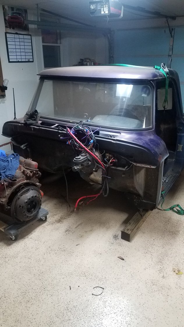

The cab, engine, transmission and tires are all snuggled in the garage. Ill clean and rearrange tomorrow between church, and start getting things sorted. Then Ill start seeing what atrocities he performed on the cab, and try some damage control.
