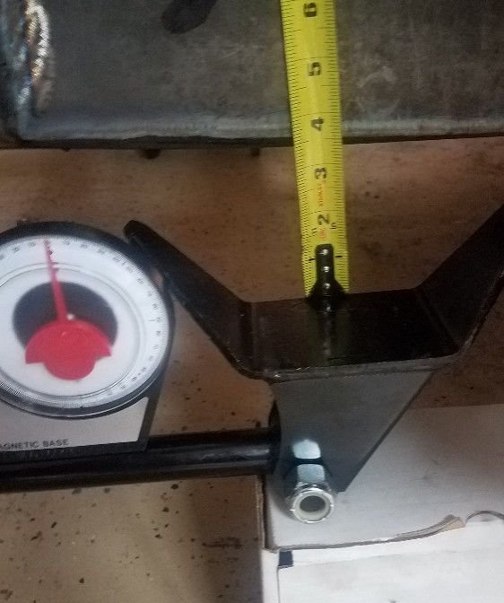

Isn't caster already adjustable simply by turning the rod ends on the control arm in/out?? Or is that not fine enough control?
Very little, but that would work. It would put the rod ends in a bind if its too much though. Ive been going like a crazy man all day looking into this. It appears to be okay, for a cruiser at +4 degrees. If I decide to get bold and start doing some mild racing, I could mill the upper shock mount, where the a-arm bolts through, and put shims in between the bushings and the mount. That would work perfect, but I dont plan on racing it at all. These trucks are hard to get parts for.

I wouldn't worry about it overmuch then. Also, I think you would have to REALLY adjust the rod-ends to put 'em in a bind. They have a fair amount of angular travel, do they not? (I mean, all you are going to want is a degree or so, either way...... a half turn of the rod end may be too much. )

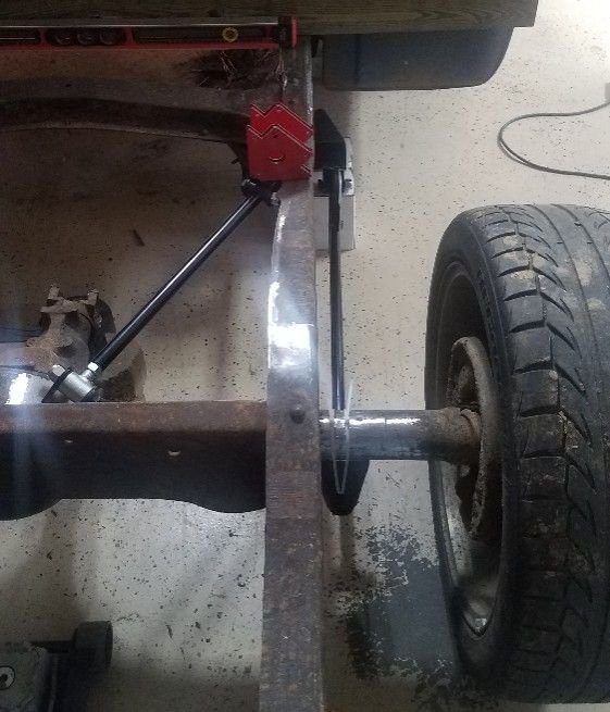

Did some more today, but not much. Trying to figure out those upper mounts is just a pain. There is no way to really get it the way I want it. I think Im close, but man, this has been the worst part of the build so far. The problem is, you have to get critical measurements, but to get them, you have to cut the supports first. I tried making cardboard templates, and got close. I guess its close enough, Im going to go with it. Anyway, I was also playing around with the rear suspension and set it a little, plus I installed the wheel spacers.
There is a gap, and I hate that. But the critical dimension is right, so I guess Ill go with it
With the spacer in, this is where the wheels will sit. I think its still too high, but Im sure I can lower it.
I have over 5 inches of clearance, with 7 inch wheels. This is actually one of the front shocks.
With the lower bar level, Im going to have to build a support. It sticks down quite a bit.
I will wind up building a cross member here for the upper bars, and another for the shock mounts.

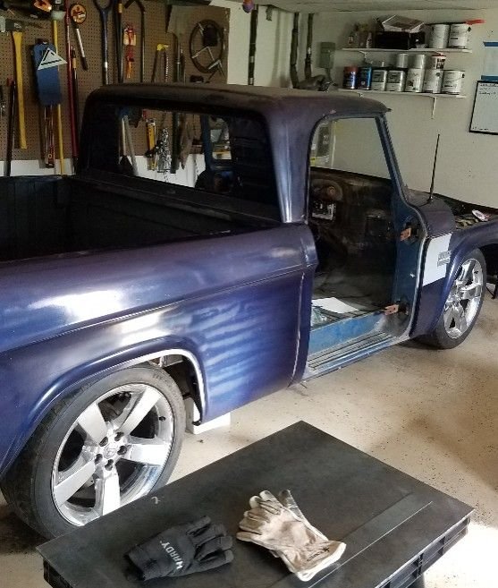

So we temporarily set the bed on, and the hood to see what we have. It looks okay, but not like I wanted, so we are going to have to lower it another 1-1/2" to 2". This means a slew of problems, but it fixes a few also. The motor mounts will have to come out, but they look like they might interfere with the steering rack. We can fabricate some more later as needed. This will also cause the bellhousing cross member to be too low, so we are going to modify it also. And the rear suspension will have to lower also, causing us to c-notch the frame, and maybe even raise the bed floor by a few inches, but the lower 4-link control arm is about 4 inches below the frame, so we will cut that distance in half when we get ready to fabricate the mount for it, and the bed floor is rotten anyway, so if we cut and raise it, it will get into good metal. We also still have 3 or 4 cross members to fabricate and install in the rear of the frame, some bed supports and shock mounts too.
So tons of work to get done. But on a positive note, a local friend scored me an original light duty bumper, for $100. Its a little twisted, and has some rust and a few extra holes, but its in as good a shape as the front. We will add a tow hitch under the bumper that will be tied to the frame. Should be nice.
Overall side view. Better than original, but not as good as expected. It needs to come down.
Another angle, also showing the horrible body work Ill get to someday.
