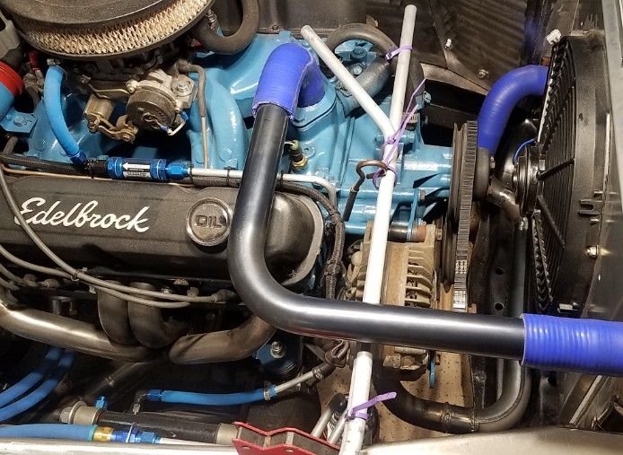

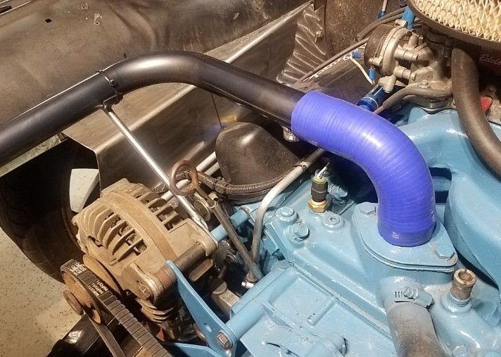

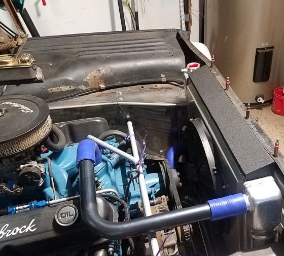

I went to re-weld a few holes in the radiator hoses, and they blew out, so I made another one. Plus I welded a bung in the upper for the fan temp sensor. Its as close to the thermostat as I could get, without buying an expensive billet water neck, which wouldnt look right. Also, I laid the heater lines in place. They will get flared and AN fittings on the firewall side. Should look pretty good I think. When we change engines later (I hope), we will just rebuild the lines from the firewall.

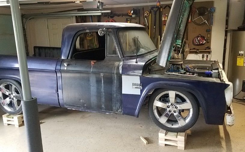

I also got the tire stands made. I hope to get more done later and tomorrow. I decided to post a few pictures, because I havent in awhile. But google is being a little jerk, so I have had to re-learn how to post pictures. So, I hope this works.
Truck getting weighed. I leveled the wheels not on the scales and did a front and back measurement.
On the new stands. The hood barely misses the ceiling when open.

A better shot of the radiator closeout I made. Not perfect, but Itll work.

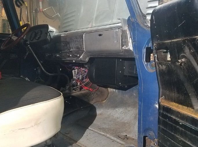

I know the wiring is a mess right now. I installed it before I realized we had to swap frames. It really is bugging me. Plus I have some issues to sort out, like blinkers and the horn, and a bunch of things to add- wipers, heater, interior lights, mirror blinkers, courtesy lights, electric fan, maybe a few more things by the time I get there. Ignore the wiring. Im trying really hard not to yank it all out and start over. I do wiring for a living, and this drives me crazy.
Heater is in. Ignore the wiring. Ill clean it up. Im trying to avoid starting over with it.

Old May 8, 2021 | 07:57 PM
  #157
Posts: 87,398
Likes: 4,213
5 bucks says you decide to yank all the wiring, and start over. Everything else looks pristine, and squared away. The wiring is going to keep you up at night.

Ive been working on coolant hoses. I have tried two or three times to make them air tight. Im just not good enough with a welder to make really nice beads, so I grind them, and they leak. Im going to check them one more time, and if they leak Im going to have to do something else. I made a little bracket to support the metal hose, but Im not sure if I like it or if it will work. Its all part of the process, I guess.

Little bracket. It might not stay.

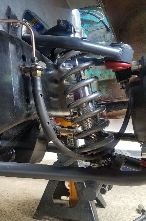

So I ran into a bit of a major problem. I got the shocks in, and went to mount them, after giving up on trying to start the truck. There are issues in the front and rear.
The front- the springs are too big. I think I mentioned these frames are too wide for this crossmember. The junk chinese shocks they send with the kit almost hit the frame. The QA1s do hit it. Plus its practically impossible to get the shock in place. Ill post pictures, but it seems the frame sticks out too much to allow the shock and spring to clear it. I see 3 solutions: (1) c-notch the frame. I see this as a no-go. I dont like this idea at all. (2) move the lower shock mount. This probably wouldnt help much, especially as the suspension compresses and the spring comes inboard. Plus the shock would lean more, making it less effective and it would change the suspension geometry. I say this wont work either. (3). Extend the upper mounts. This is probably what Ill do. Currently the shock is leaned in at about 8 degrees, and according to QA1, anything under 10 is nominal. By moving the upper mount out, itll make the shock stand more upright. Plus with this being where the issue is, a half inch move gains me a half inch. The biggest problem I see with this is the shock is close to impossible to install now. Making the upper longer will make it worse, so Ill probably have to change the lower A-arm a bit also. Once you see the pictures, it should make sense. They have bars in them to allow for airbags.

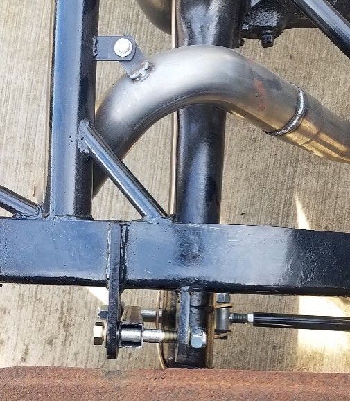

The rear- Sort of the same issue. I dont know what I was thinking when I welded the upper tabs on, but the shock will hit the rearend too. The shock has to be spaced away from the axle tube. The shock needs to sit almost exactly where the aft tab is, so Ill have to get 4 more tabs and move them. It sucks but it isnt a huge deal. The good news is, this will allow me to get those tabs lower, which will eliminate the problem of the bed interfering. I expected this might be an issue.

Spring hits the frame, and the lower mount is still about an inch away.
The lower A-arm. These two bars wont allow the shock to go through. If I move the upper outboard, itll be impossible.
The upper shock mount needs to be almost exactly where the tab on the left needs to be. Im an idiot. I didnt account for the spacers needed to clear the axle tubes.
