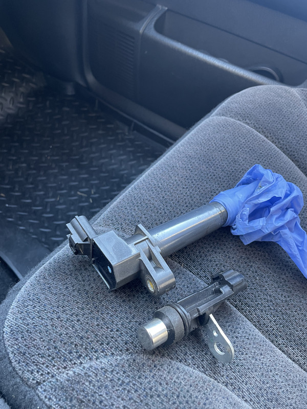

I've kept these two items in the truck for years.... thought the sensor was for the crankshaft but when I looked up the camshaft sensors (thanks to you), they looked pretty similar. Can you tell which one this is? Got em both from the junkyard.
PS: When I held the flat part of a knife to the magnet tip, it wasn't strong enough to support it's own weight.
You're right, you've got a Crankshaft Positioning Sensor and a Coil with a glove
On the Camshaft sensor the magnet sits deeper in the housing.

Good to know. I kept it in a glove to keep the dirt out. I priced Mopar sensors and the crank is pretty pricey... around $80. The camshaft sensor is around $40. Don't think I'd go aftermarket with these. The junkyard one in my pic is probably aftermarket. Kept it around for emergency.

Thx. I only saw the typos after you mentioned them. LOL.
they are so cheap, just buy new ones .. i bought standard motor products sensors and they seem ok, no ce light last time i looked.
use a regular razor blade for the mag test
