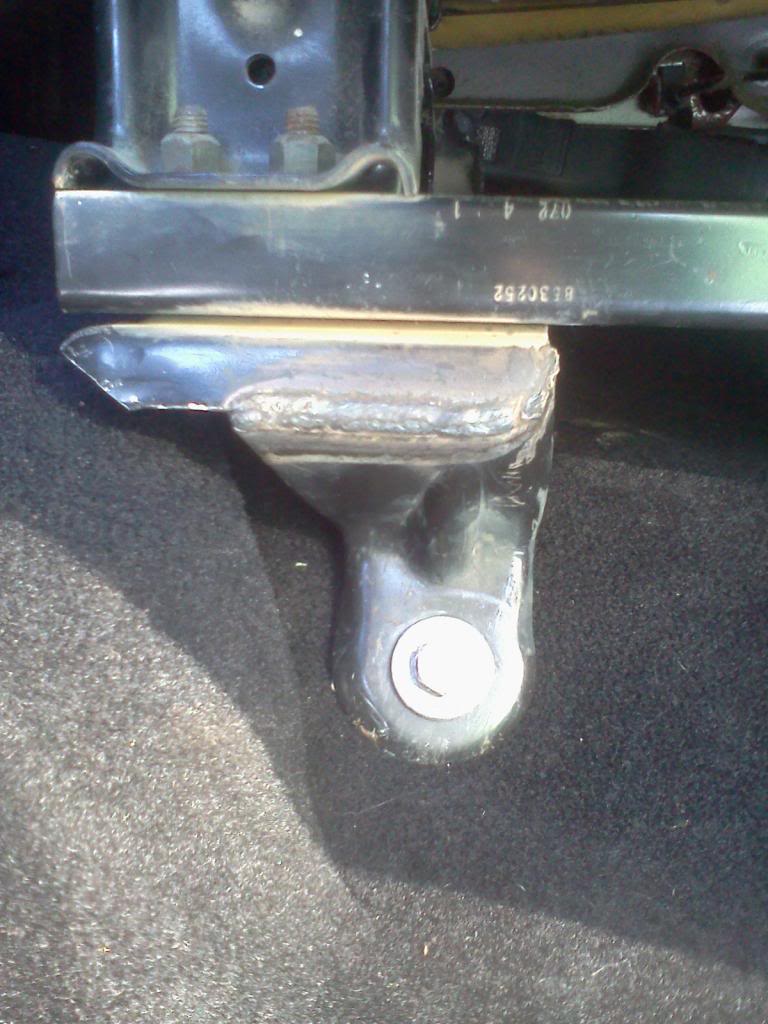

Default Pic from 3rd Gen seats in 1st gen.
[QUOTE=Scooter78;2988508]There are 4 mounting feet on the front and 4 more in the back. I had to cut the 2 center-rear mounts almost flush with the rest of the frame. They are currently acting as feet in the back and are not yet bolted down. After welding a basic piece of flatstock with a hole in it to them, they will be secured. I also cut the 2 outer rear mounts, and then rewelded them to the side of the frame to match the shape of my floor. I used the cut off center feet from the back to extend my front feet far enough to reach the floor. The outer four corners are all bolted down, and it feels very solid with myself, my wife and my son. The center mounts are probably overkill, but I will do them anyway. Ill hook you up with some pictures in the morning. Its getting dark and snowing now.
QUOTE]
Sorry I took so long for the picture I promised. This is the rear, passenger mount. It used to face rearword, but I cut it off with my sawzall, beveled the edges and rewelded it on the side to match the shape of the floor. The front mount isnt very exciting. Its just the original mount that is extended about an inch and a half. Drivers side is just a mirror image of what you are looking at now.

Thats badass man! Good work!!
