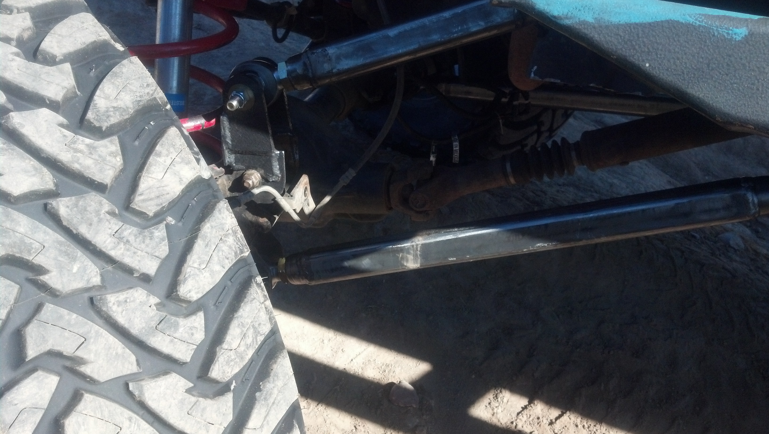

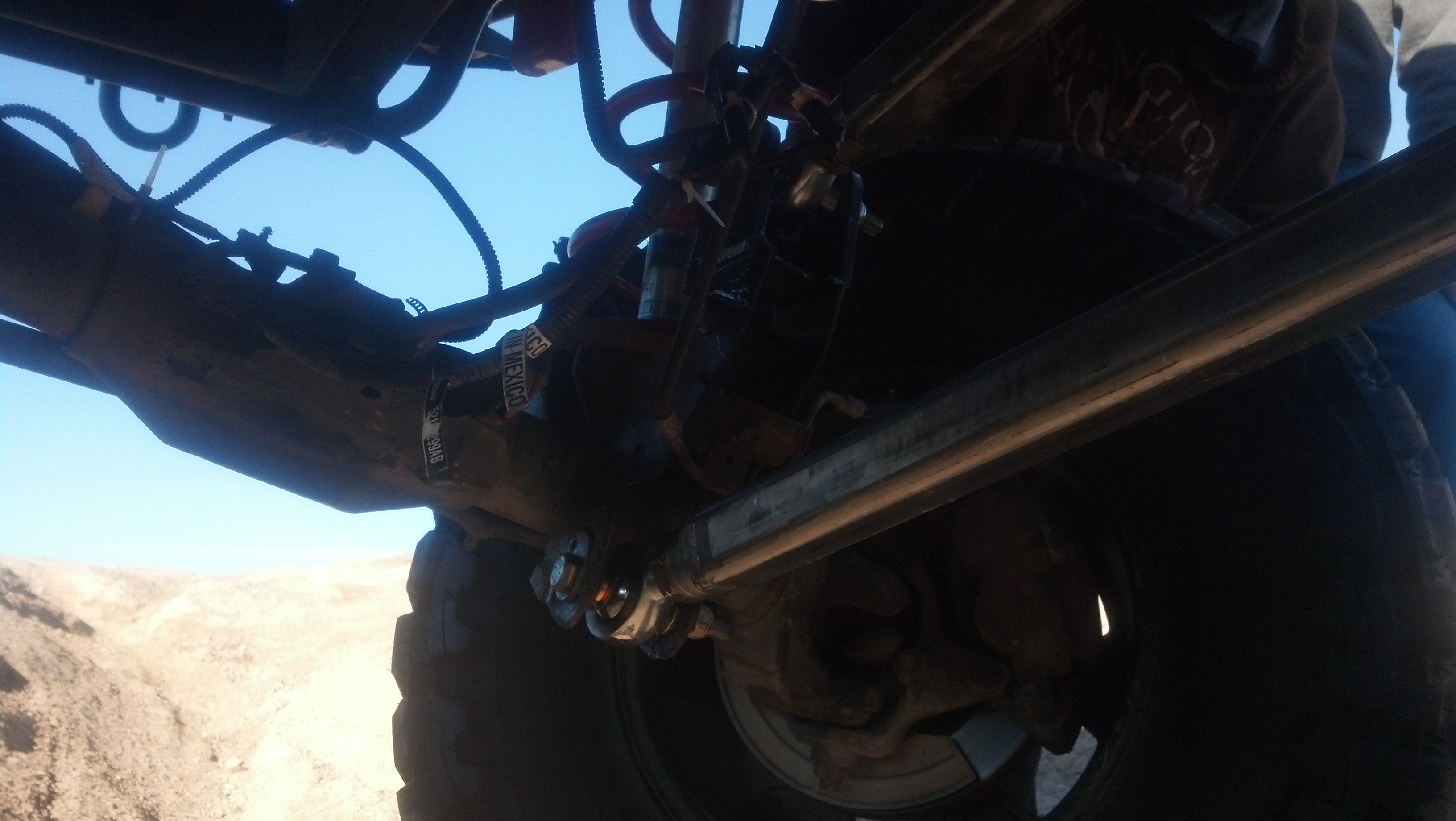

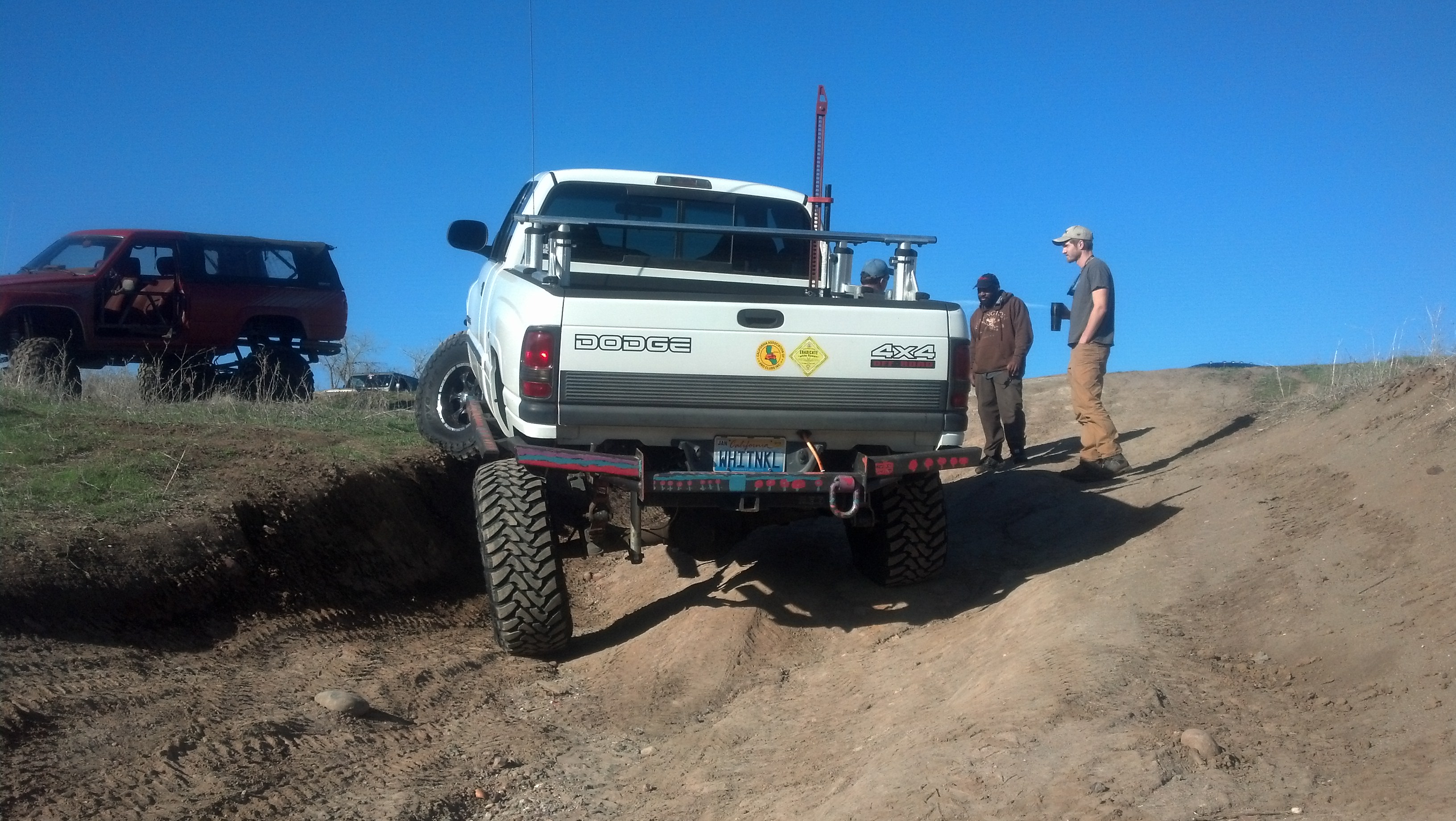

Went and flexed it to check clearances.
Results:
1. I need to put my front brake lines on
2. Need limit straps if I droop it like this
I am very pleased.
brake line
Spring is free!
Other direction
Pinion angle still pretty decent as I expected it to be worse
Very close contact - .5" clearance still
Stuffed just enough

That's the sort of articulation an ORV should have.
Not using the front brake line as droop strap could be a good idea
