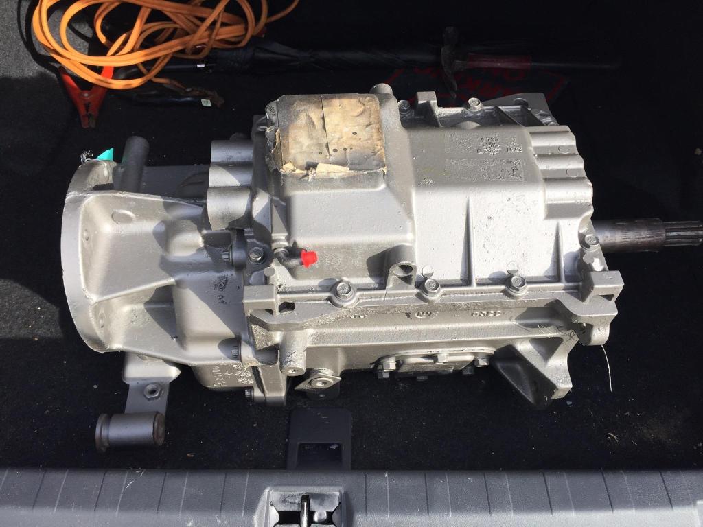

I swapped out my 46re(200k+ miles on it. RIP) it was starting to act up. for a low miles, remanufactured NV4500.

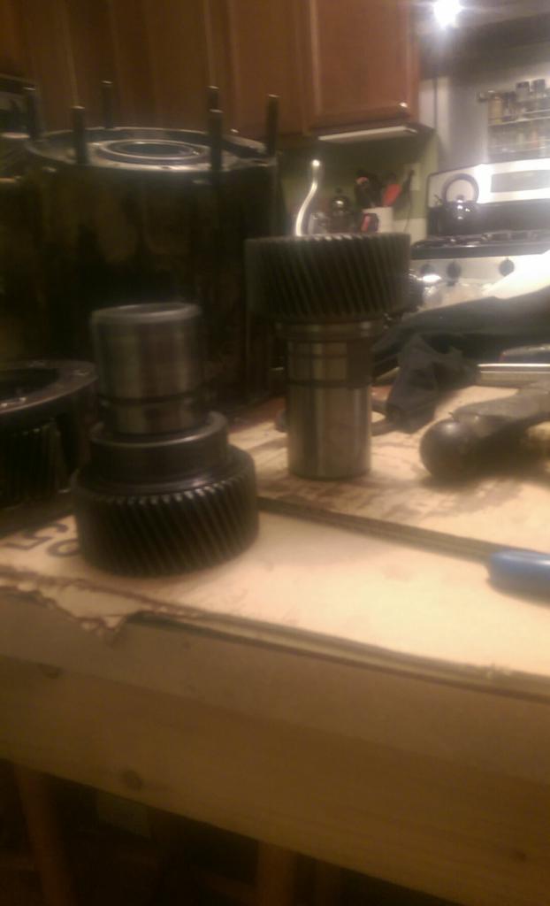

My NV4500 came out of a 2001 2500 5.9 V8 4x4. prior to mid 2000, the output on the trans was 23, same as the auto, but then they switched to 29 spline output. Which is what the diesel/v10 had been all along.
29 spline is the taller one

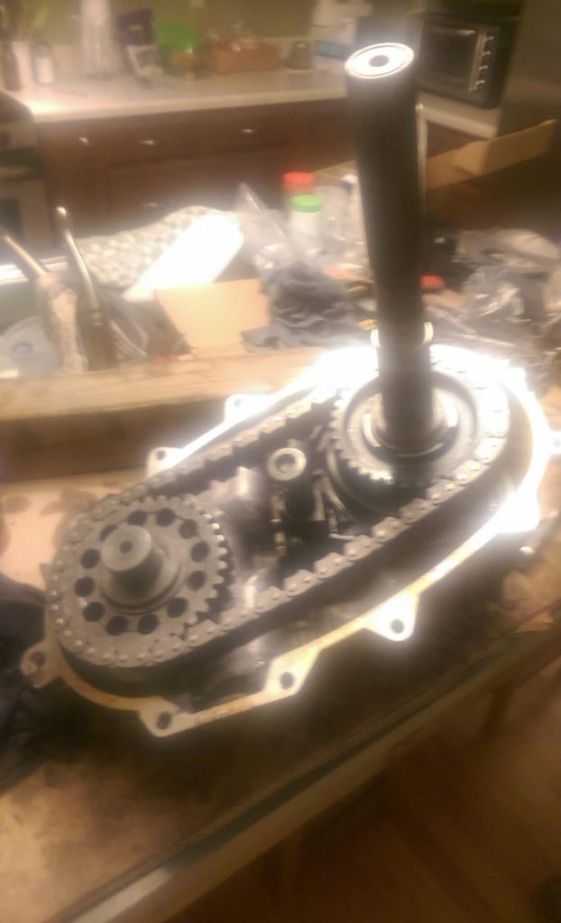

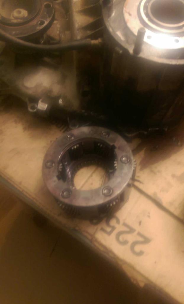

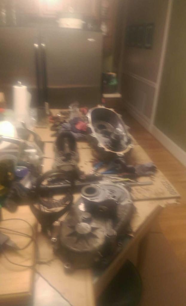

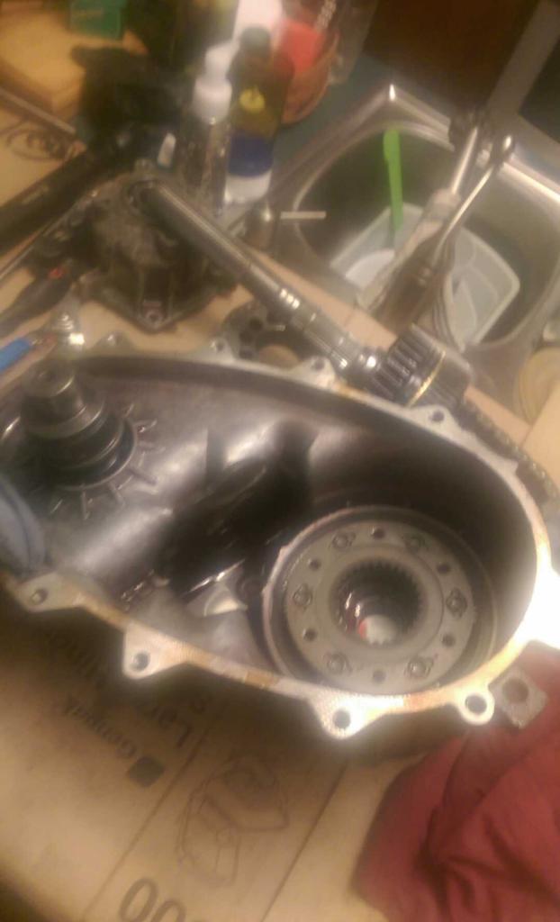

Because of this i had to swap my input shaft on my NP241DLD. From 23 to 29. This is relatively simple.

Planetaries the input goes into. Np231 has 3 241 has six (what I have)

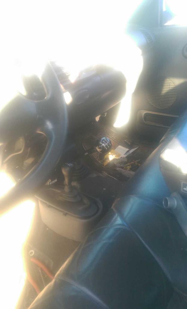

You got one of those cool shift ***** or T bar? I was a fan of the old round ****, (when I had a 4 in the floor).
OK, Shift Tower, (not what we called it). K.
Black with white, or white ball with black.........that's what I would want.........thanks for pic.
tincan
I actually have a core-shifters hurst short throw in it. Because the oem tower was 700 bucks! And finding a good used one is a like finding a needle in a hay stack. So far I am loving it. It shifts smooth and firm. Has a short throw for a truck trans. It cost 220 shipped to my door. I will post pics.
Lots of old trans didn't have a shift tower. The stick just threaded directly into the trans or screwed in. Whatever. Haha
